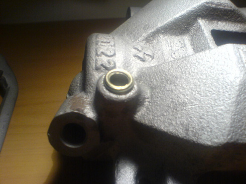

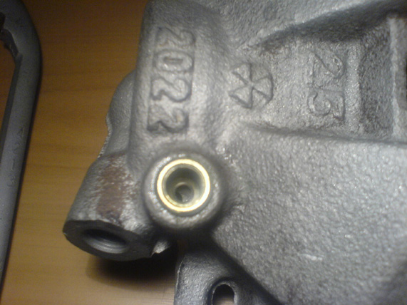

Rang a couple of places and got a price to fix the brakes - about $30 to "tap" a new thread in there. About $40-$50 to to a heli-coil and valve, and about $60-$70 to do a bleeder repair kit (apparently they clean it all out, put some kind of nut in there or something that the bleeder valve then screws into). So it'll cost maximum $70 to get that done, which although I'm not toooo pleased about, its cheaper than a new caliper. Also decided to get them to strip them down and give them a clean ready for a rebuild kit to go through them. Stripping will be $20 each, rebuild kit $24 each. So i'll be looking at about $150-$160 but will effectively have a nice fresh pair of JDM calipers. Have had to spend alot more than i expected (was expecting to be able to just machine the rotors i got by they were already @ minimum thickness - 17mm), but will basically have a new setup on the front so can't complain too much i guess! Thanks again to those who suggested solutions! :P

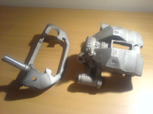

yeah, the way I'm looking at it is its really only costing me $70 more (to get the bleeder valve fixed) to do it, and it has forced me to get the brakes reconditioned which is a good thing and money well spent like you said. WIll get my mate to actually put the rebuild kit through it (he's a mech), so should be good and will look nice and new once its done. Will get some pics up showing what they've done when i get them back on wednesday!
Got the brakes back from the place today:
Cost $160 for 2x caliper rebuild kits, removing and replacing broken valve with a "repair kit", and disassembly and stripping of the calipers. So will get some paint on them, put the new kits through them and get them back together and should be set to go (SHOULD BE!!!).
