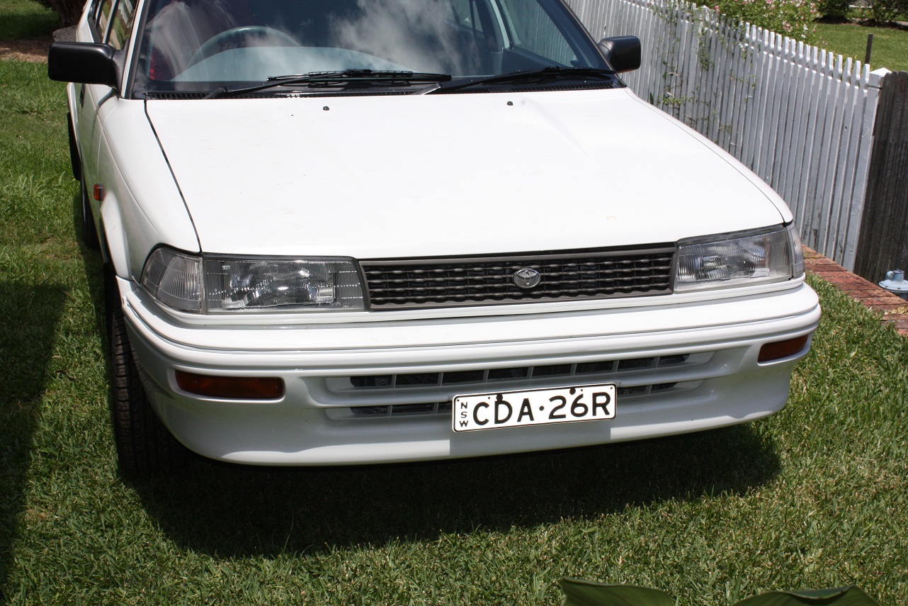

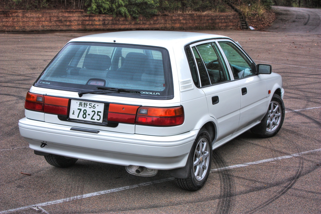

  3. Well my Christmas presents to my self arrived in the mail today and It felt like it was Christmas day all over again unwrapping this thing! It has taken some time to search and find one of these available. The rare AE92 JDM C grille (ruby red) + a AE101 C grille Took some before a after shots and love how different it looks. AE92 AE102

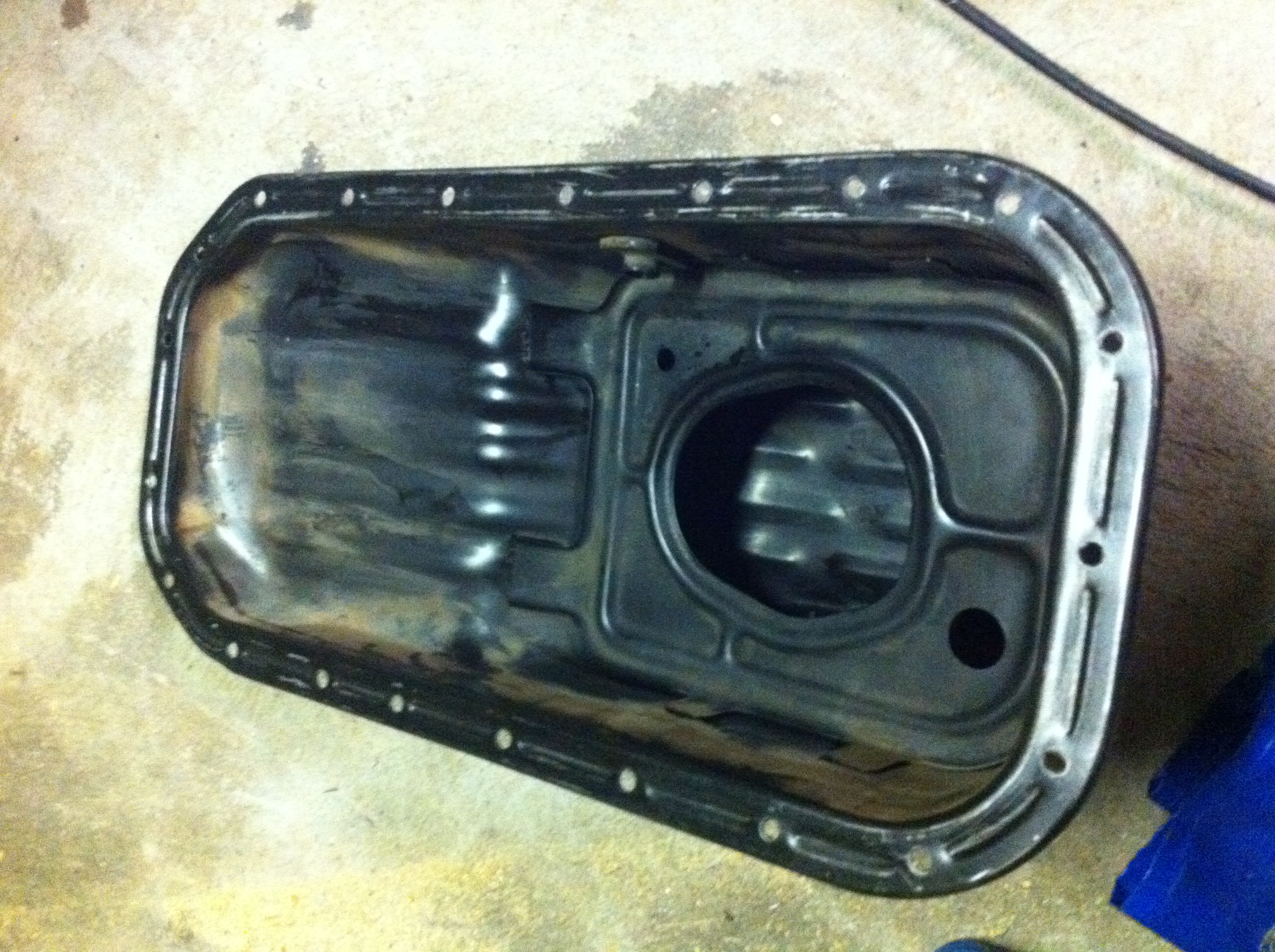

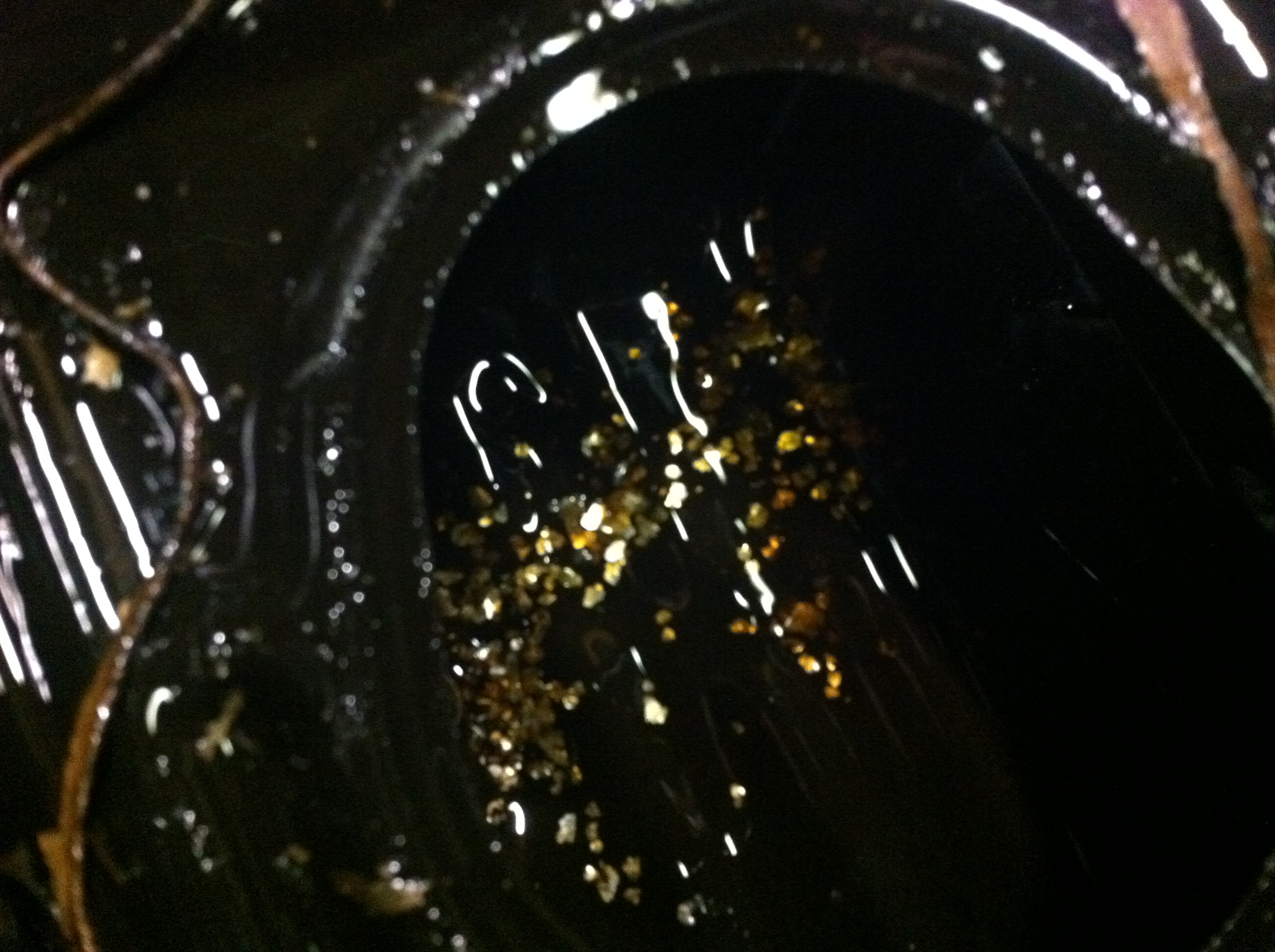

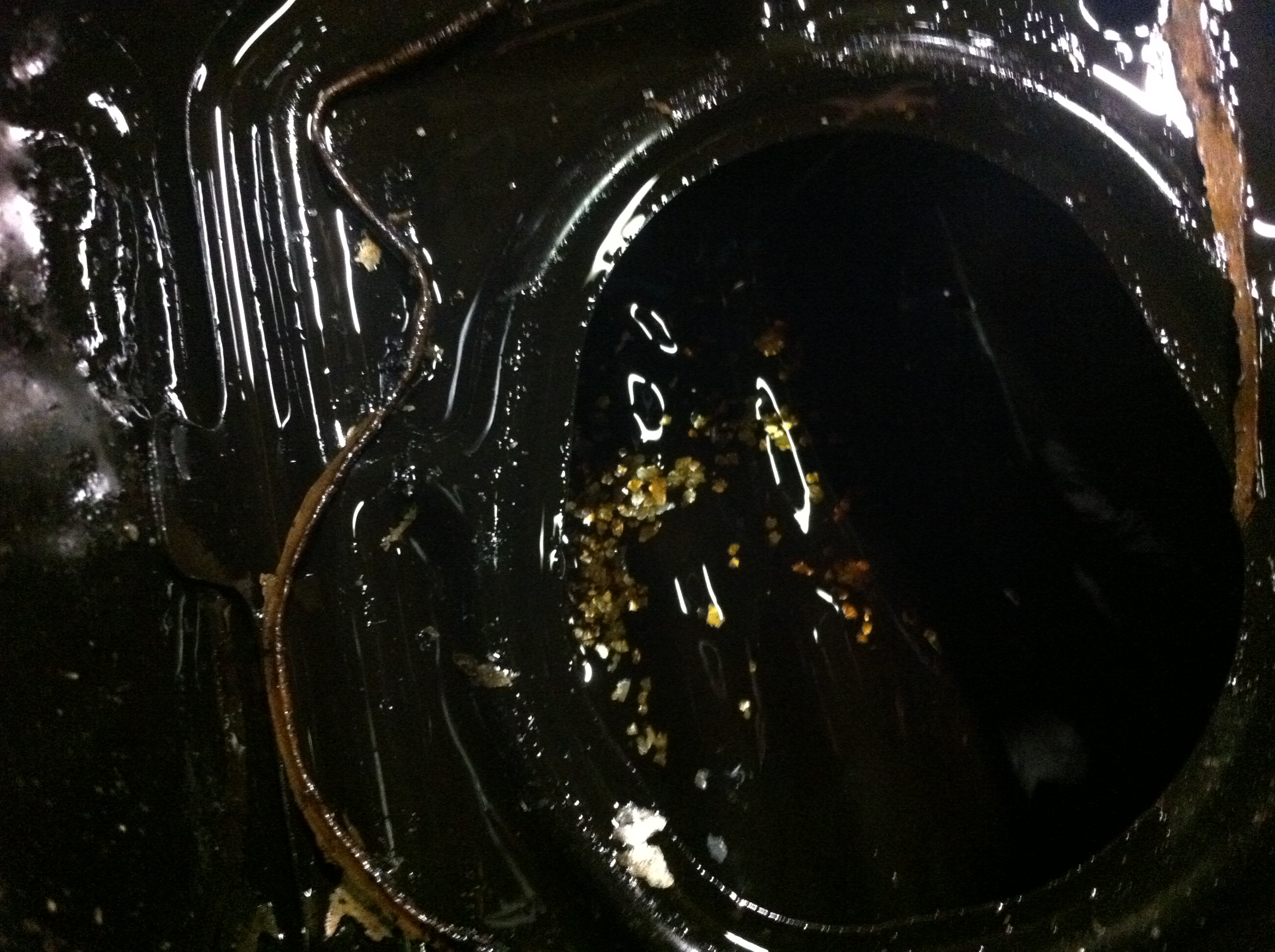

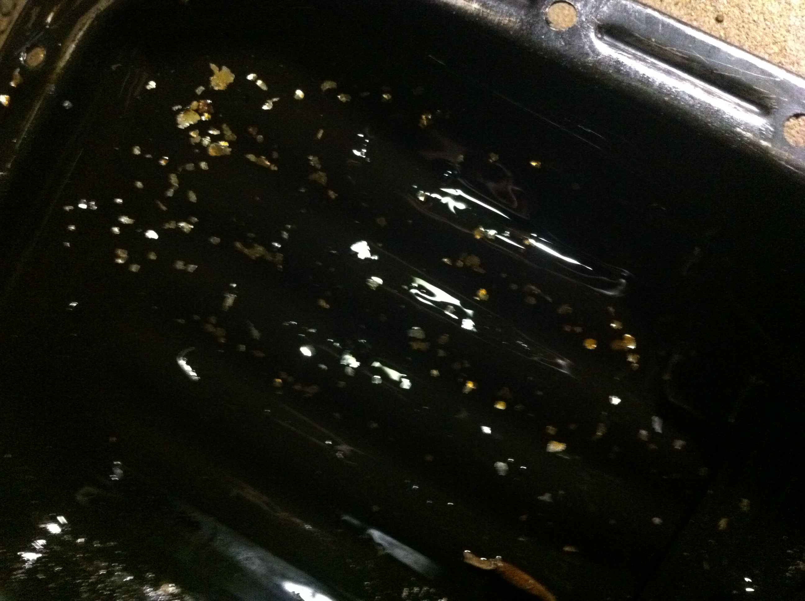

  8. So here is the pictures from when the sump pan was dropped. As you can see all the metal shavings from the bearings. All cleaned up and getting ready to put back together Sump pan cleaned up aswell Car has been running around now for a week on the road and it runs beautifully :)
  9. thanks :y: , it is a awesome little car and feels really good on the road. Ah yeah theres is always something that has to go wrong

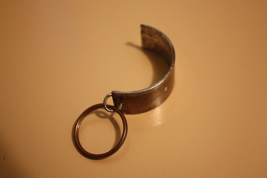

  10. Thanks Chris for the comment. Update with the rolla is back on the road and purring like a kitten As I don't have the money for a 20v conversion I had to fix the corolla. The picture above showed the sump catch with a little metal in it, that was nothing compared to what was in the bottom of the sump pan. It had looked like someone had thrown a hand full of confetti in there which was all the metal shavings from the inner lining of the bearing. In the end it was the big end bearing 1 & 2, 2 being the worse. Picture soon once I get them of my mates phone.

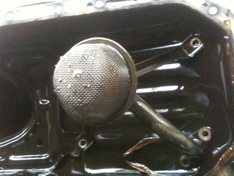

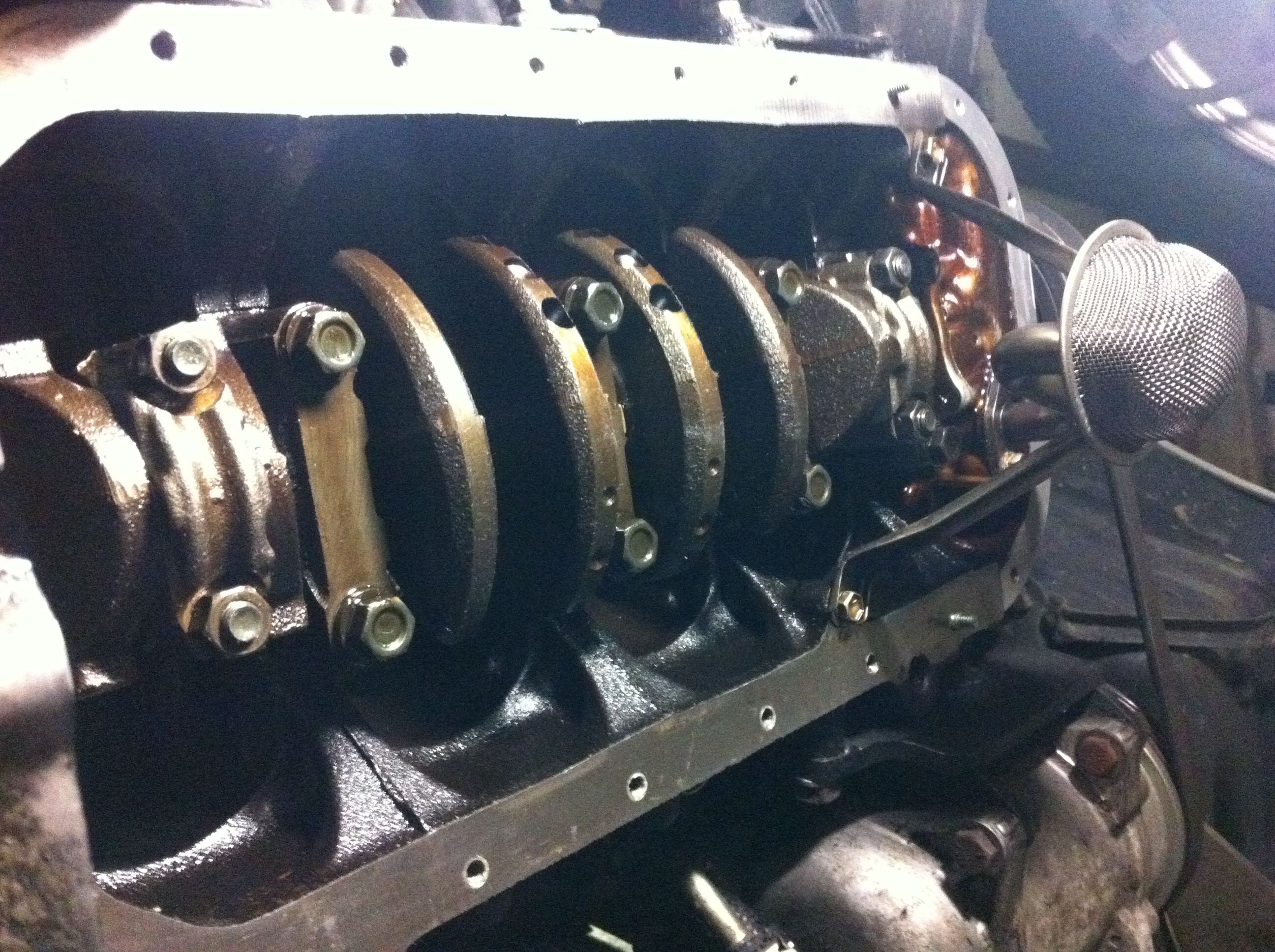

  14. More work has been happening on the rolla as there has been a problem with the engine. Started making a tapping / rattle noise on start up and slowly has increased when driving it on hard acceleration. Thought it could of been the tappets, on further investigating the noise in was lower down and was pretty sure it was the big end bearing. Got the car up on stands and dropped the sump pan out of it and found the sump catch full of bits of the bearing And whats left of the big end bearing. Decided to make it into a keyring for a souvenir. Left the car for now, need to check the conrods if there is any damage to them and then source some parts for it.

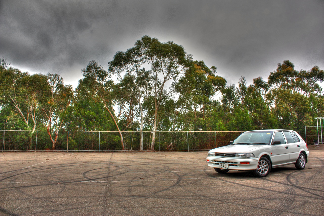

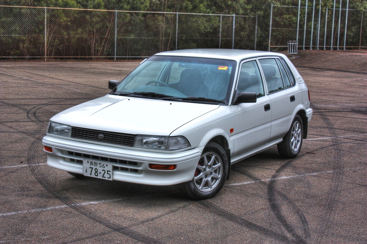

  15. Got the car registered yesterday and just finished up on a little things of the car. Absolutely love driving this rolla, it like a little toy and I don't want to give it to my girlfriend :( Took it to the local park today and took a few photos to show you guys the finished product! Hope you guys like the finished product. There is still a few things on the list to do, tinting and lower it a little.

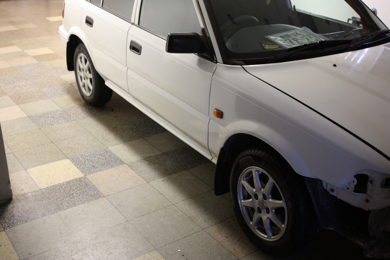

  22. Just finishing up the corolla getting it ready for blue slip next week some time. Got the quarters and mud guards on and put the side grilles on. Had to remove pretty much all the plastic from the rear just to put these grilles on because they screw is from behind. Went to carpet court and got some off cut underlay and re-underlay the rear boot carpet Some pictures of the front windscreen before the new one gets put in. Well the guy came and removed the front windscreen and we found rust underneath it. So he left it and I told him to come back tomorrow and it will be ready and prepped for him to put it in. Got to work and masked off the windscreen and started to grind off the the rust and uneven areas. Then used the wire brush on the pitted area that couldn't be reached with the angle grinder. After all that it revealed 4 small holes from were the rust has eaten through. So I rust treated the the hole windscreen area. They were to small for me to get the welder in there and I don't have the correct welder for the job so decided to just bog up the holes because they where small holes. Sanded off the bog and white primed the seal area.
