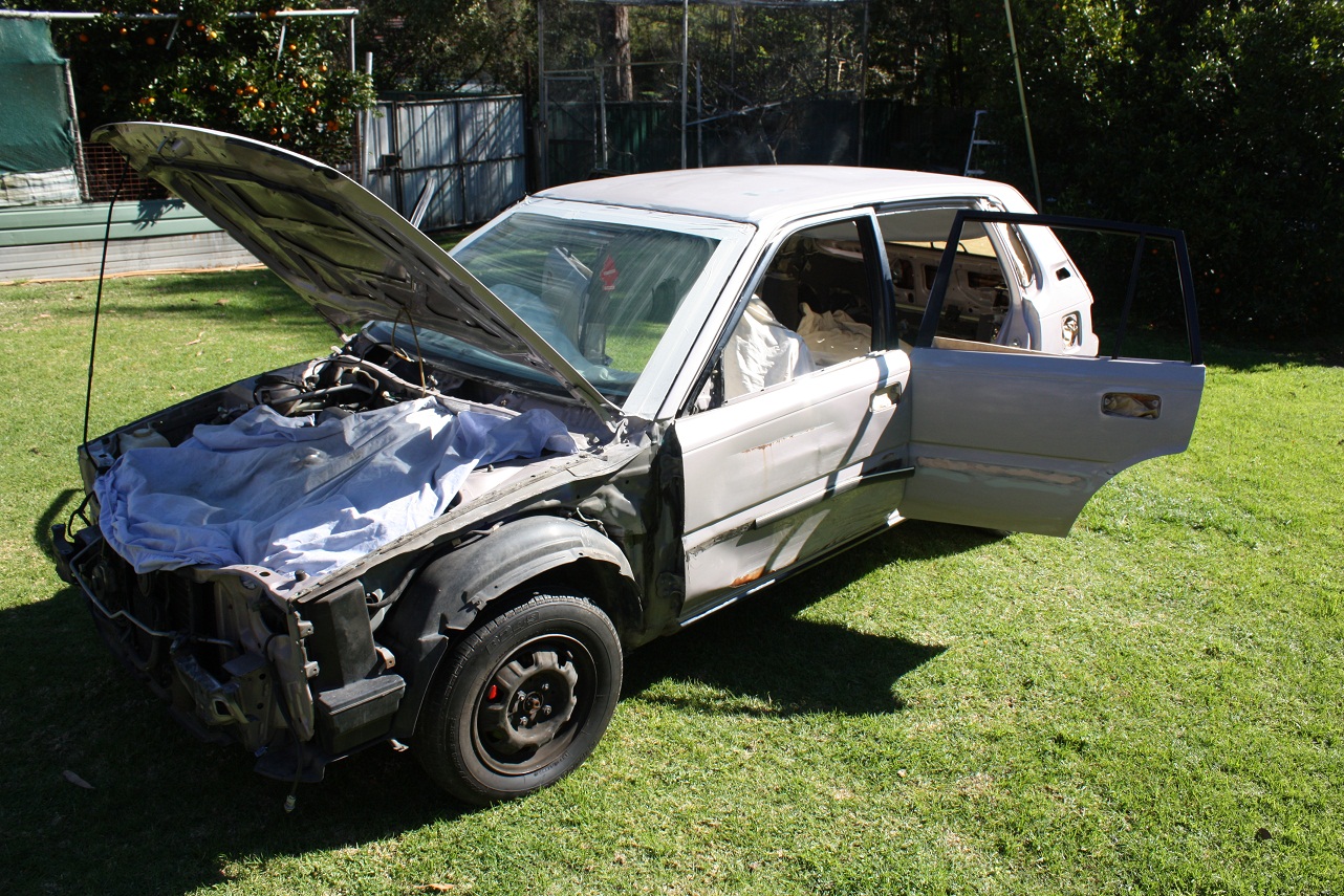

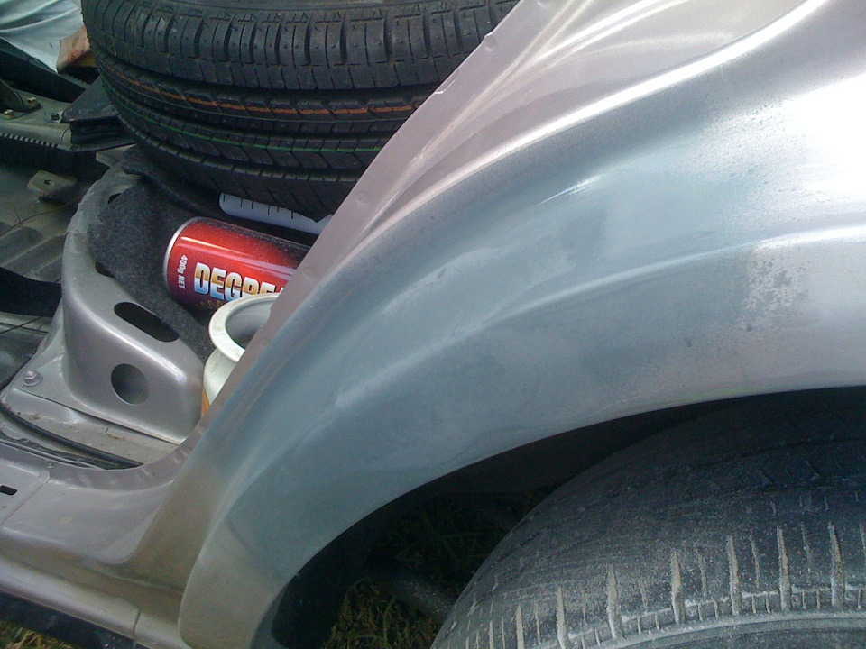

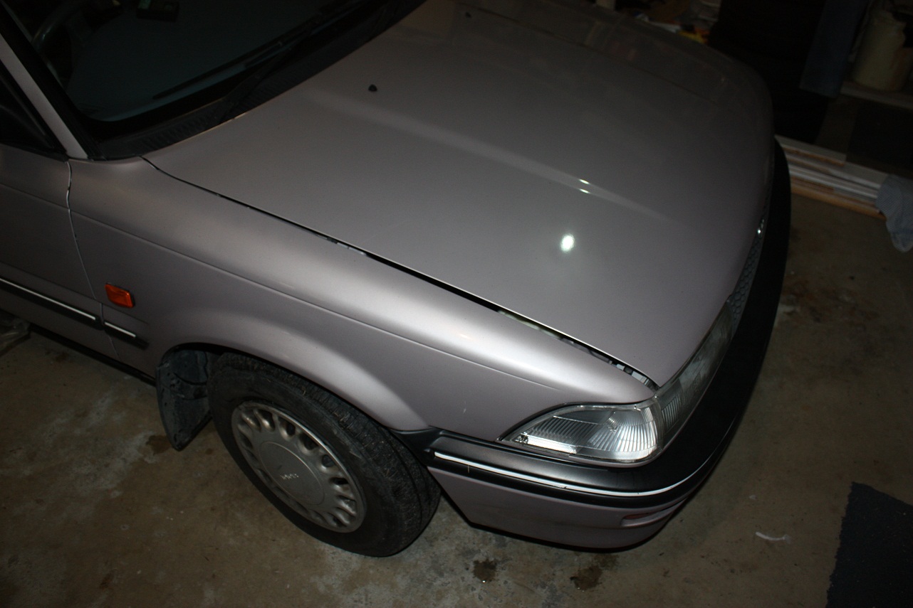

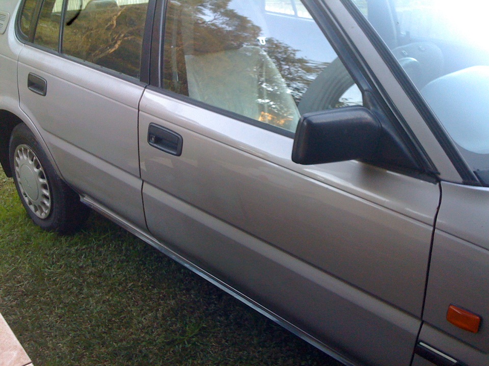

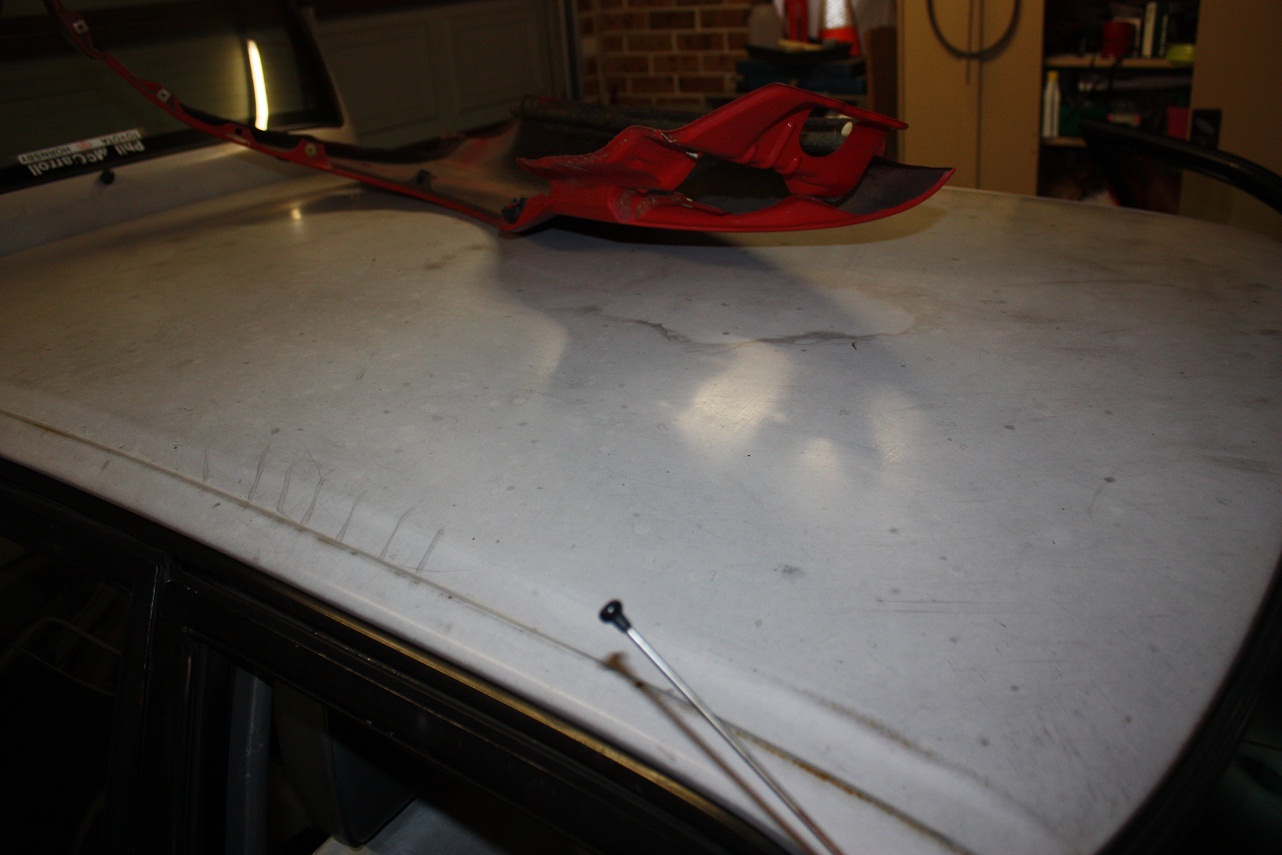

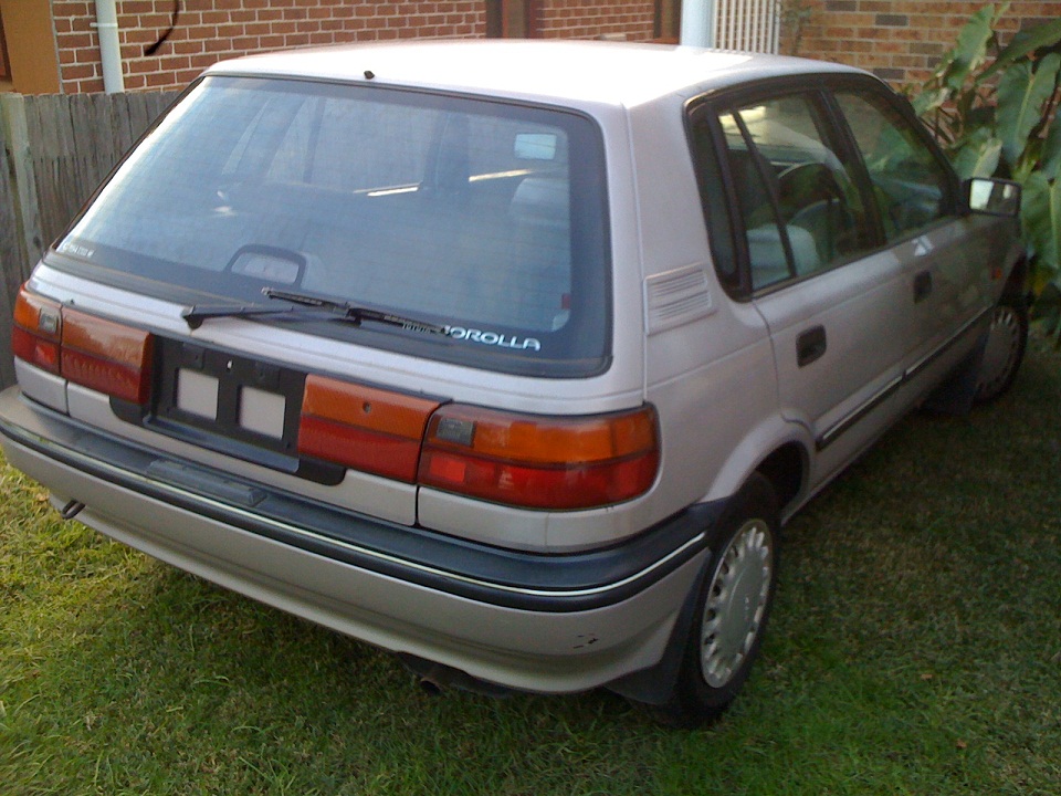

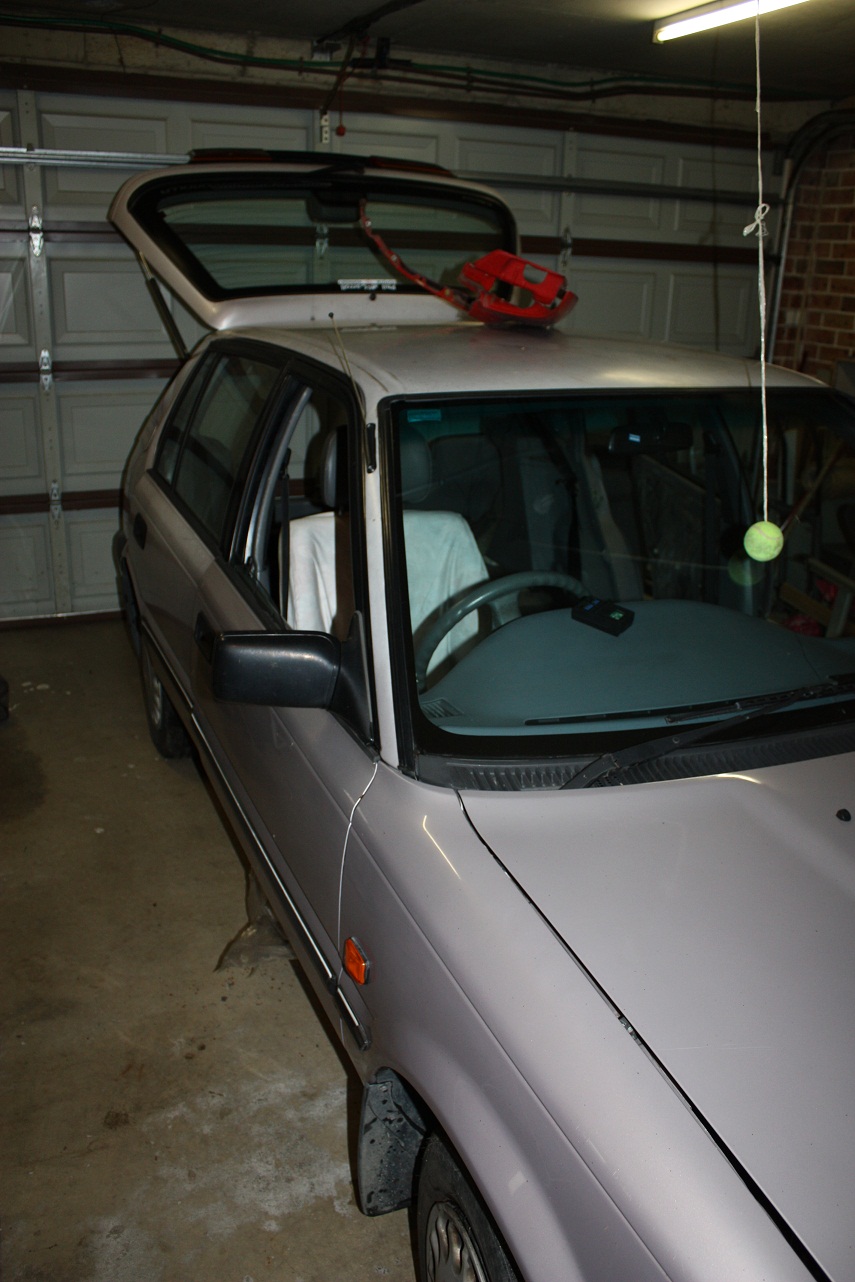

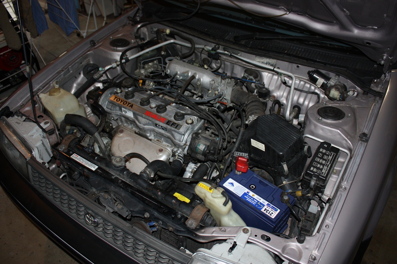

This is what I had to work with. I cleaned the engine bay because it was greasy and grimy. Went to town with the degreaser and got that thing looking a lot better. The original owner was a smoker so he would of smoked in the car for at least 15 - 16 years of it. The interior plastics were dirty and ash trays still had ash and cigarette buds in them...:o
post-10479-0-21820400-1312289104_thumb.jpg post-10479-0-02639400-1312288849_thumb.jpg post-10479-0-29645900-1312288858_thumb.jpg post-10479-0-77630300-1312288870_thumb.jpg post-10479-0-05508000-1312288881_thumb.jpg post-10479-0-09239000-1312288892_thumb.jpg post-10479-0-72585500-1312288908_thumb.jpg post-10479-0-13617800-1312288925_thumb.jpg post-10479-0-07902200-1312288940_thumb.jpg

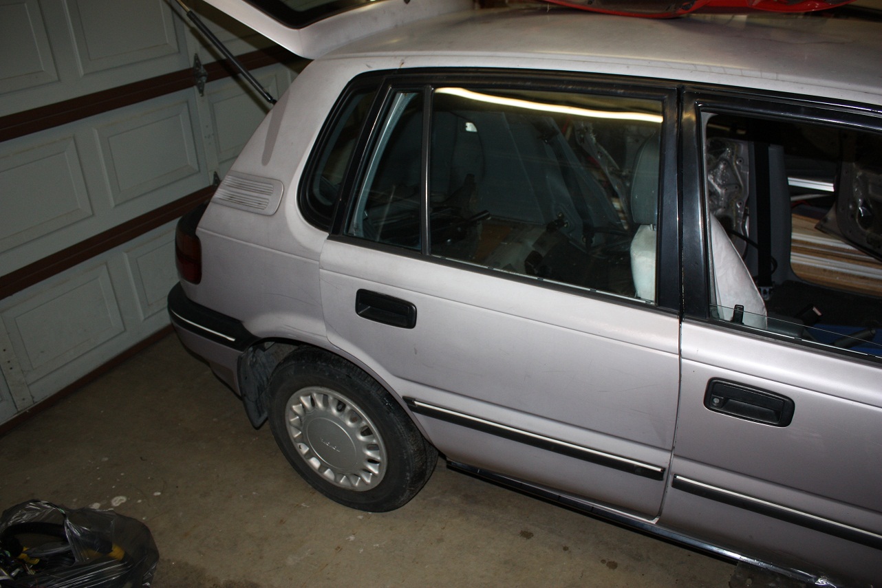

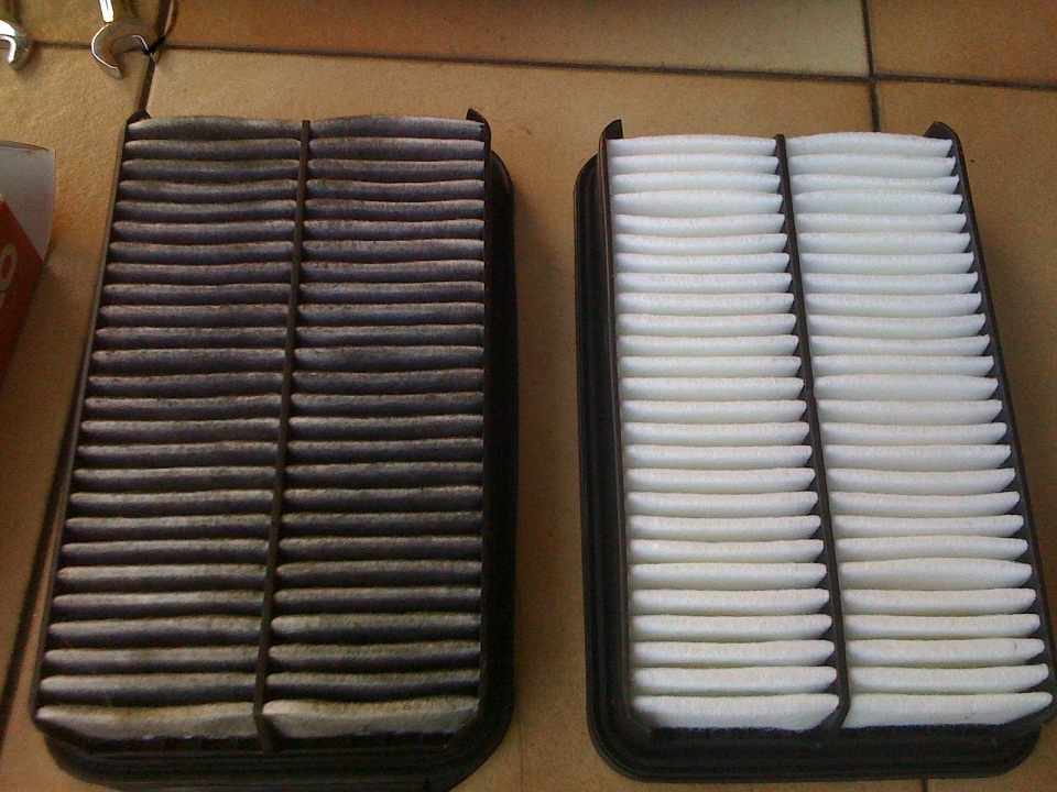

Next I did a complete service changing all the fluids using treatments. Changed the air filter, thought it might need a change.
Removed all the outside door trims of the car.
post-10479-0-66527100-1312289668_thumb.jpg post-10479-0-81287900-1312289681_thumb.jpg

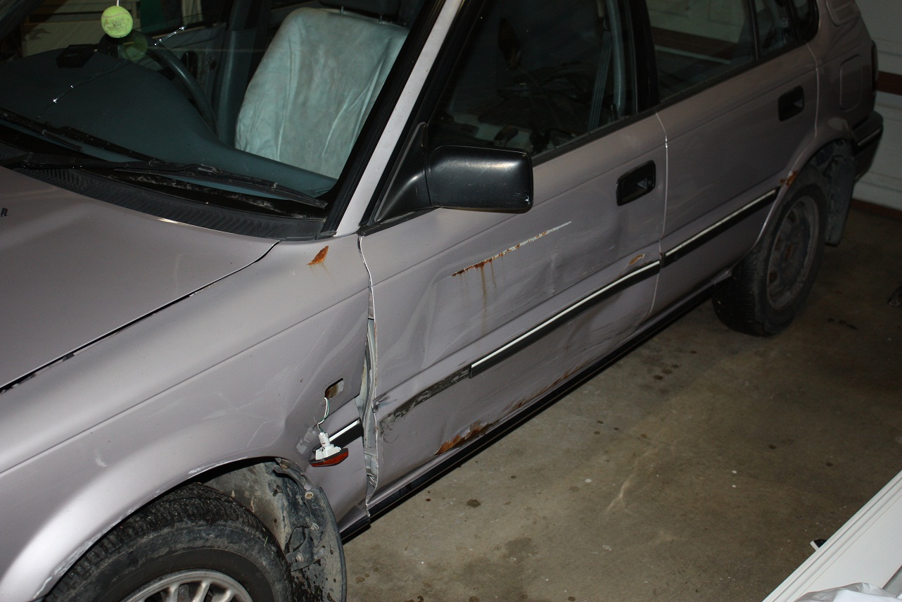

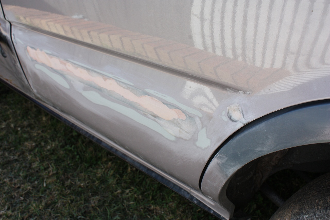

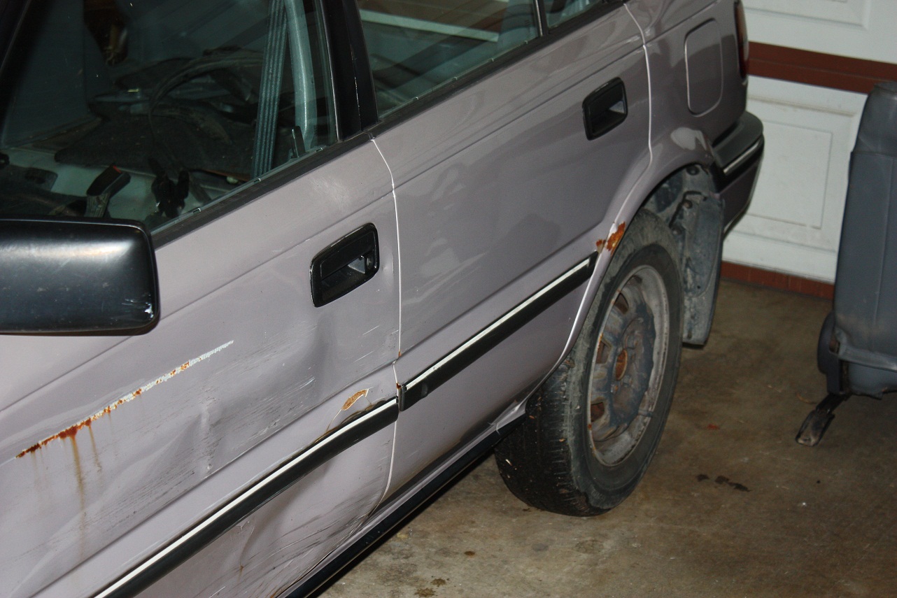

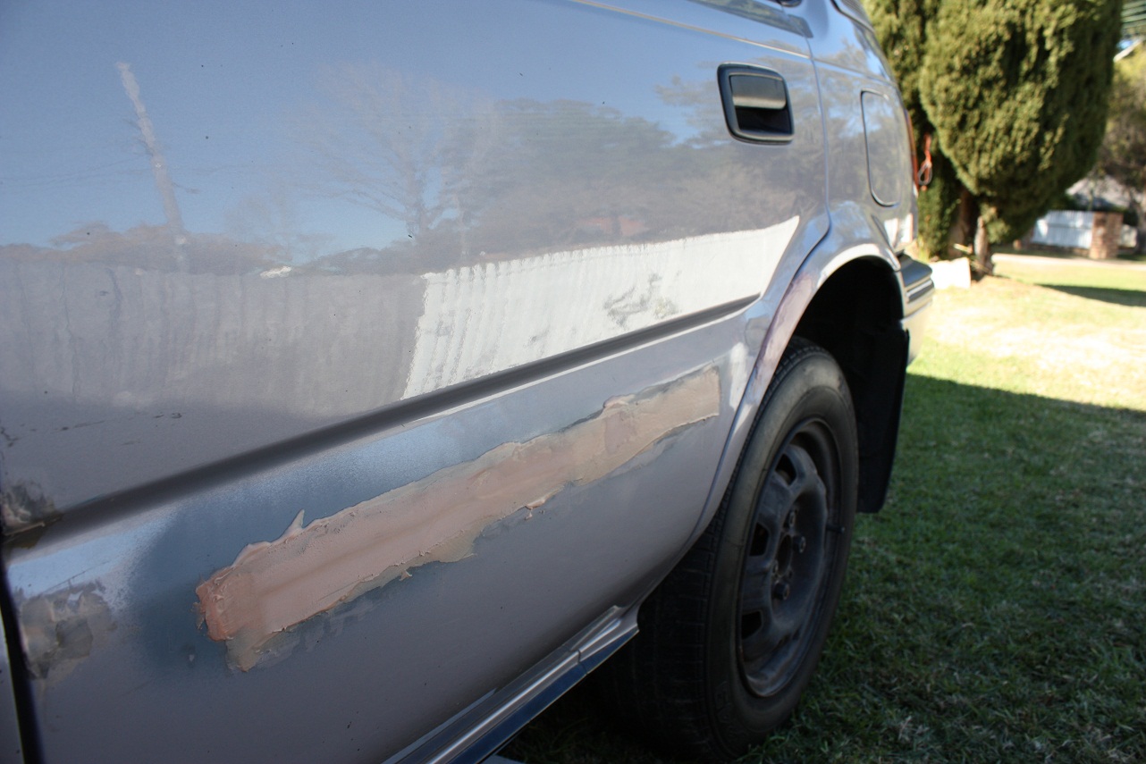

Unfortunately when removing the rear passenger side trim off it tore paint and all straight to bare metal leaving a good ditch in the paint which I ended bogging it up. While I was back there tapped out the dent in the wheel arch as much as I could but Its pretty thick steel so bogged the imperfections.
post-10479-0-10241700-1312289697_thumb.jpg post-10479-0-75388700-1312289709_thumb.jpg

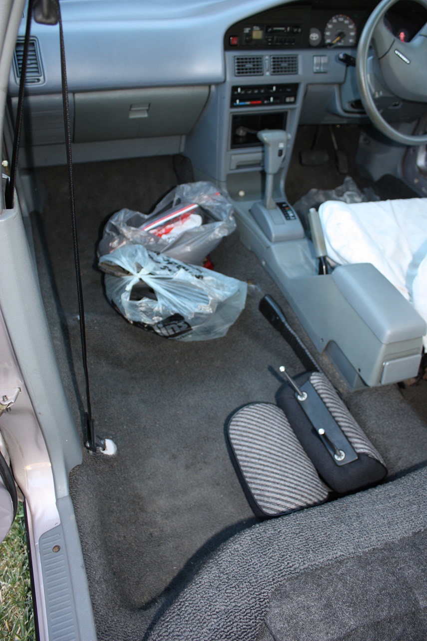

Gave the interior and good clean with some armor all which looked a hell of a lot better than how i got it, plus vacuumed the carpet.

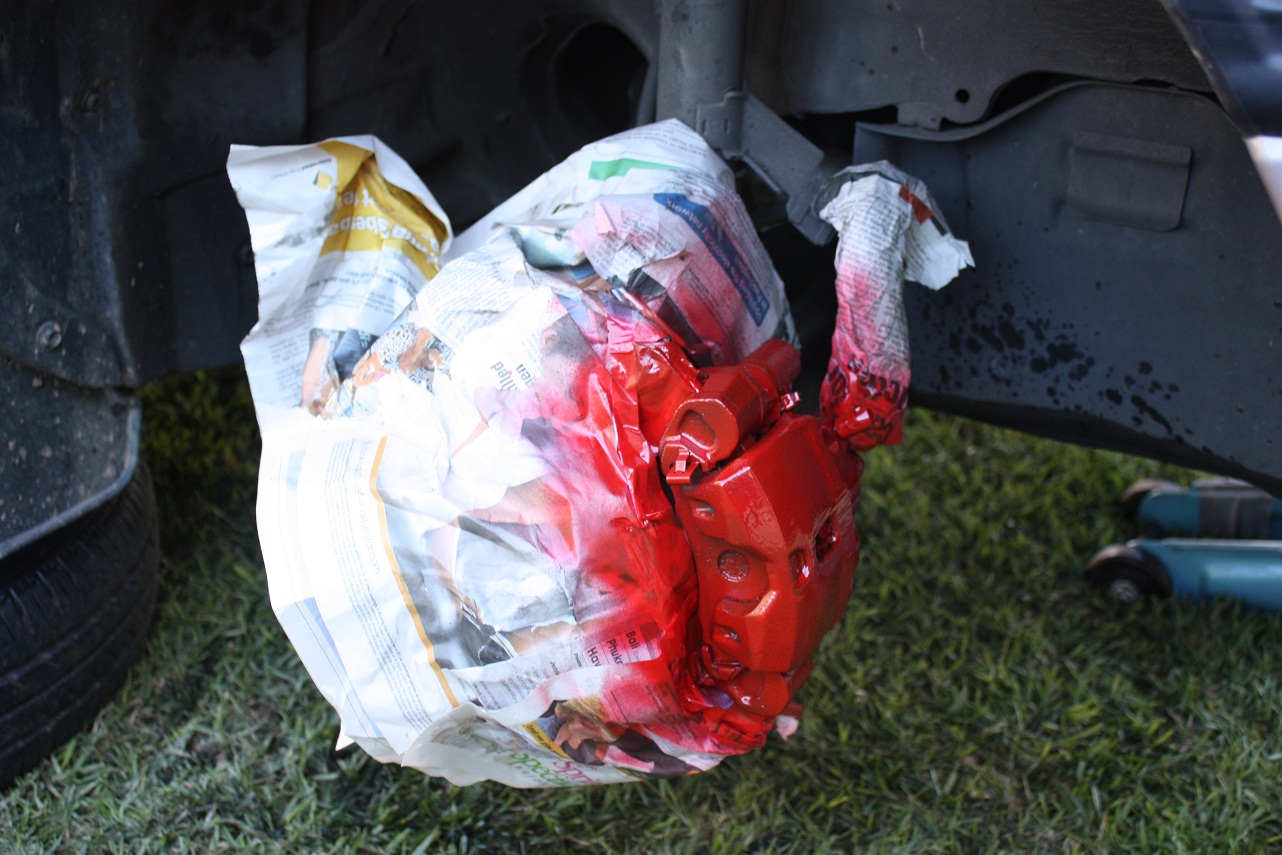

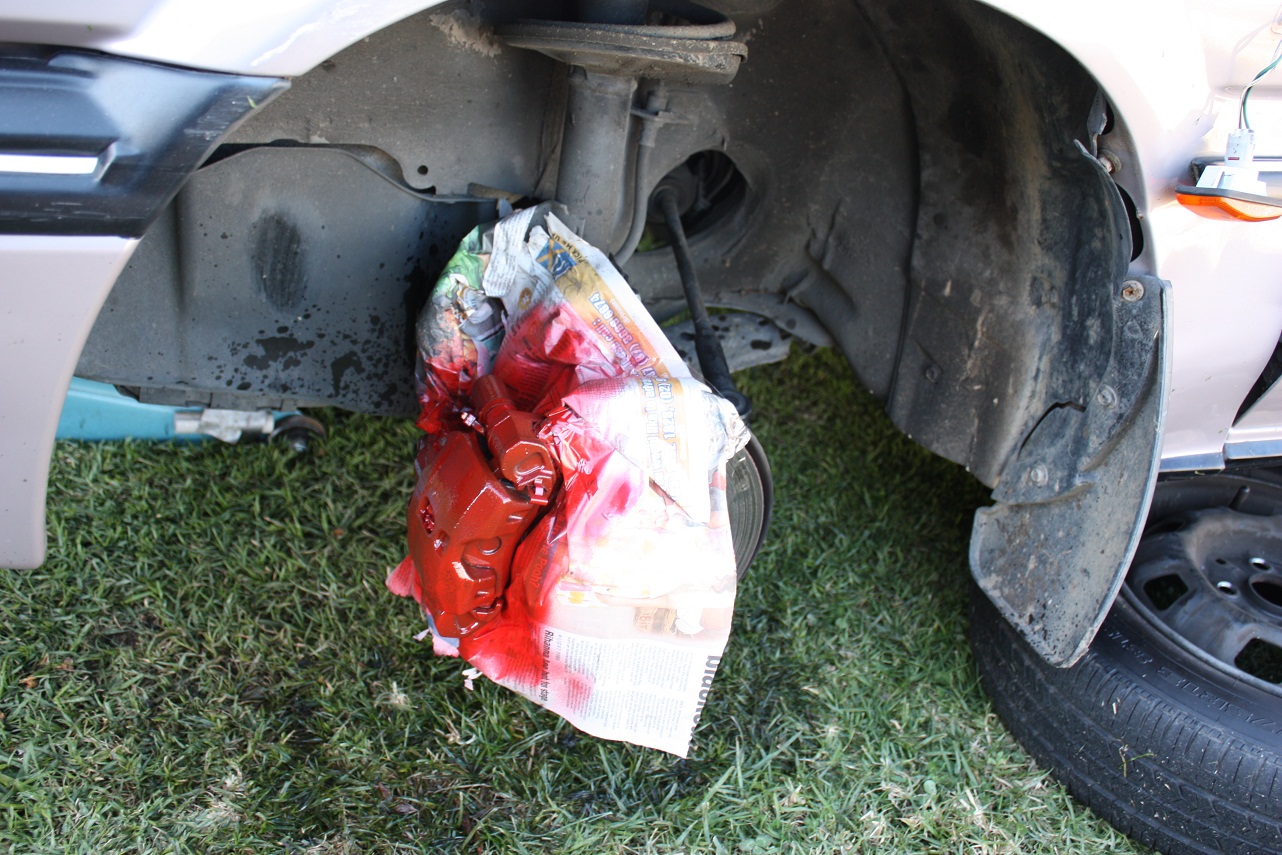

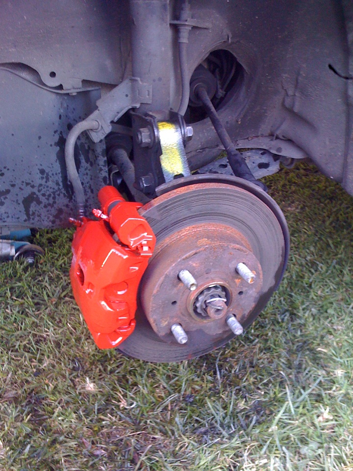

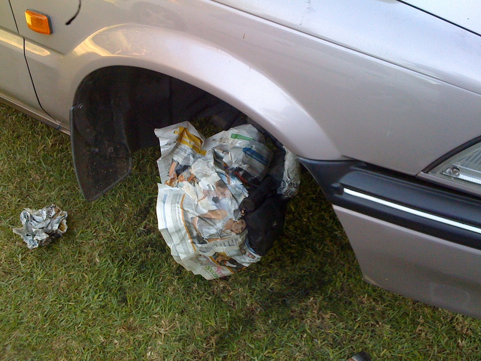

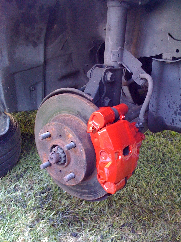

While I had the car jacked up I decided to paint the calipers for that extra power!
I will be taking the disc off and giving them a good clean up after ive finished painting the car.
post-10479-0-66490400-1312354728_thumb.jpg post-10479-0-72972900-1312354745_thumb.jpg post-10479-0-00193800-1312354758_thumb.jpg post-10479-0-80299000-1312354774_thumb.jpg post-10479-0-95766000-1312354794_thumb.jpg

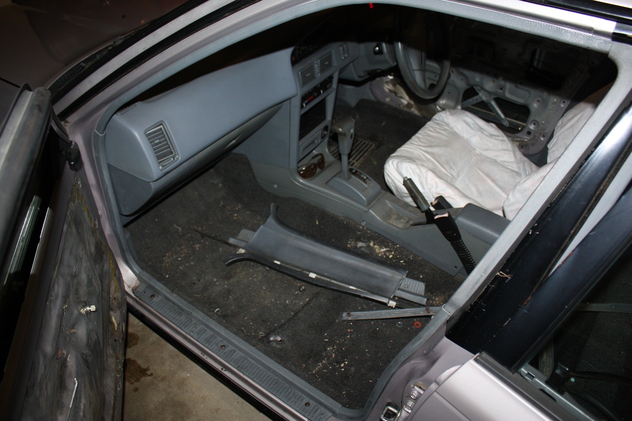

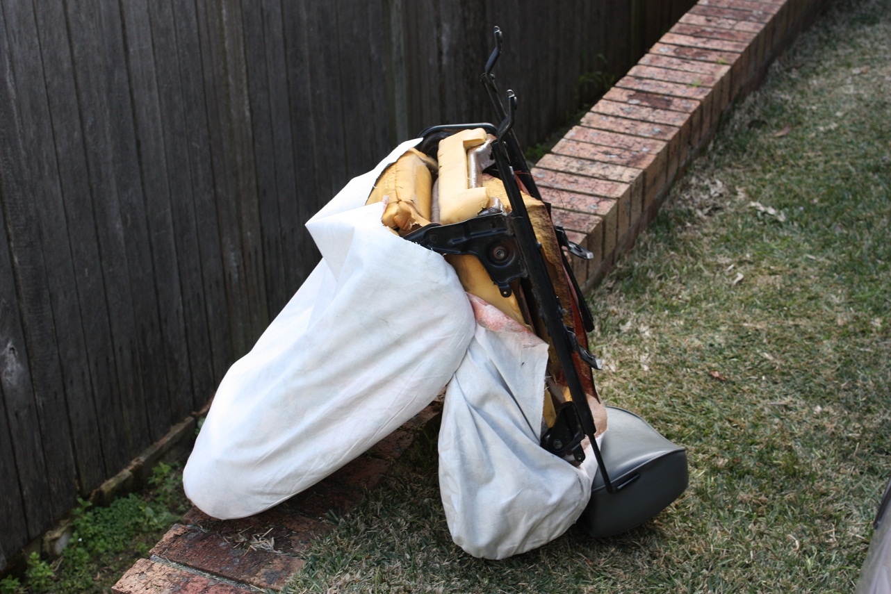

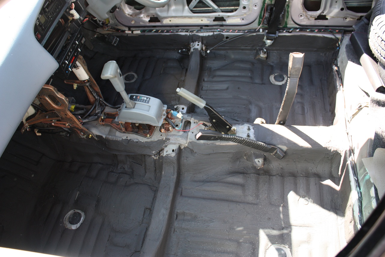

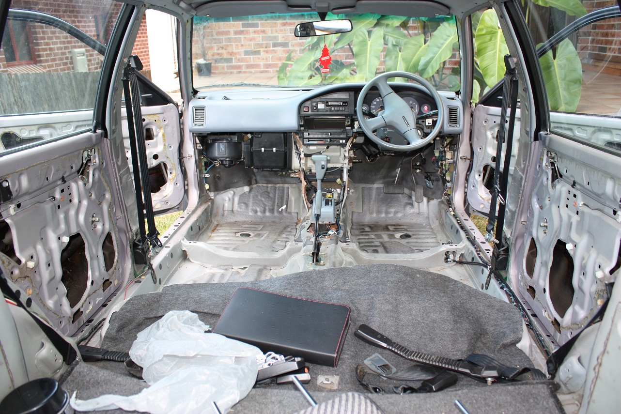

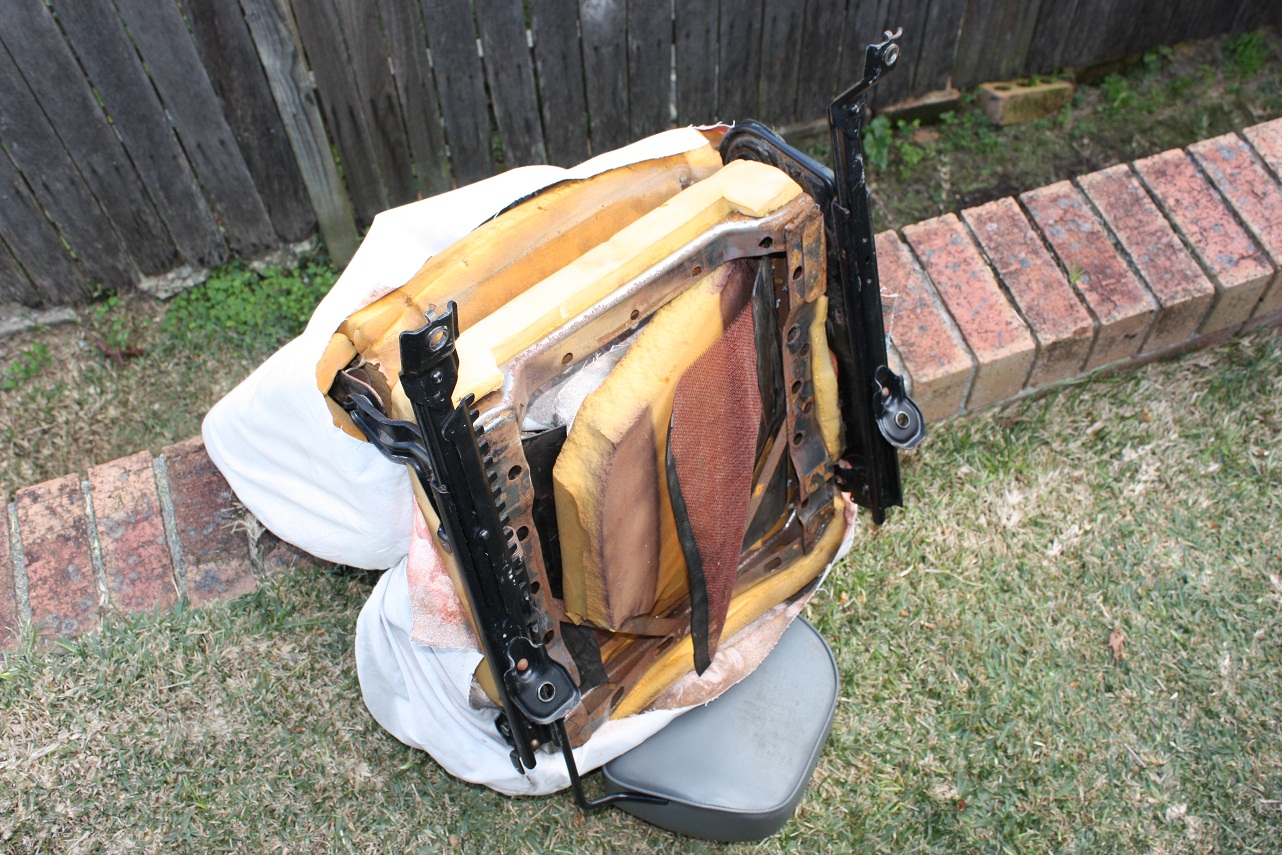

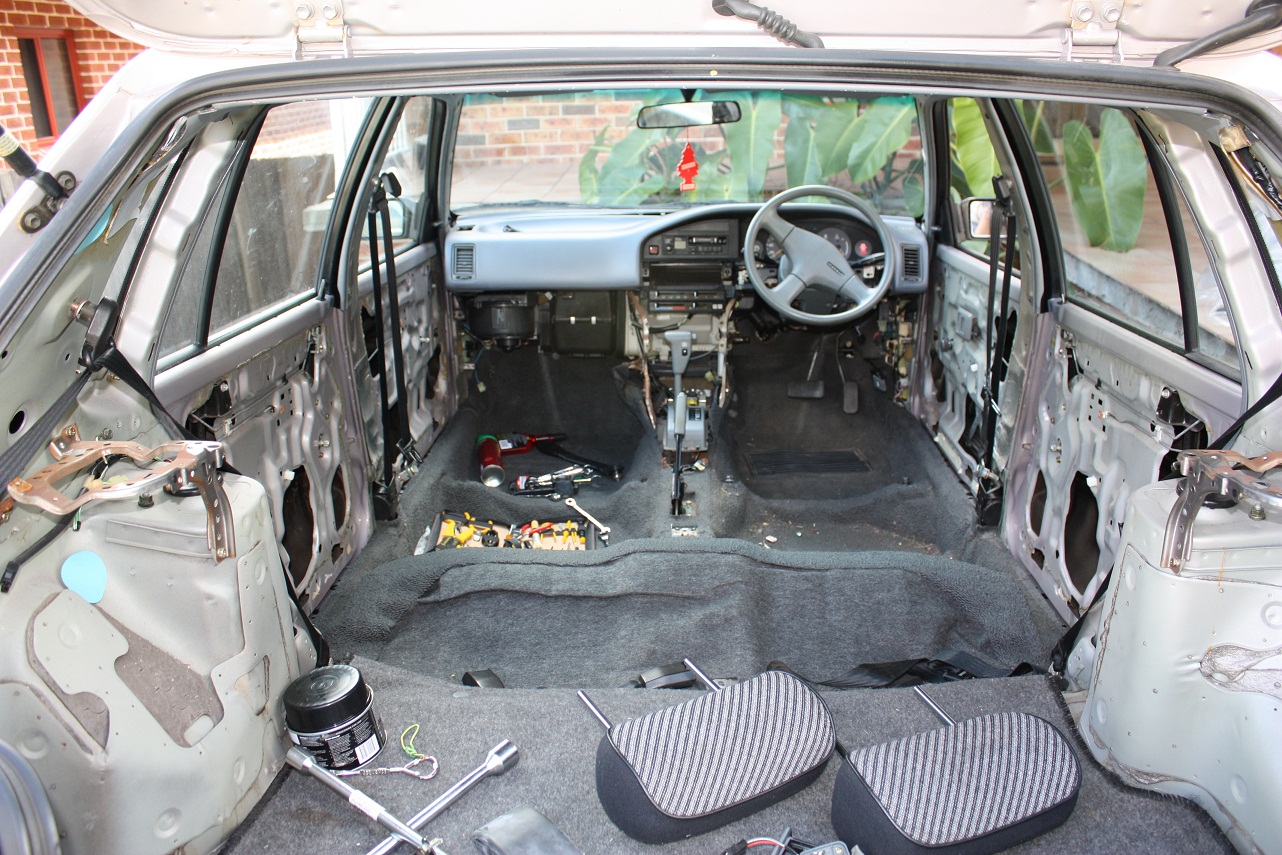

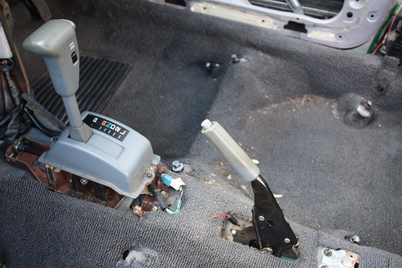

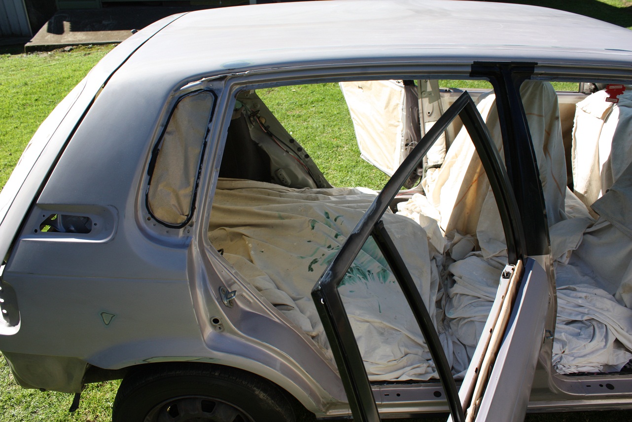

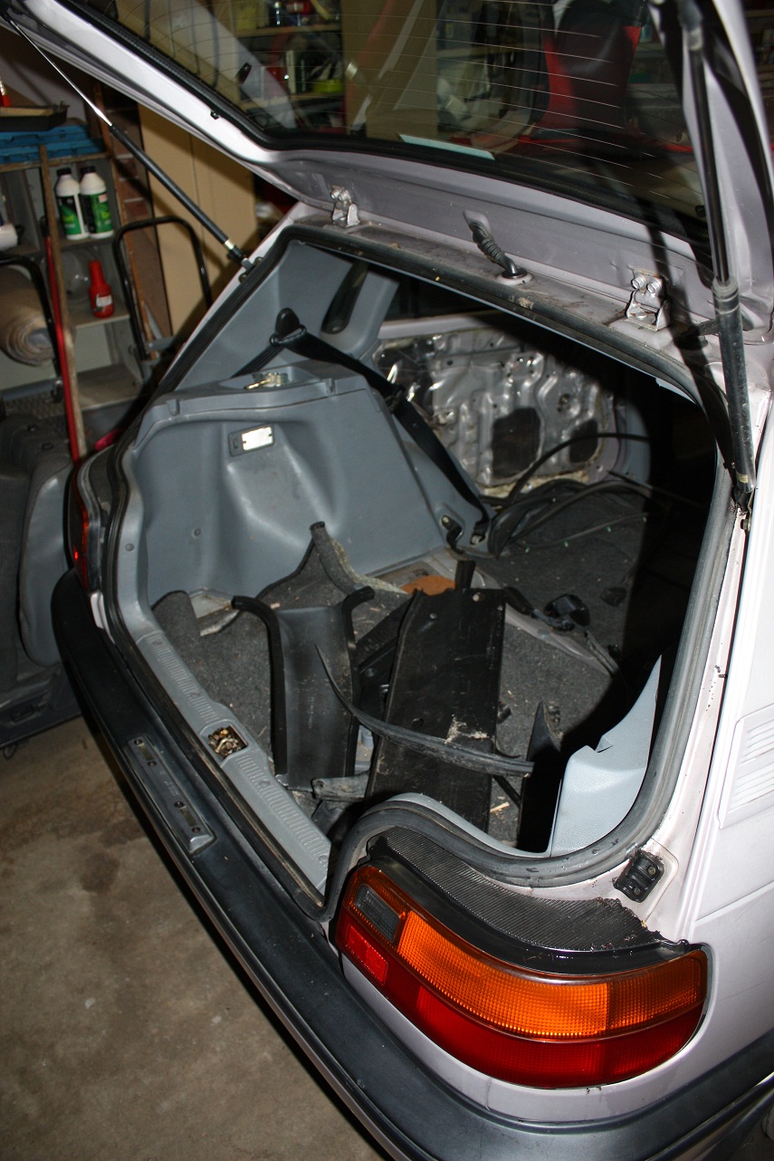

Took all the interior plastic out including the one sorry looking seat.
post-10479-0-71818500-1312355587_thumb.jpg post-10479-0-11090000-1312355915_thumb.jpg post-10479-0-24407600-1312355932_thumb.jpg post-10479-0-72274400-1312355992_thumb.jpg
Car came with a bonus used bandage.
with an unidentified hair on it :|

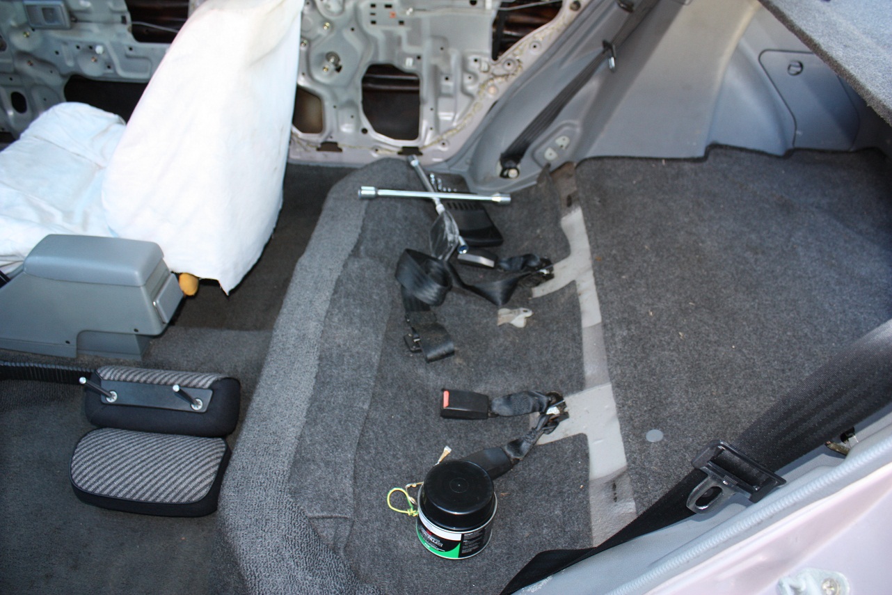

Carpet removed
I'm RICH B!TCH!!

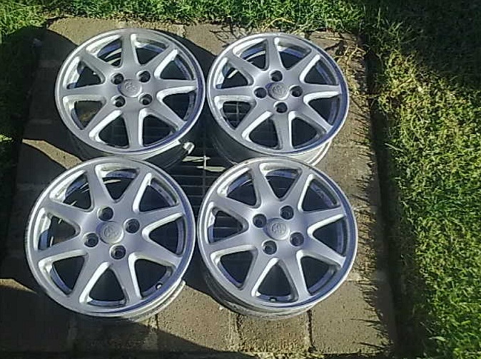

Depending on how much ive spent on it in the end might lower it and put some stock alloys on it. I have a complete set of ae112 levin alloy 8 spokes which would look nice on it. Just tossing up if i should put them on my corolla.

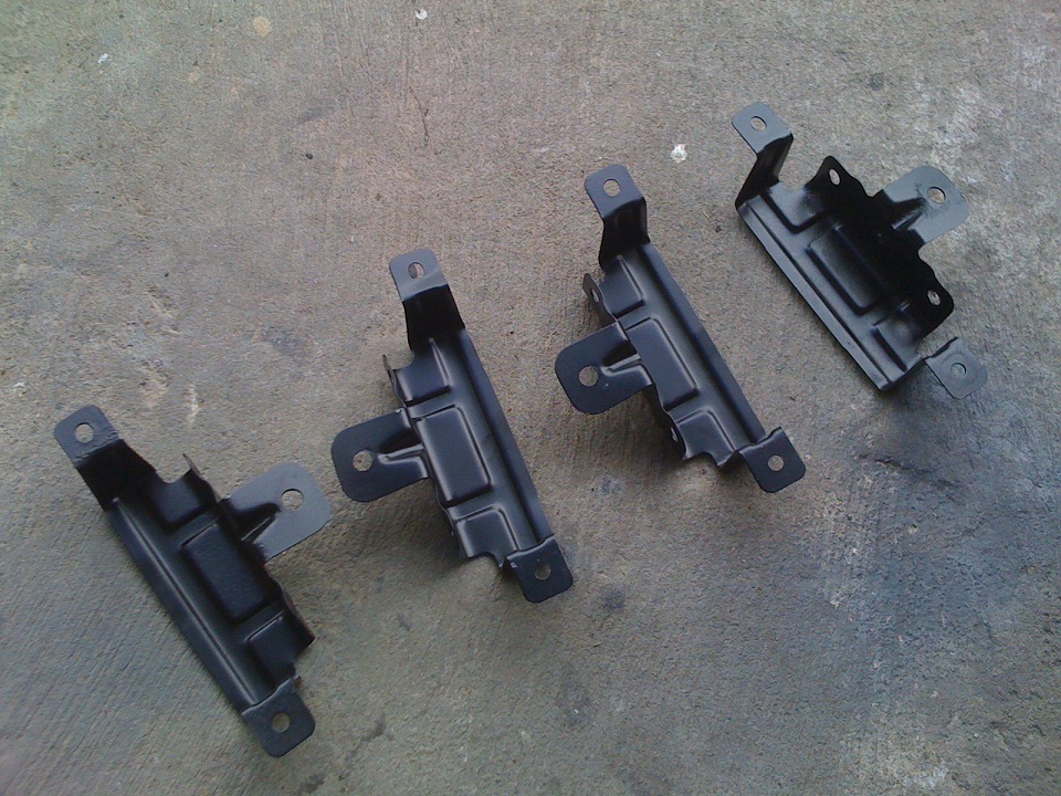

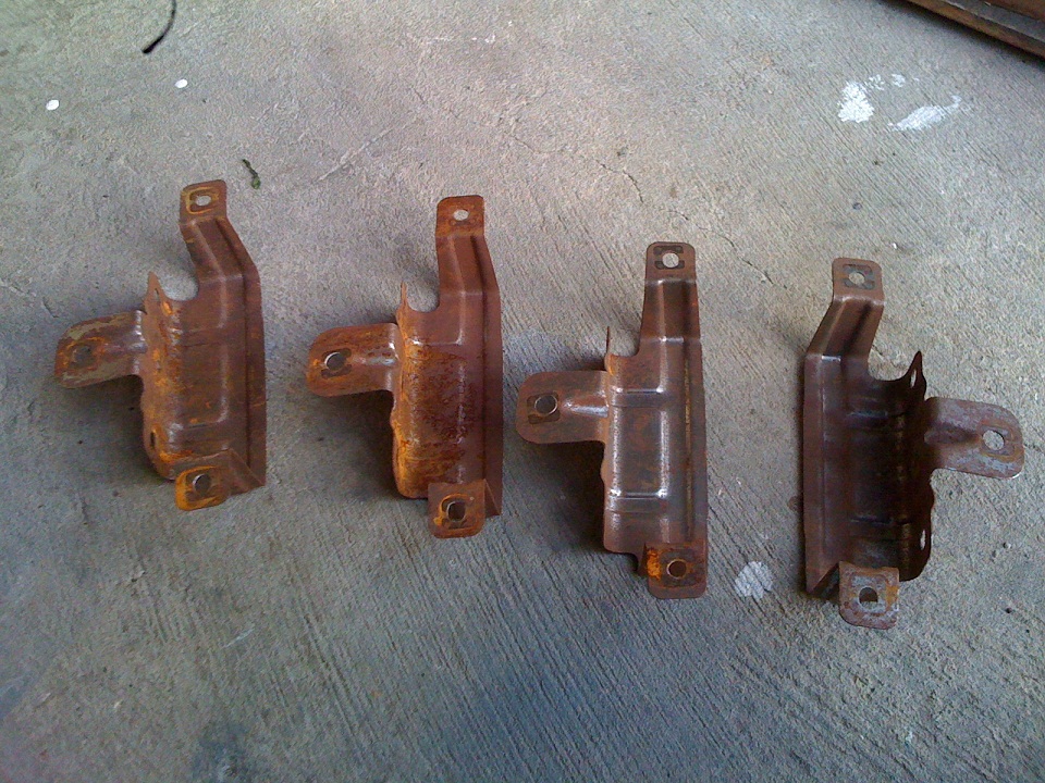

All screws, interior plastic and carpet tagged and bagged.

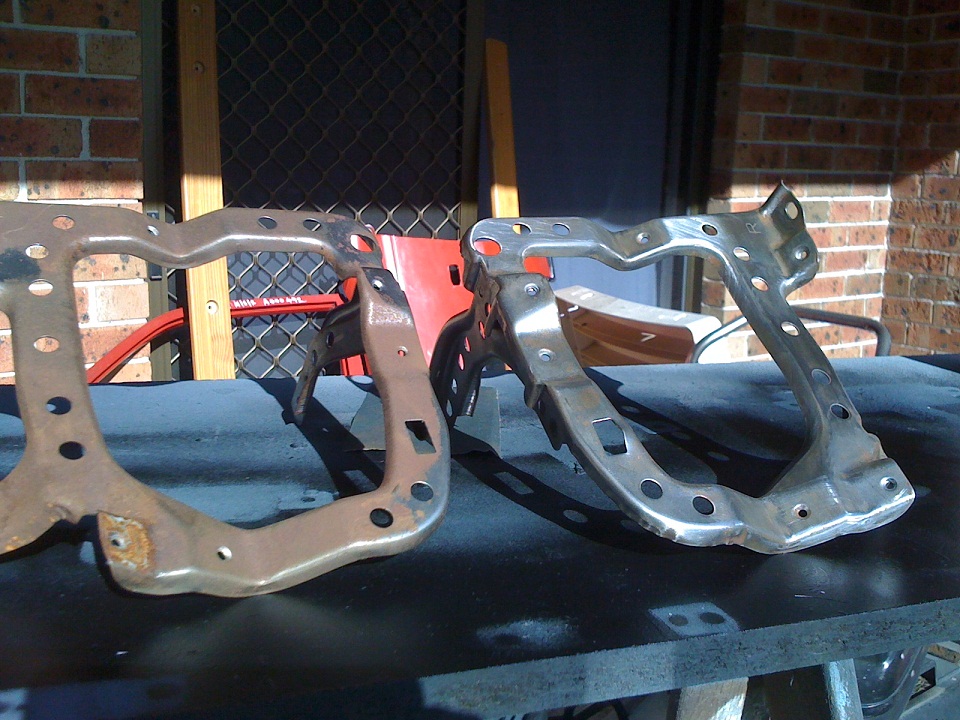

interior door trim brackets looked a little to rush so sanded them back and respayed them matt black.
post-10479-0-77079300-1312357610_thumb.jpg post-10479-0-75750000-1312357632_thumb.jpg

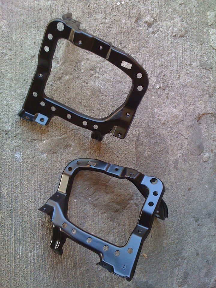

Did the same with the rear brackets but gloss black.
post-10479-0-58943900-1312357652_thumb.jpg post-10479-0-71890300-1312357666_thumb.jpg
You will never see these brackets once the cars put together. But I can't resist making it look fresh and new :laff:

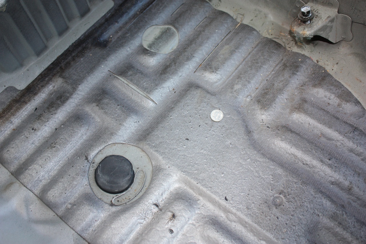

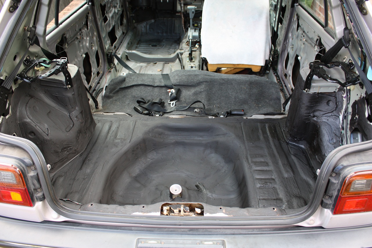

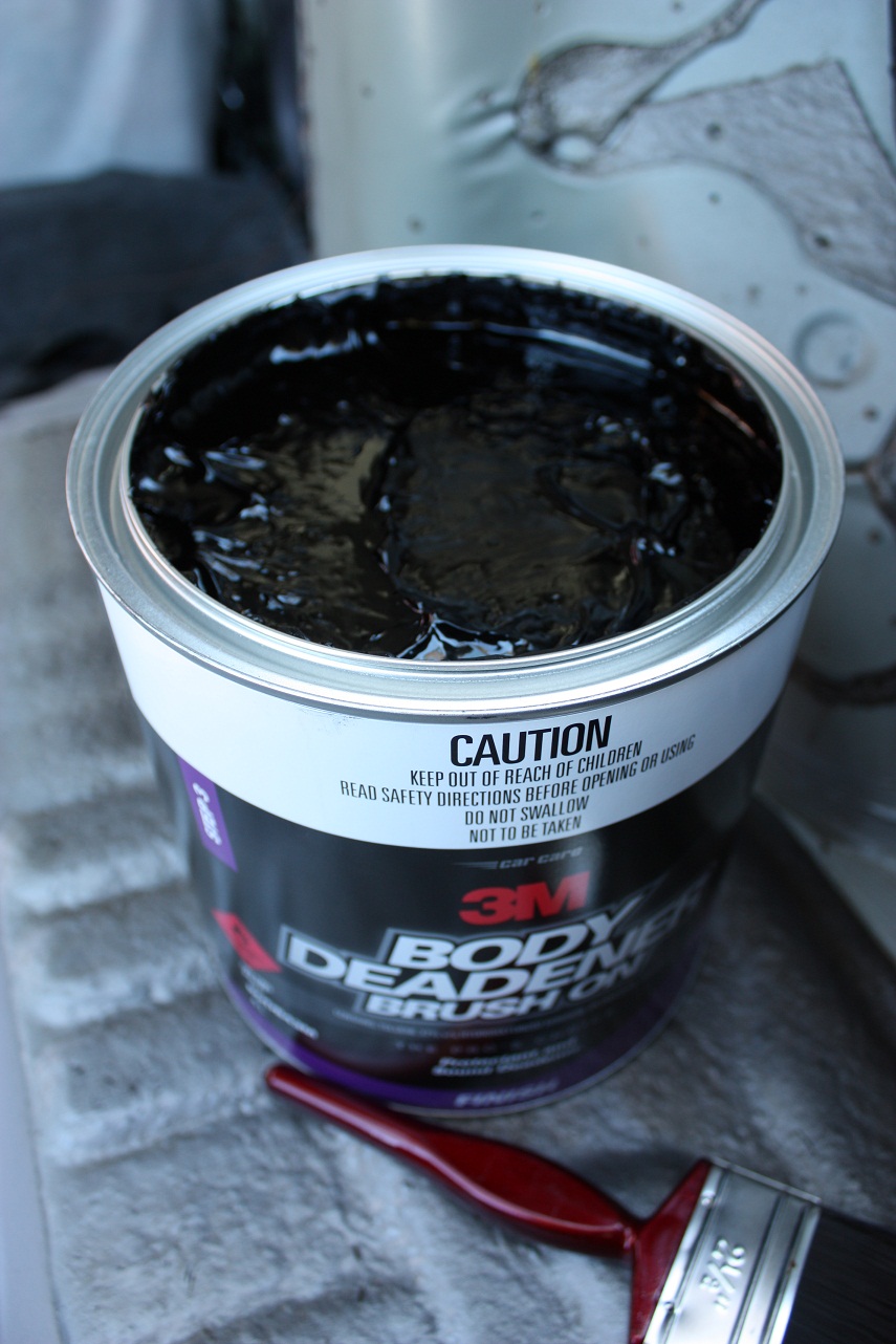

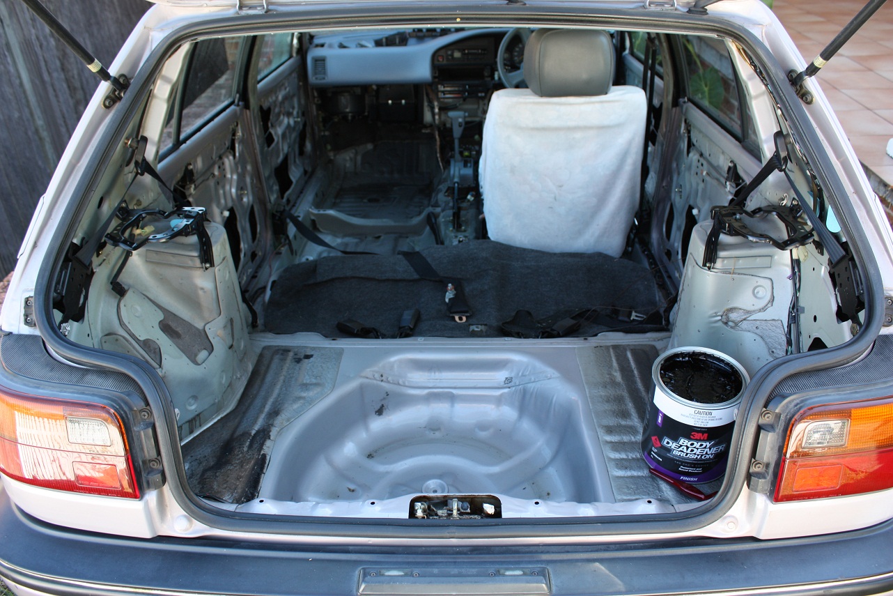

So while everything thing was out I decided to brush on sound deadener paint. Not sure with this stuff works but thought I would give it a try.
post-10479-0-66055000-1312449933_thumb.jpg post-10479-0-98375200-1312449949_thumb.jpg post-10479-0-73824900-1312449968_thumb.jpg post-10479-0-49166800-1312449983_thumb.jpg

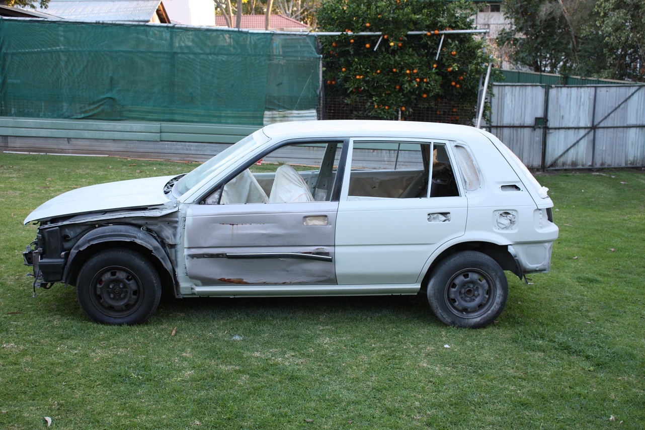

Update. Got the car primed minus front and rear bumper. Need to buy some plastic primer. Pics coming soon.

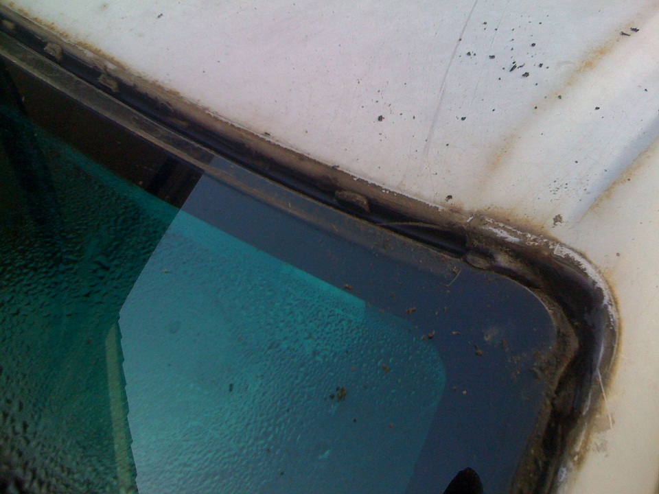

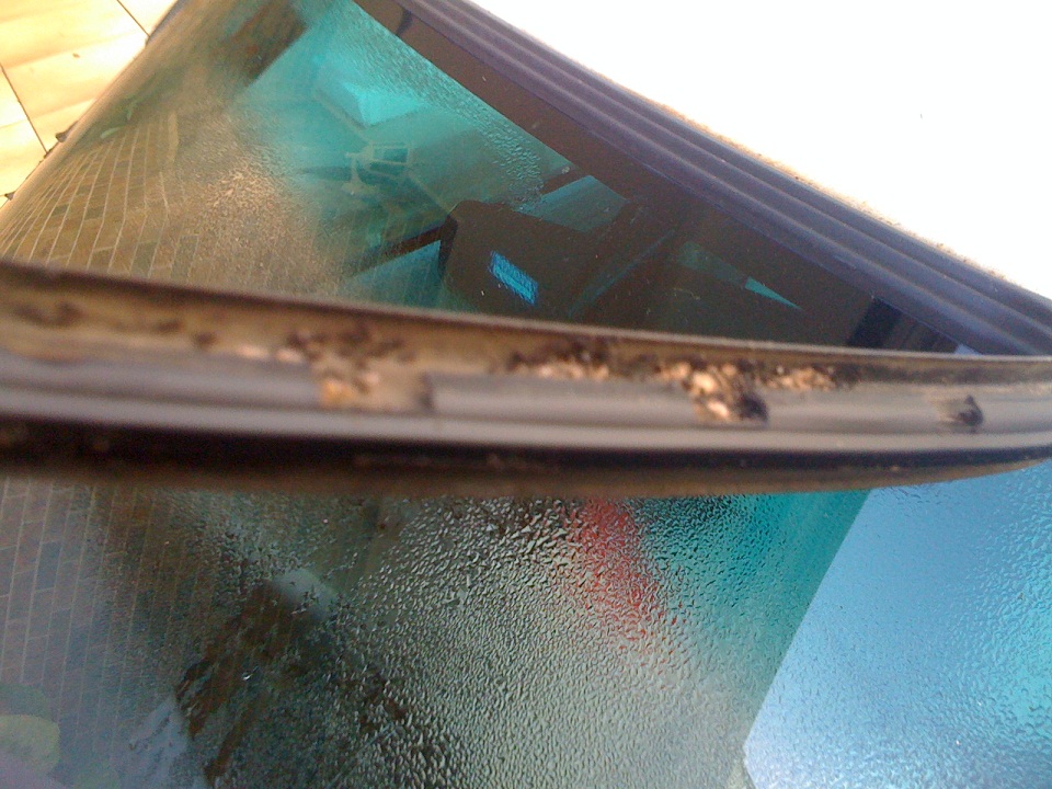

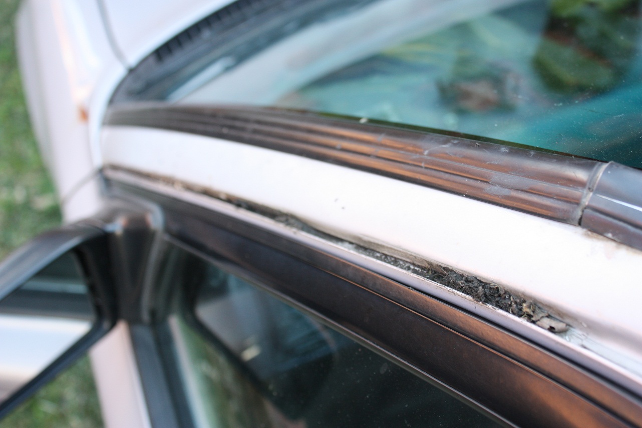

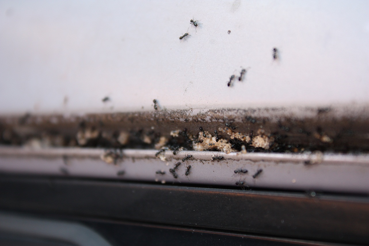

Removed all the window trims and found some little surprises. Few ants nest in different locations on the car.
post-10479-0-21304100-1312540011_thumb.jpg post-10479-0-06532300-1312540028_thumb.jpg post-10479-0-98946600-1312540049_thumb.jpg
Little bit of surface rust around the windscreen which I'm happy about because its nothing major.

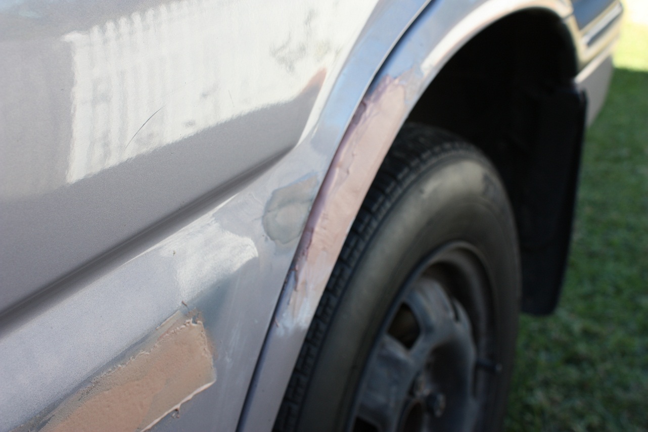

Smoothed out the bog and finished the repair on the rear door and wheel arch.
post-10479-0-62814700-1312540224_thumb.jpg post-10479-0-44755100-1312540234_thumb.jpg
Second ae92 on here with the ants nest, how did you go about removing that plastic trim goes down the a pillar? and also the windscreen trims? Your advice would be appreciated :y:

lol I think your talking about my one, I did the post about the leaking ae92 :)

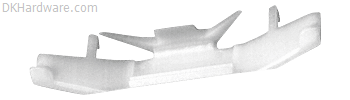

removing the platic trims I used a small flat screw driver starting from the back door and slowly prising the plastic off the rail till I reached the front then it pretty much popped off.
For the windscreen trim the clips and plastic is pretty fragile. There is ruffle about 5 - 6 clips on both sides. Pretty much just used the same method with a flat screw driver trying not to break the clips.
Then you can take the corner molds off which will allow you to take the top trim/ seal off the windscreen. This pretty much pulls off just start from one side and start pulling it off. This part has a sort of metal or something in it so that if you bend it it will keep the bend but it can be straightened out again.
Hope this helps
The clips looks something like this
Ah fantastic thanks for the tip! I may need to remove those rain channel trims to clean in the a pillars to rid it of anything which may have accumilated in its 17 years.

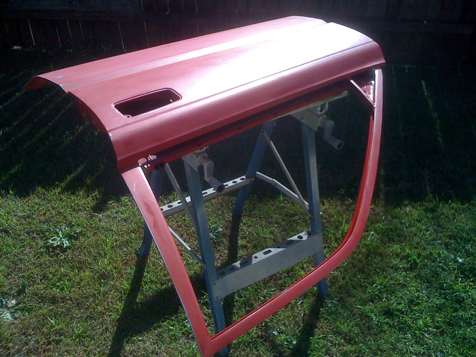

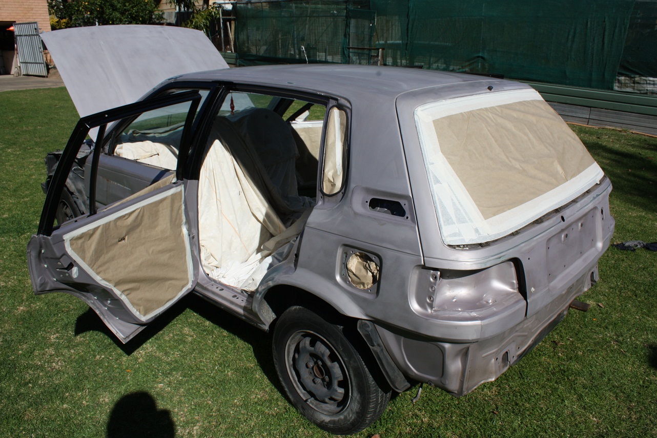

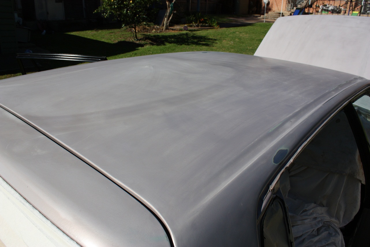

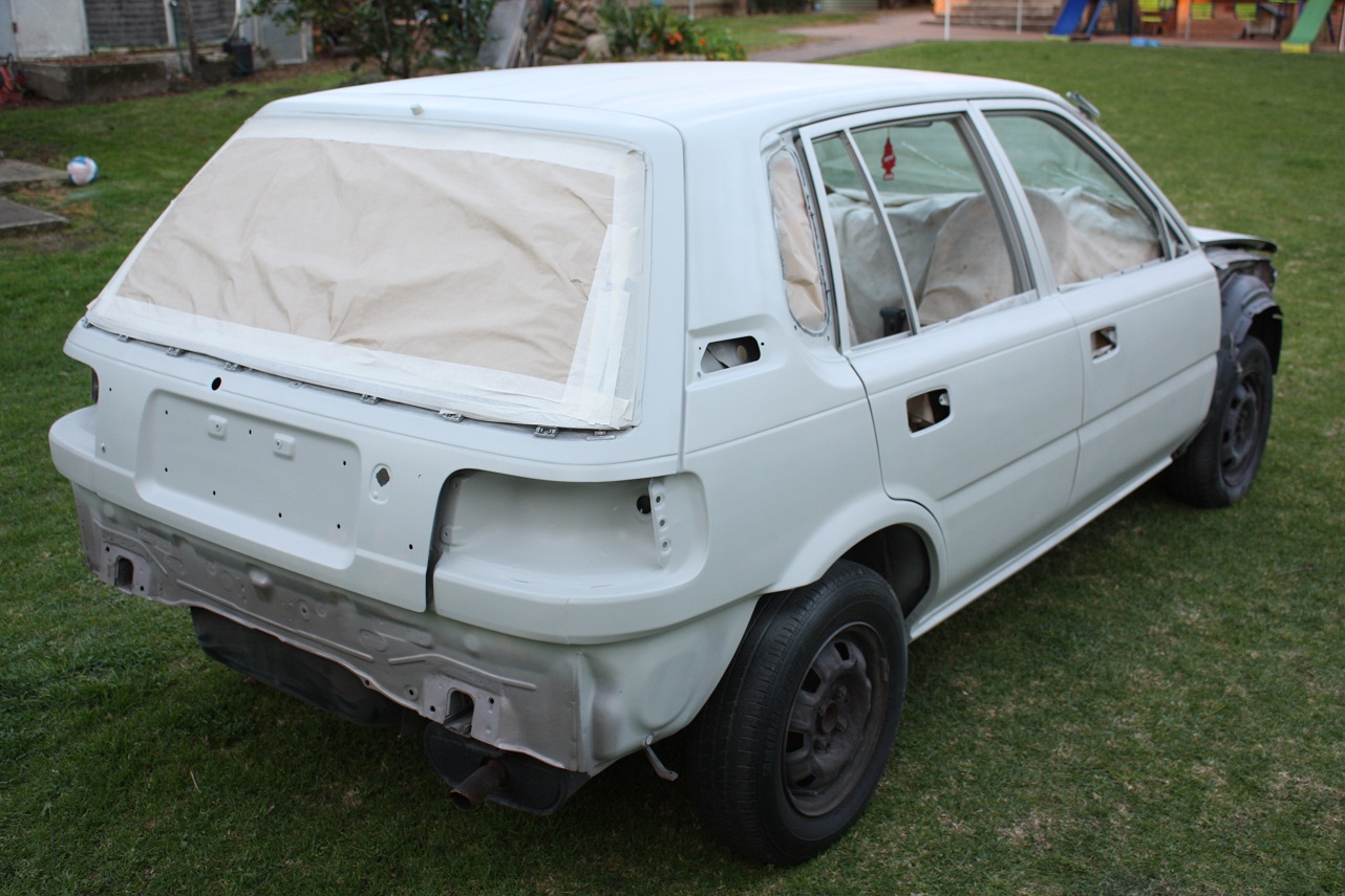

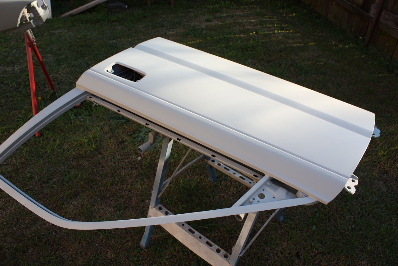

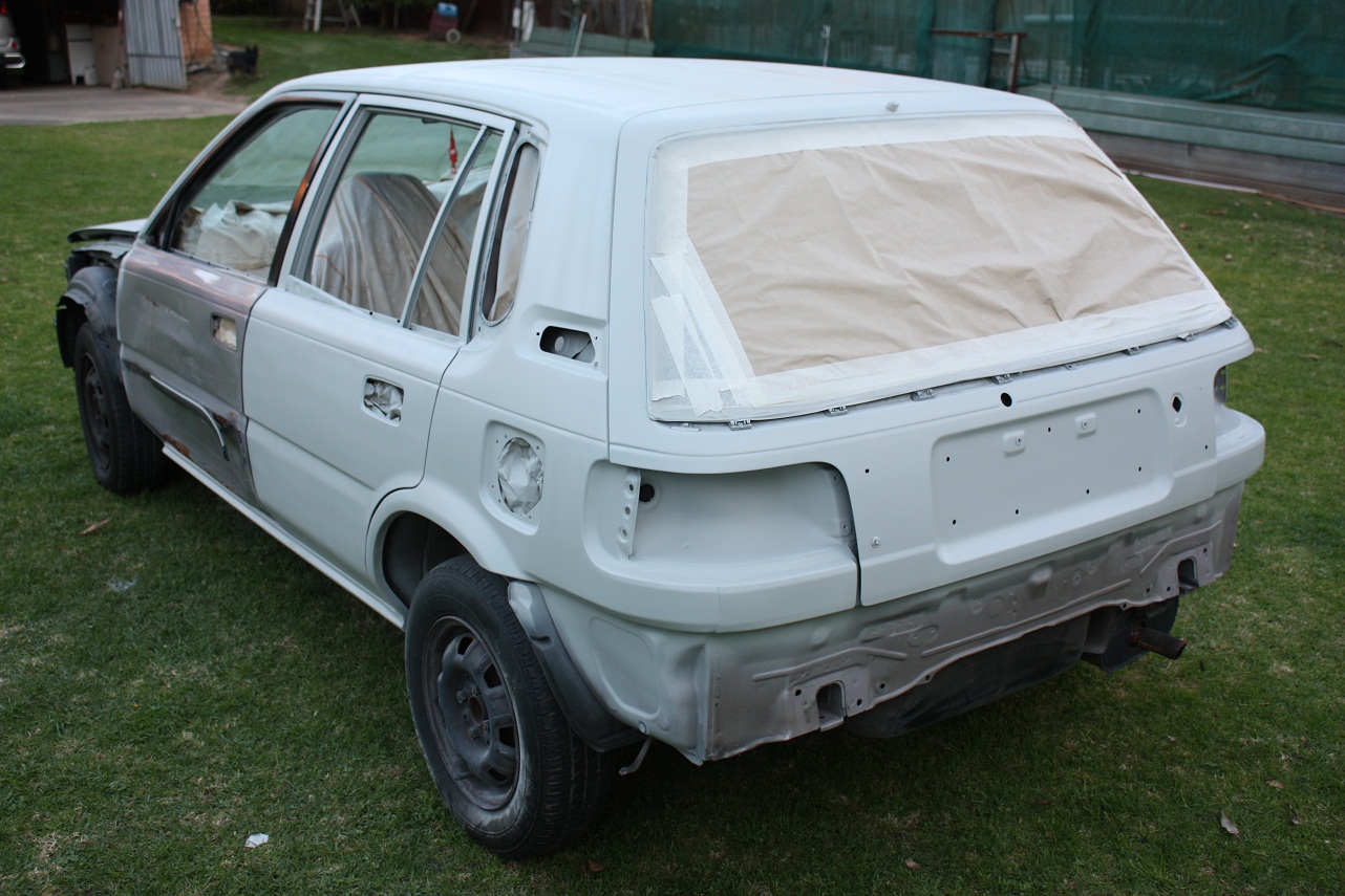

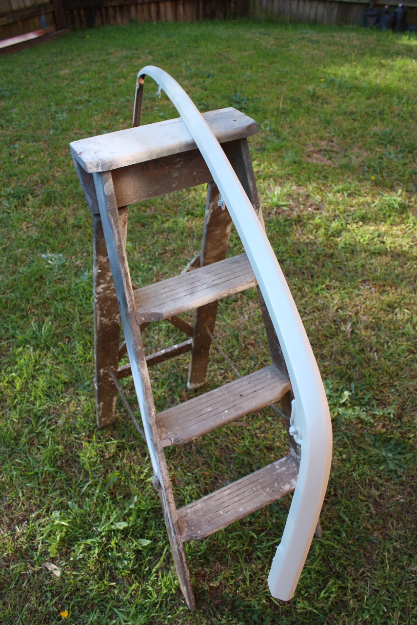

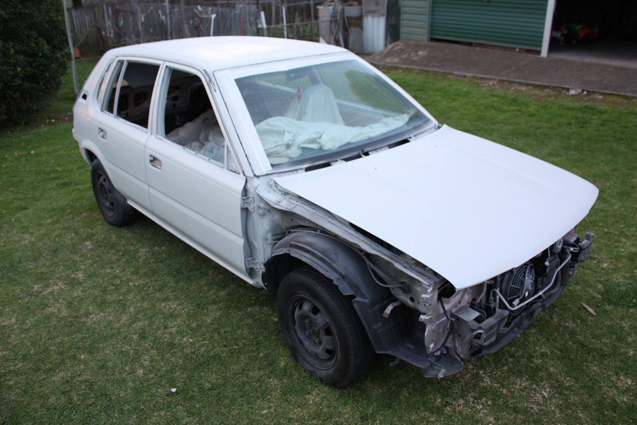

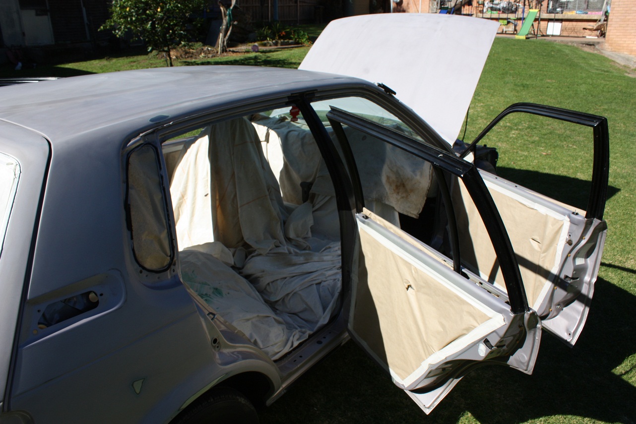

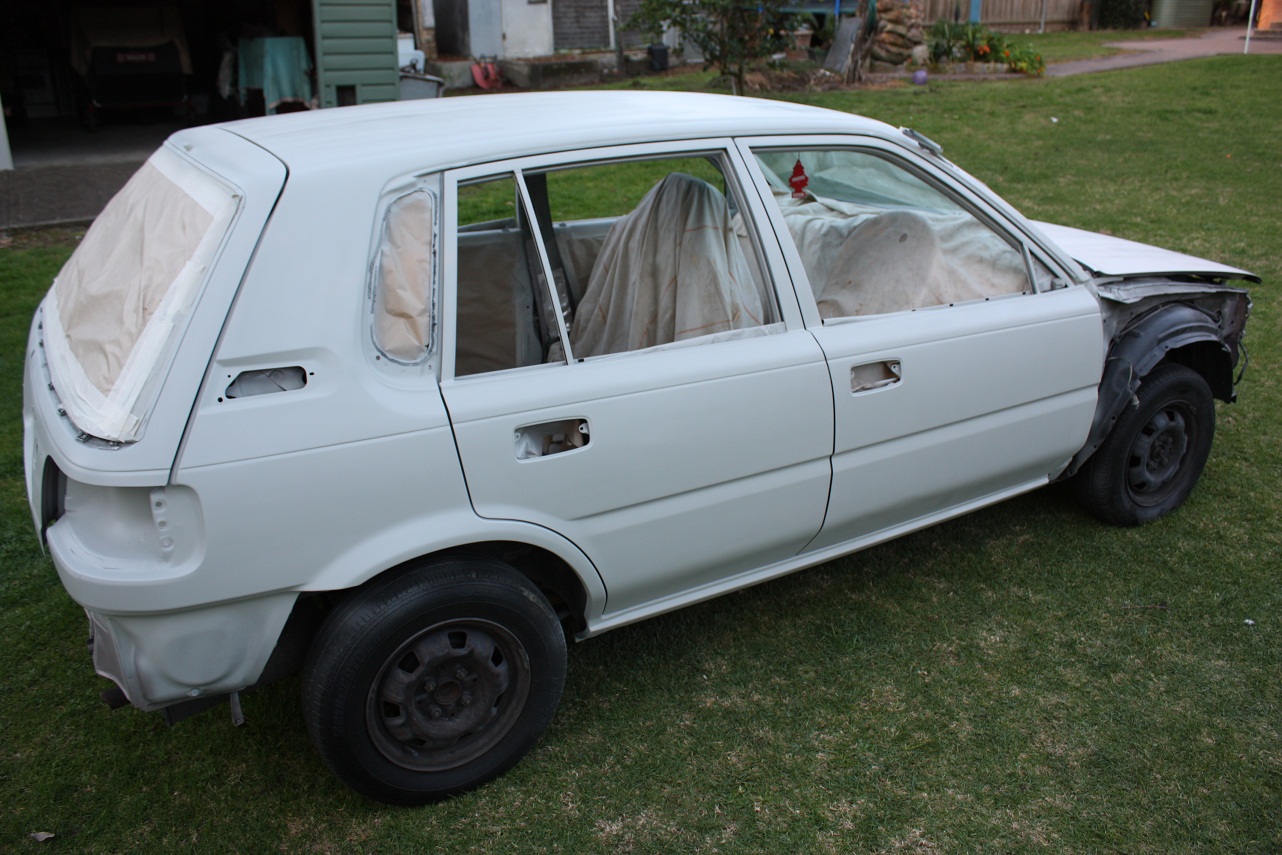

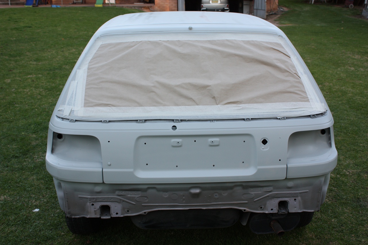

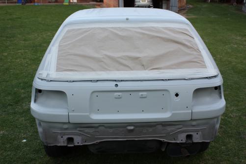

With the beautiful weather we had in Sydney on Friday and Saturday got the car sanded back and primed :) Really happy with the job, only got 1 small dag in the primer about the size of a 10cent piece but its no biggy will come out when went sanding. Other than that no runs! :laff:
Time for picture!
THE CAR IS CALLING

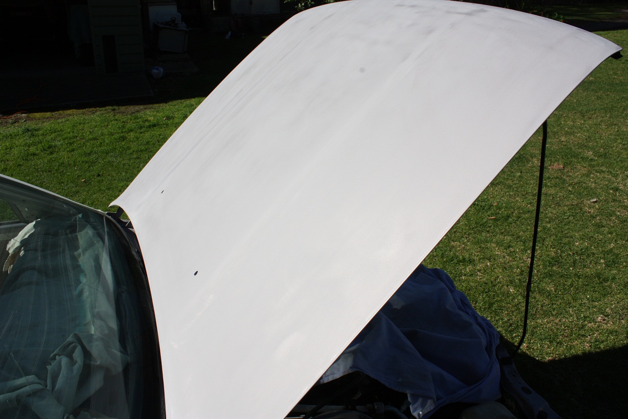

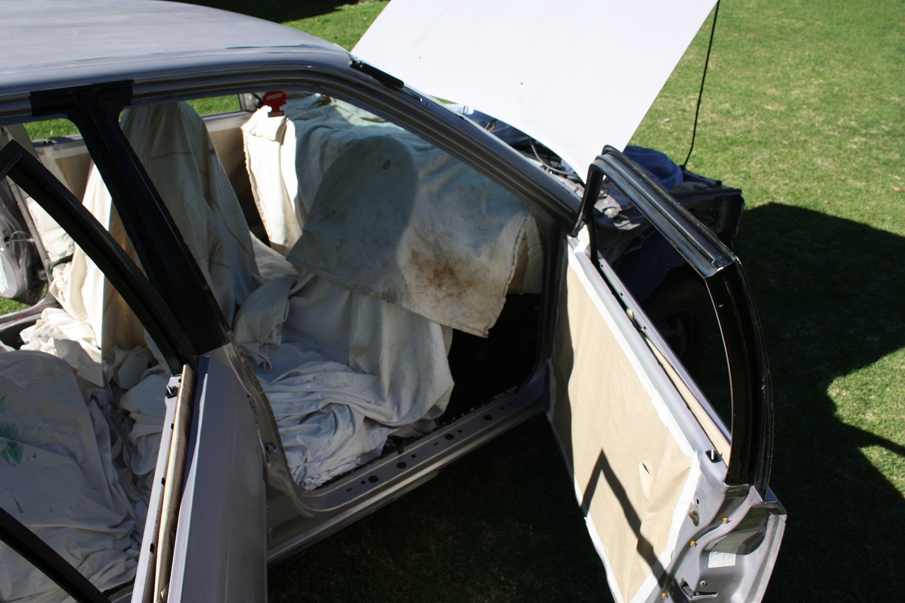

All sanded back and masked off. Didn't bother about the front windscreen because its getting replaced anyways. Sprayed it with the hatch down and will do the hatch jamb when the bumpers are getting sprayed plus will remove the bonnet and spray the under side. All door jambs got sprayed aswell.
post-10479-0-24440700-1312702800_thumb.jpg post-10479-0-37911000-1312702815_thumb.jpg post-10479-0-09117200-1312702831_thumb.jpg post-10479-0-32108000-1312702861_thumb.jpg post-10479-0-50038700-1312702872_thumb.jpg post-10479-0-75598500-1312702883_thumb.jpg post-10479-0-68097700-1312702898_thumb.jpg
All primed!
post-10479-0-82463300-1312703813_thumb.jpg post-10479-0-43118400-1312703824_thumb.jpg post-10479-0-23551600-1312703837_thumb.jpg post-10479-0-04991800-1312703850_thumb.jpg post-10479-0-70252600-1312703862_thumb.jpg post-10479-0-03055100-1312703874_thumb.jpg

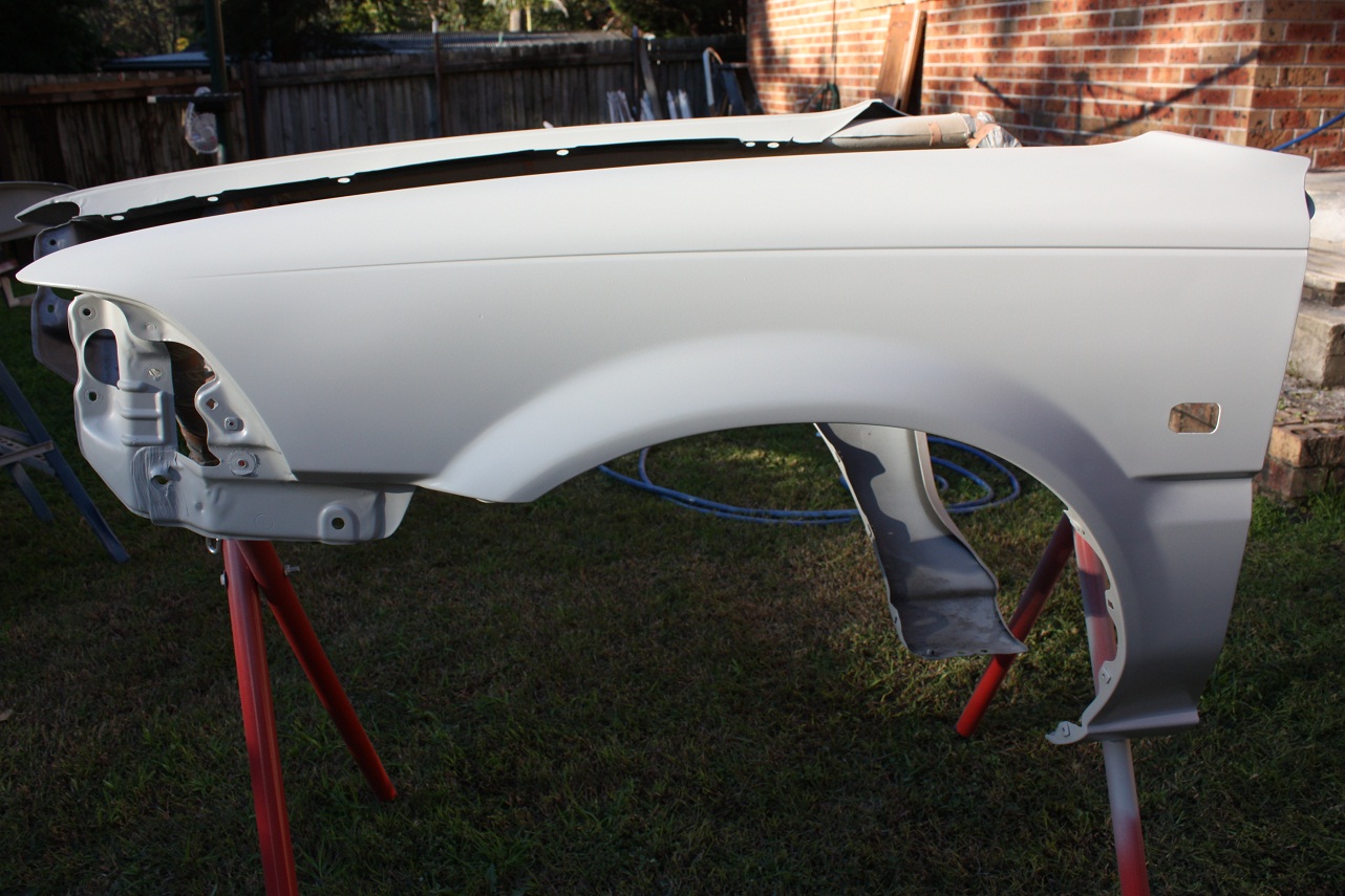

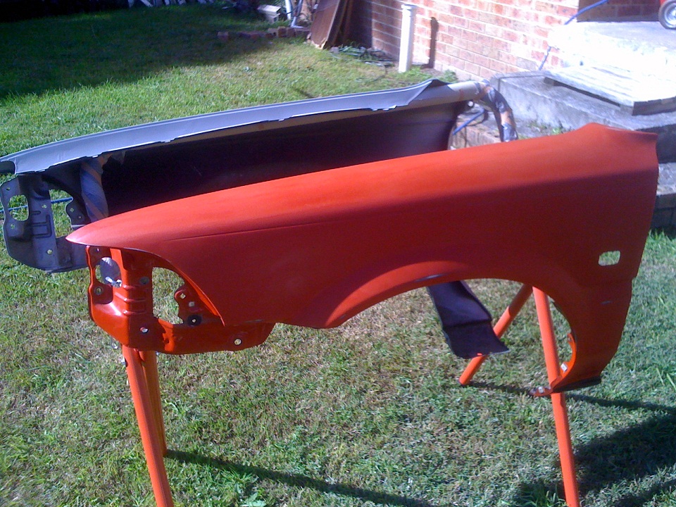

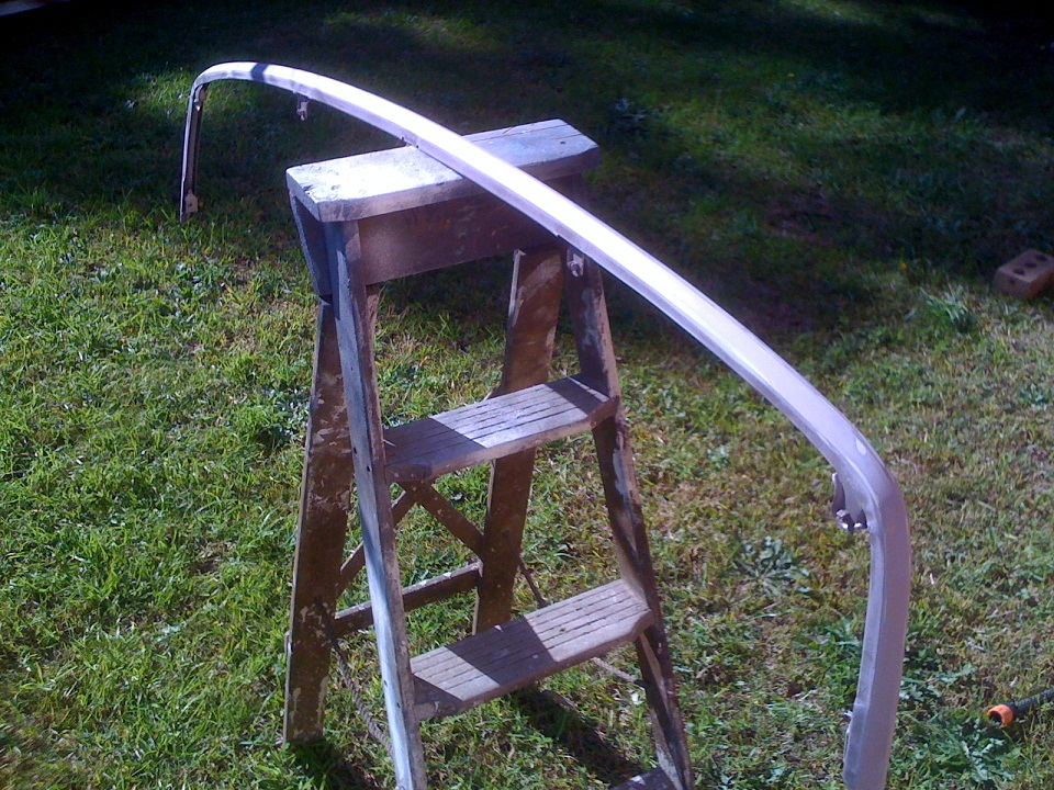

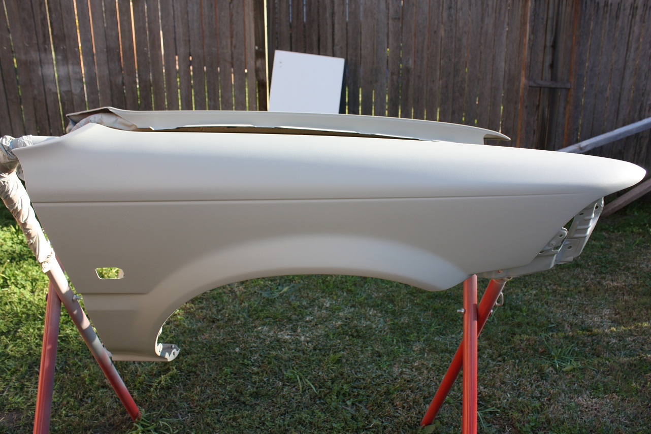

Front bumper metal strip, quarter panel with replacement panel and front left door sanded back and primed.
post-10479-0-42160600-1312704672_thumb.jpg post-10479-0-19196500-1312704686_thumb.jpg post-10479-0-46213400-1312704699_thumb.jpg post-10479-0-72720100-1312704866_thumb.jpg post-10479-0-23255400-1312704880_thumb.jpg post-10479-0-99027400-1312704895_thumb.jpg post-10479-0-72017100-1312704913_thumb.jpg
