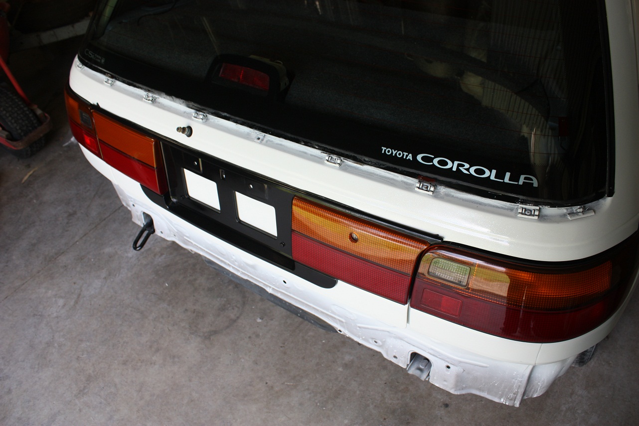

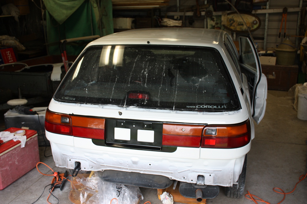

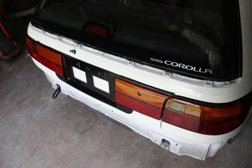

Looks awesome, and that carpet looks so lush. I'm not suprised about the condition of the water when you rinsed it off! Actually I like how you did those tail lights I might do the same thing :blush:
Will look great when its finished, can't wait to see it :y:

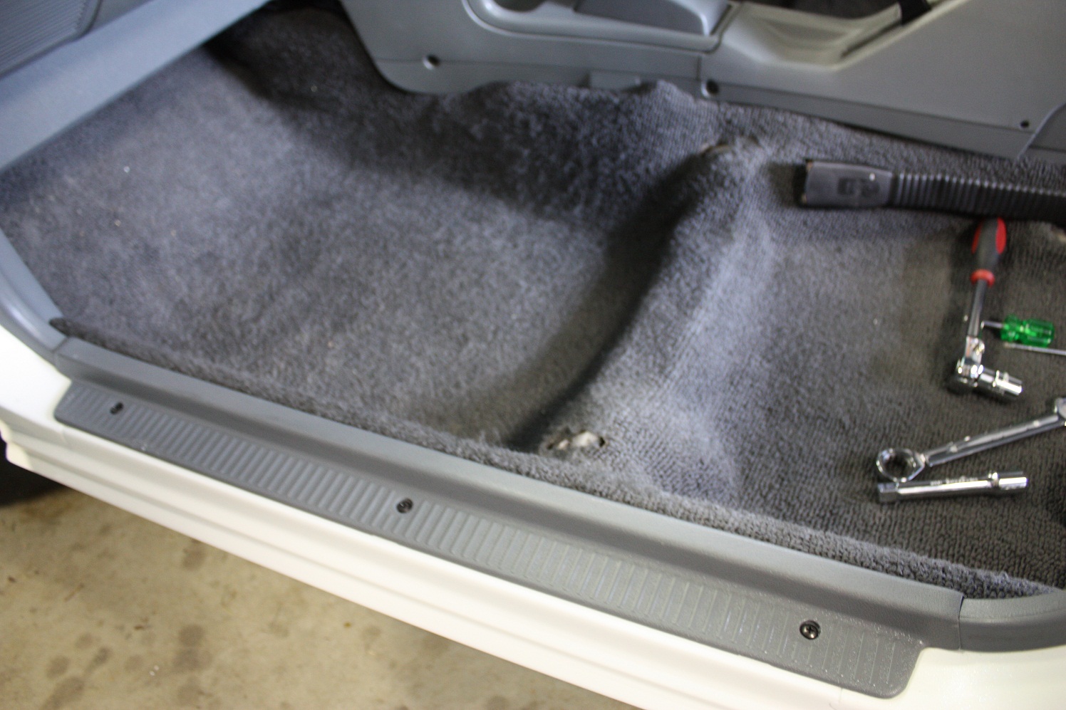

Yeah I was quite happy with the carpet. The back seat area looks brand new and the front pretty good aswell. They guy didn't drive the car much so that was a bonus.
The tail lights came out quite well. I must masked them all up, rub them back, plastic primed them and the gloss black over it.
Just trying to make the car look tasteful not doing anything that would give the cops a reason to pull you over for.

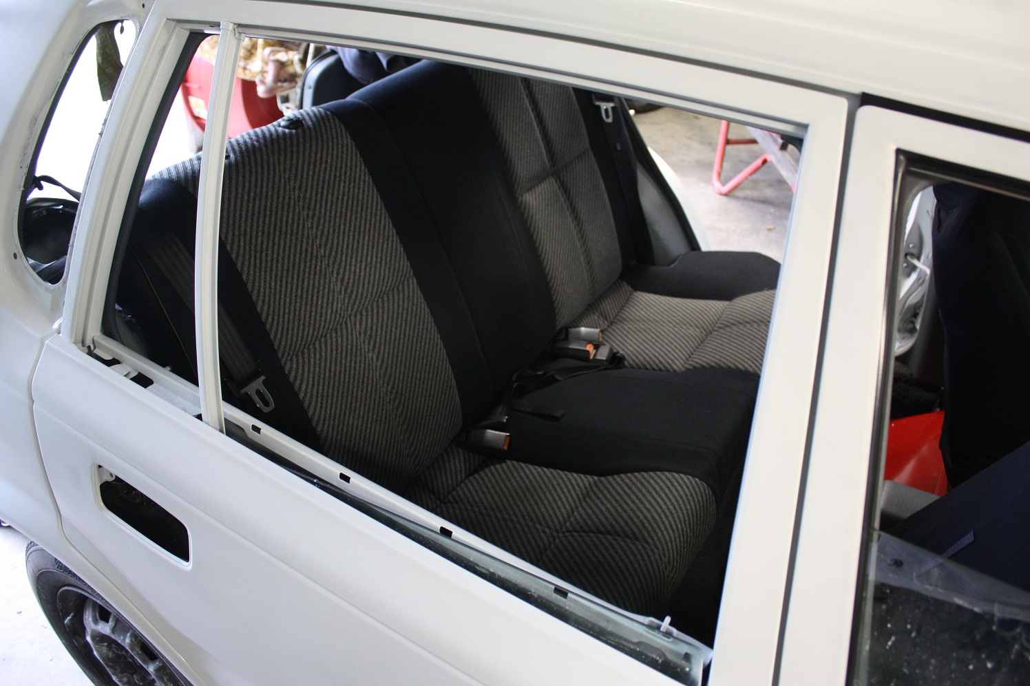

Put all the ae93 sx interior seats in. Seats need a really good cleaning, going to hire one of those carpet cleaners from woolies.
Bought the interior off some guy who didn't tell me that there was cigarette burn marks in the driver seat, so I was pretty pissed about that when I took the seat cover off...I should of checked when buying them but was in a rush. Anyways they will be covered with some spare snaps on I have.

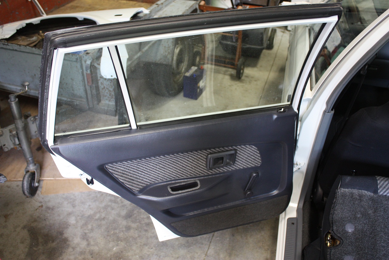

Put the little windows in both sides and all the door rubbers, window rubbers and silicone sprayed all the tracks so they glide better.

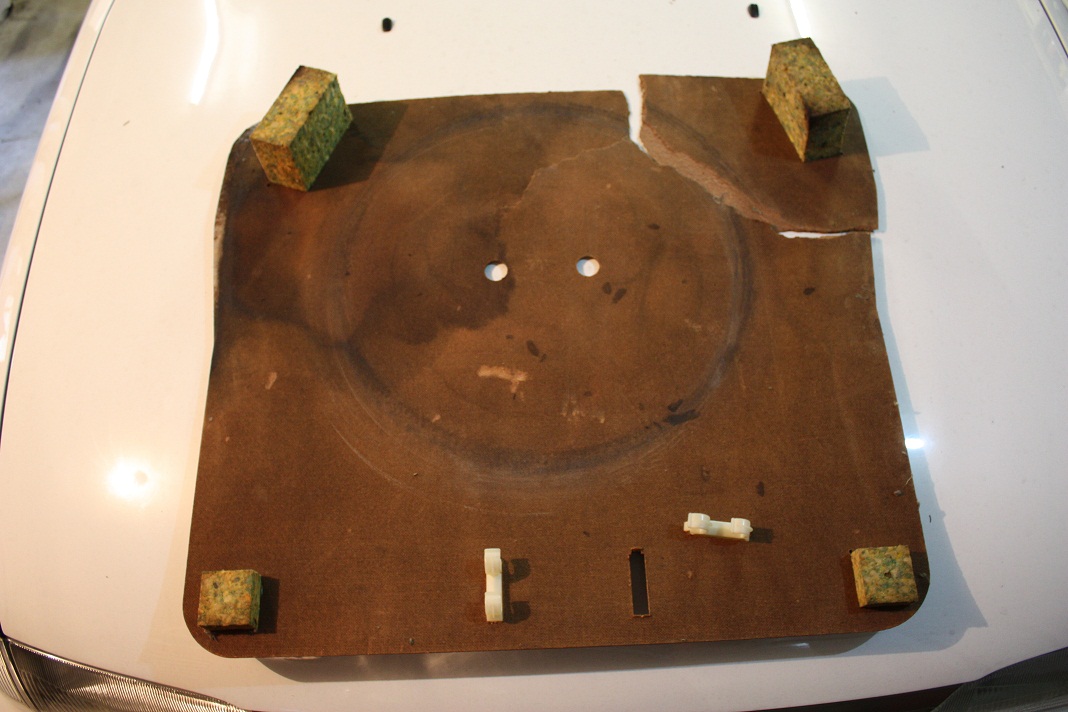

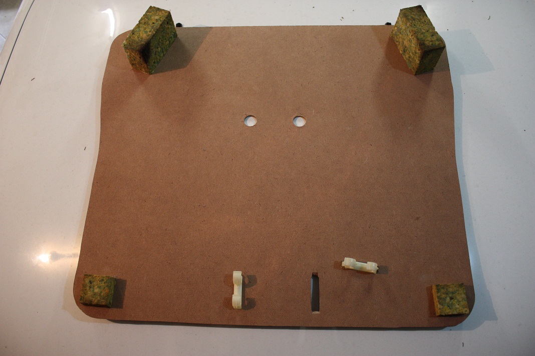

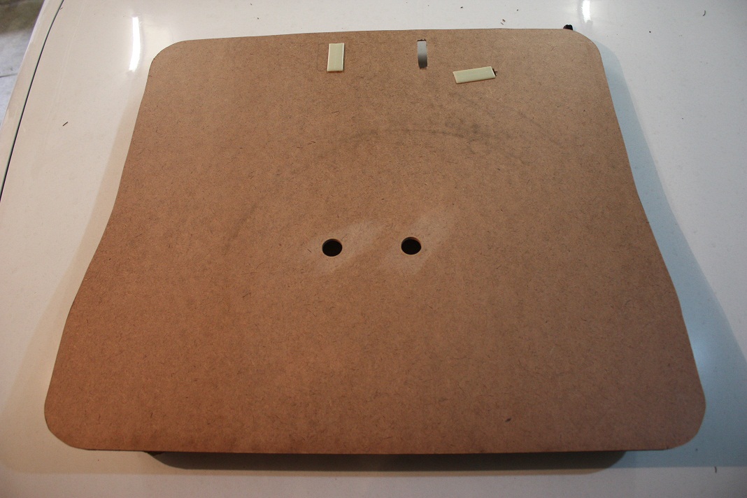

So got a little bit of wood work happening today and remade the spare wheel cover because it was cracked, corner snapped off and was very warped.
Ended up doing it it 6mm masonite for some extra support. Nearly double the thickness of the original stuff.
Just got to get another tool clip for it.
Nice, those early model SX seats definetley look the part. I'm sure you'll sort out the Cigarette burn :wink: Now with the spare wheel cover arent they slightly contoured to suit the pressing of the floor? Yours seems very flat or are you going to just pop it in and then screw it down with the knob. Looks good regardless, better than the original wafer type!

Another tip with the boot floor -
Get some cardboard and scissors, some tape and a stanley knife. Make a template of the entire boot floor with cardboard cuts taped together. When it's at the desired shape, remove from boot and trace onto thicker sheeting (even 6mm masonite is plenty, keeps the weight down too). Cut out boot piece, then from that, trace out a trapdoor for the spare wheel. Hinge the trapdoor or simply make a subframe for it to sit against. I know it sounds like a lot of work, but it will give you a completely flat boot, and in the 92's, that's not the easiest to find wink.gif.
Car's looking fantastic mate!
Yeah the original has a slight contour so the one I made sits up a bit but all in all its not a problem.
Sounds like a good idea, it would look good to have a completely flat boot. :y:

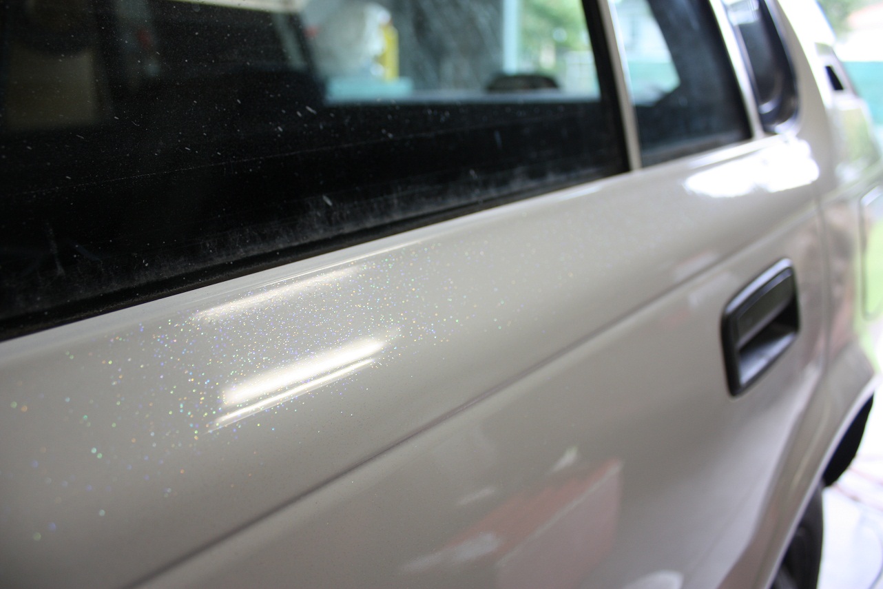

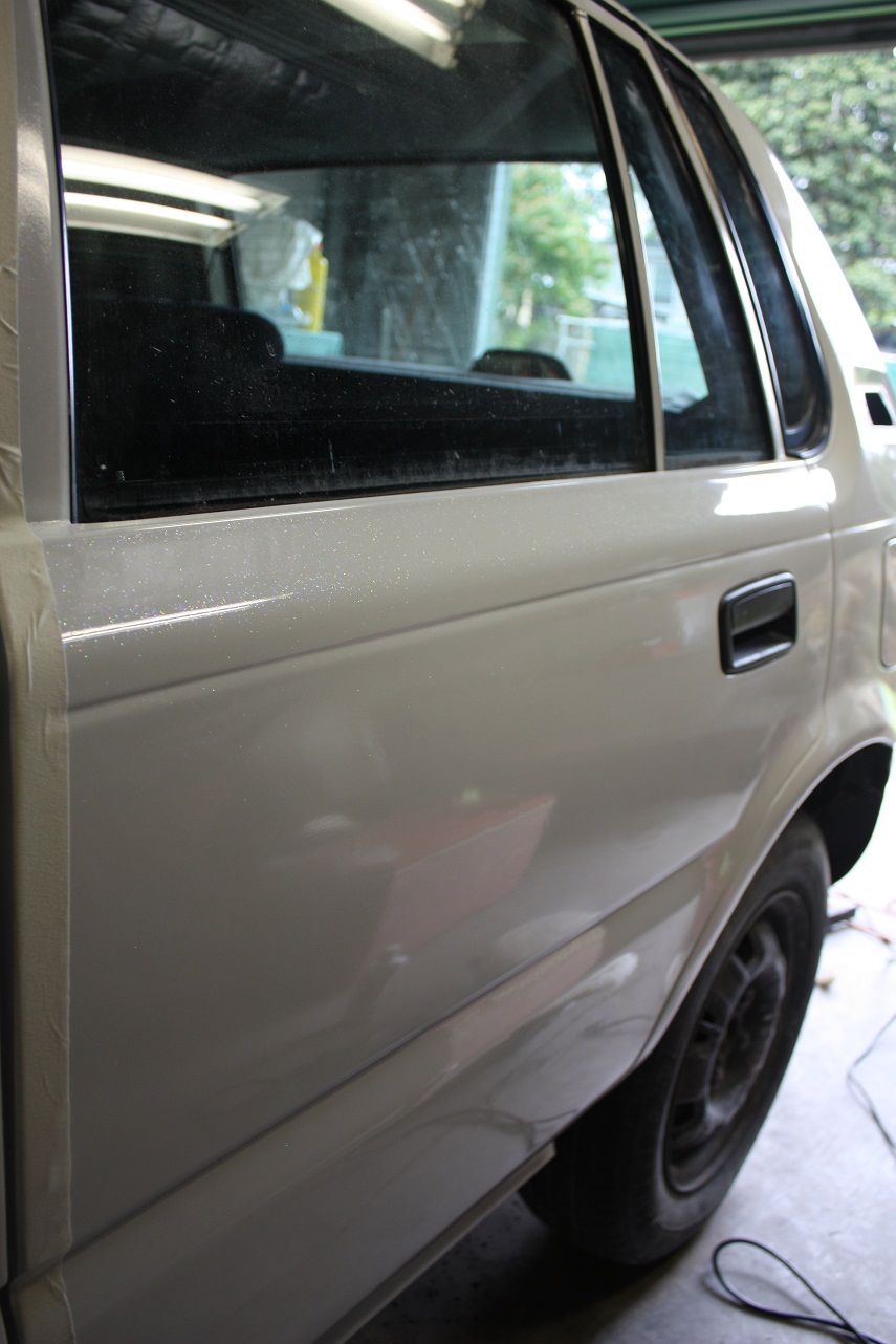

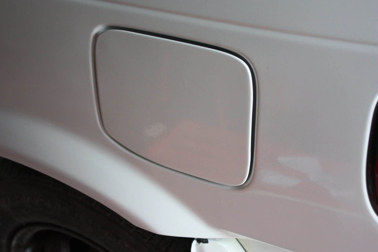

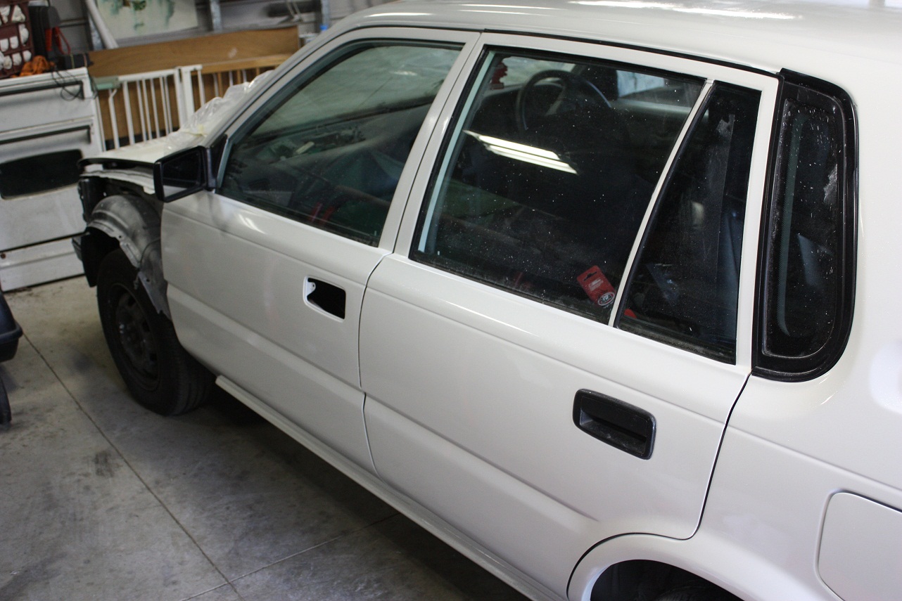

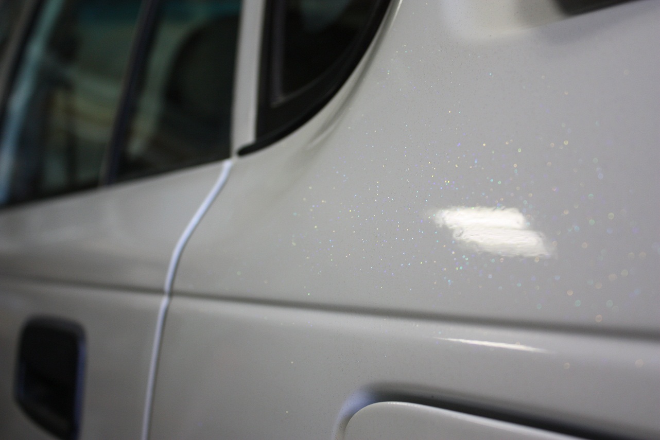

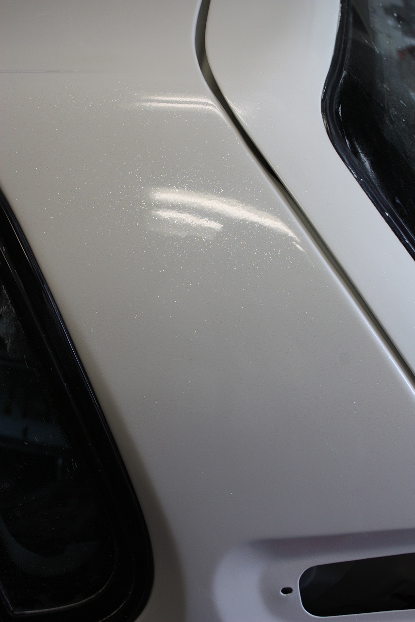

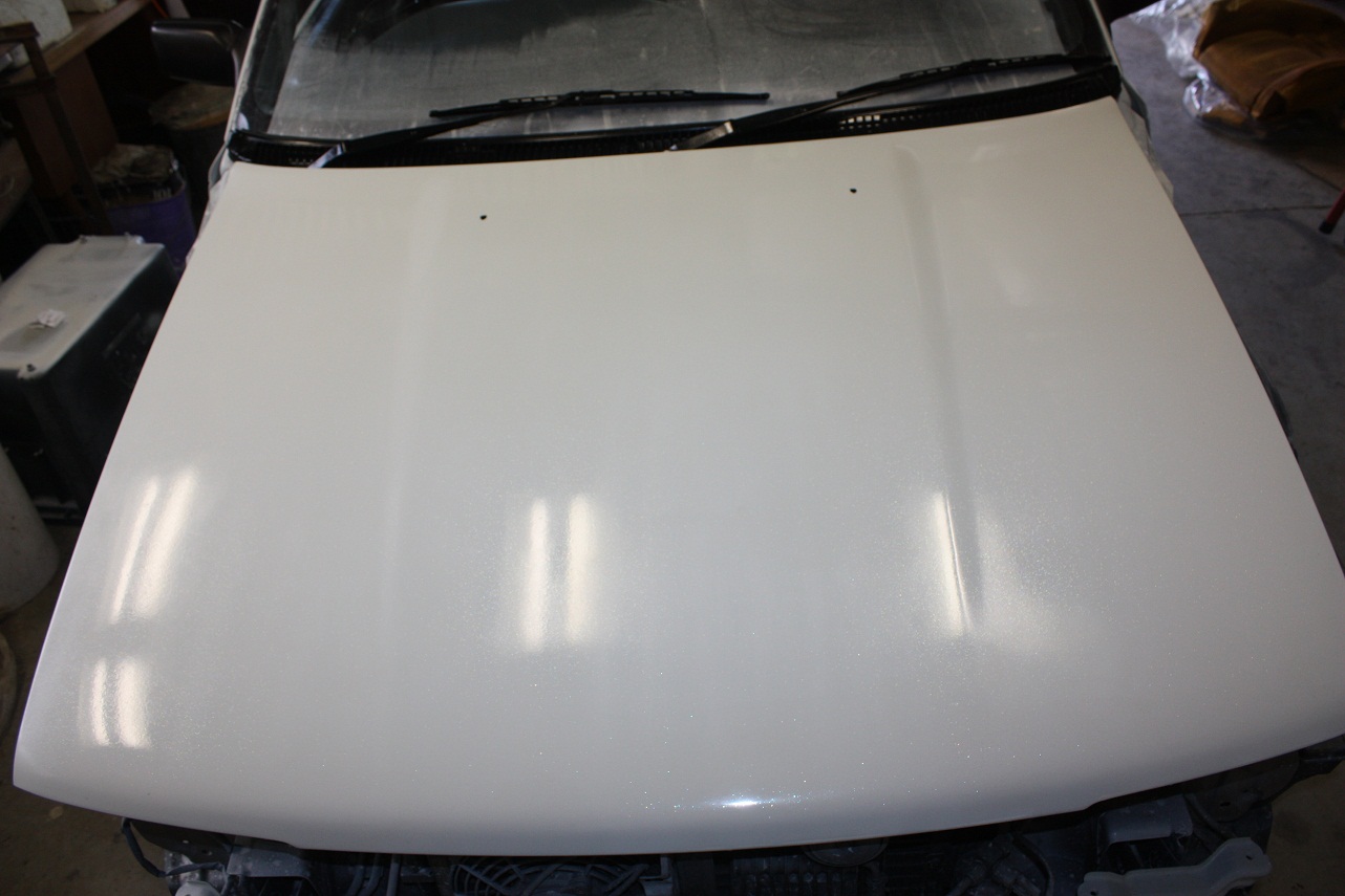

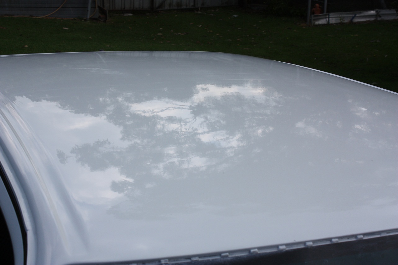

My buffer still hasn't arrived so I ended up borrowing a mates buffer because I couldn't wait any longer. So I ended up cutting and buffing the car and it came out really nice, after that I hand polished the car with super resin polish and then did extra gloss protection. You leave that stuff on for an hour and then hand buff it off and the gloss and smoothness is incredible.
All that's left is cut and buff the front bumper, polish and protect it and put a few odds and ends on.
Put the door cards and trims on, not happy with the little ash tray parts on the trims so going to source out some better looking ones.

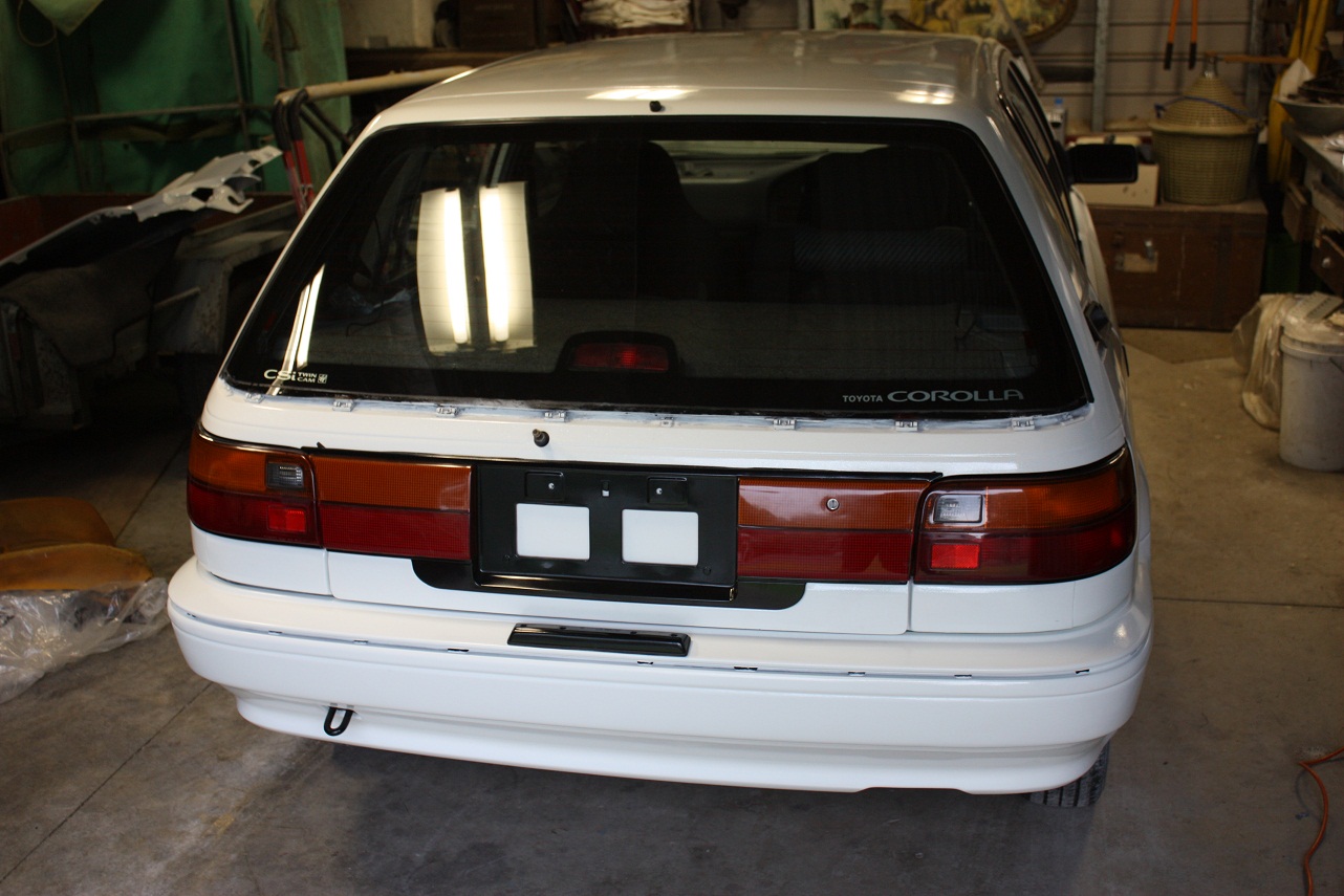

Got the rear hatch garnish on after spaying gloss black to match. Not happy with the rubber seal at the back how it sticks up so I will try and get a new seal or a better condition seal.

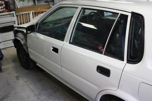

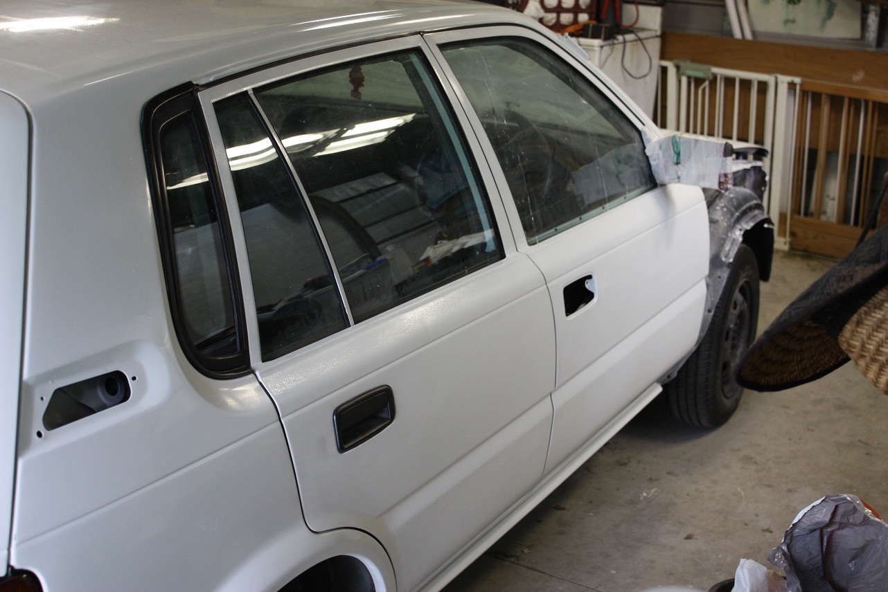

Few shots after cut and buffing

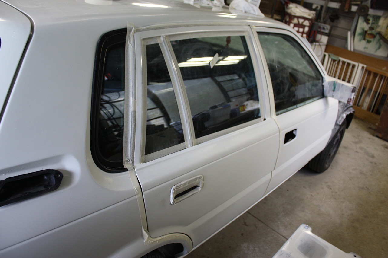

I mask up each door when buffing so I don't burn through any corners or edges, not buffed yet.
Left side complete
Time for the right side
Only run I get in the paint is inside the right grille...luckily you don't see it because its covered.
After hand polish and gloss protection
Rear bumper attached and cleaned back window

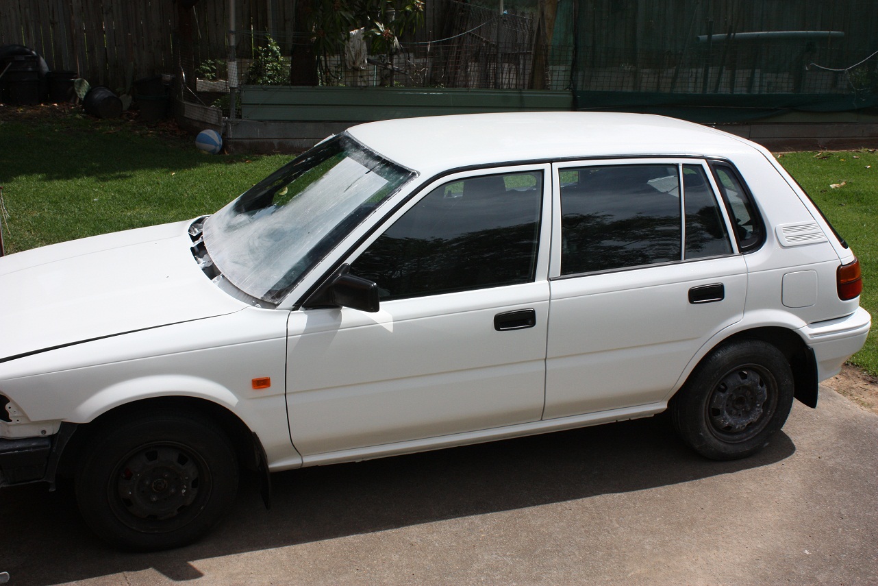

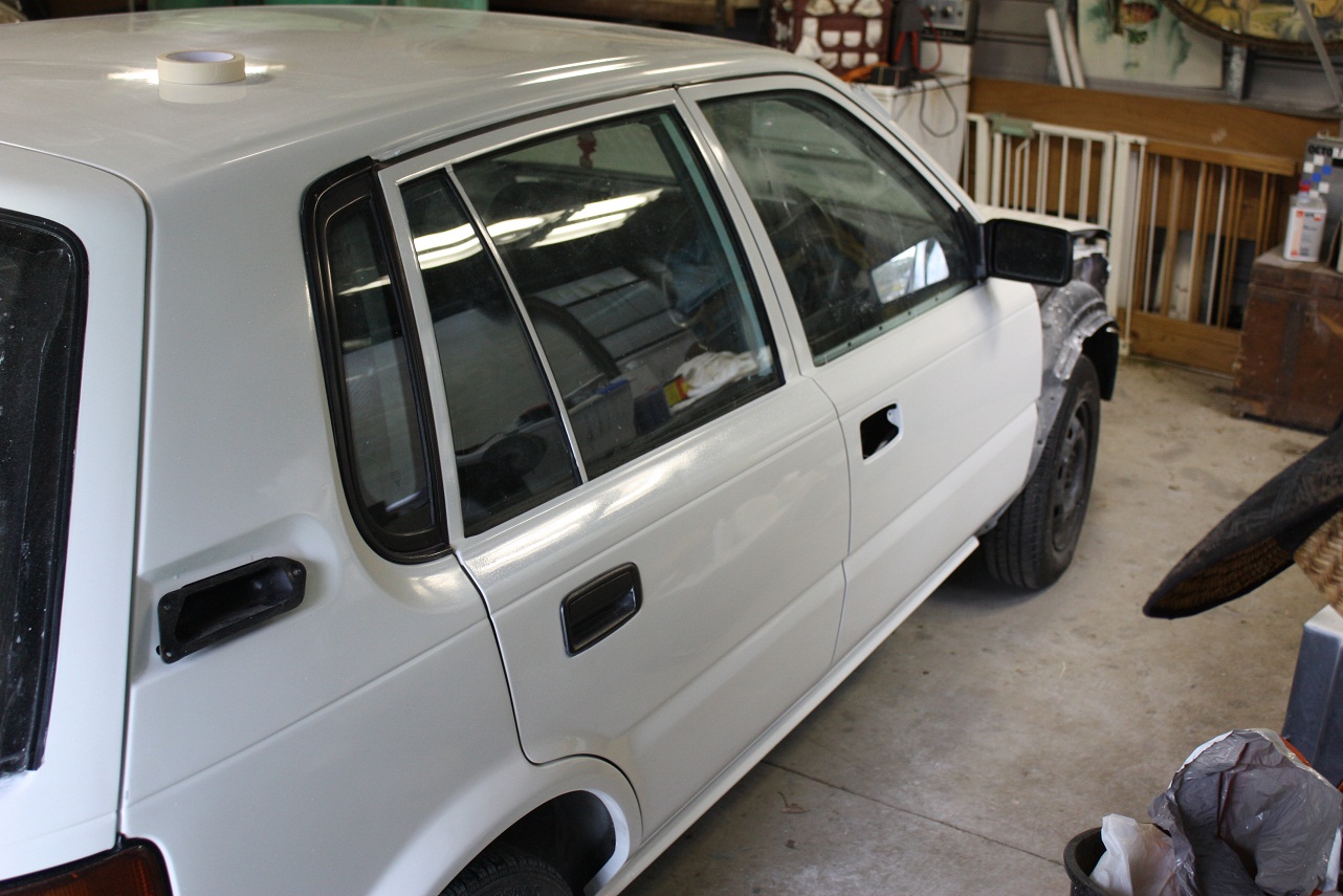

Just finishing up the corolla getting it ready for blue slip next week some time.
Got the quarters and mud guards on and put the side grilles on. Had to remove pretty much all the plastic from the rear just to put these grilles on because they screw is from behind.

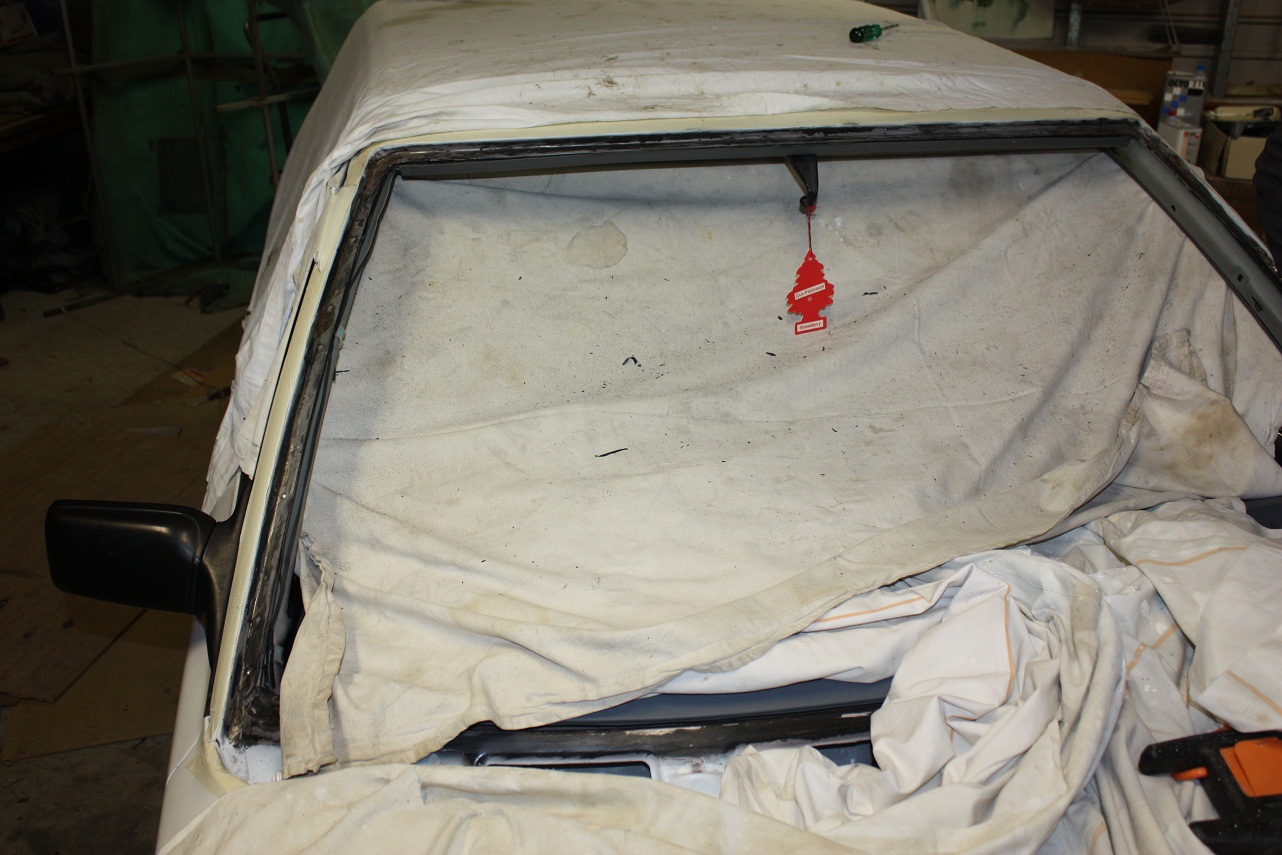

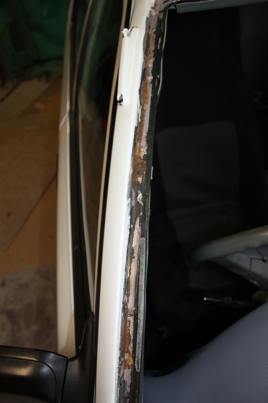

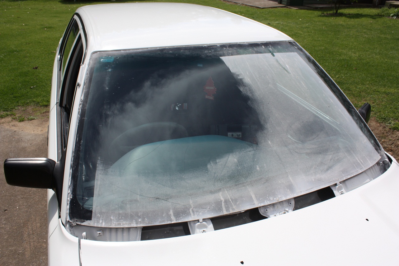

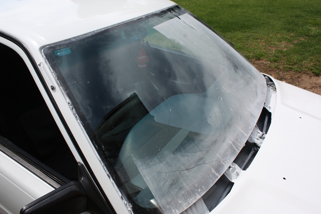

Some pictures of the front windscreen before the new one gets put in.
post-10479-0-97031800-1318473372_thumb.jpg post-10479-0-67172800-1318473384_thumb.jpg

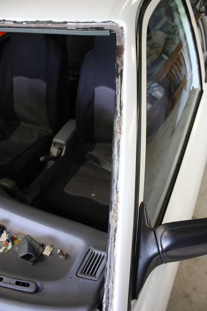

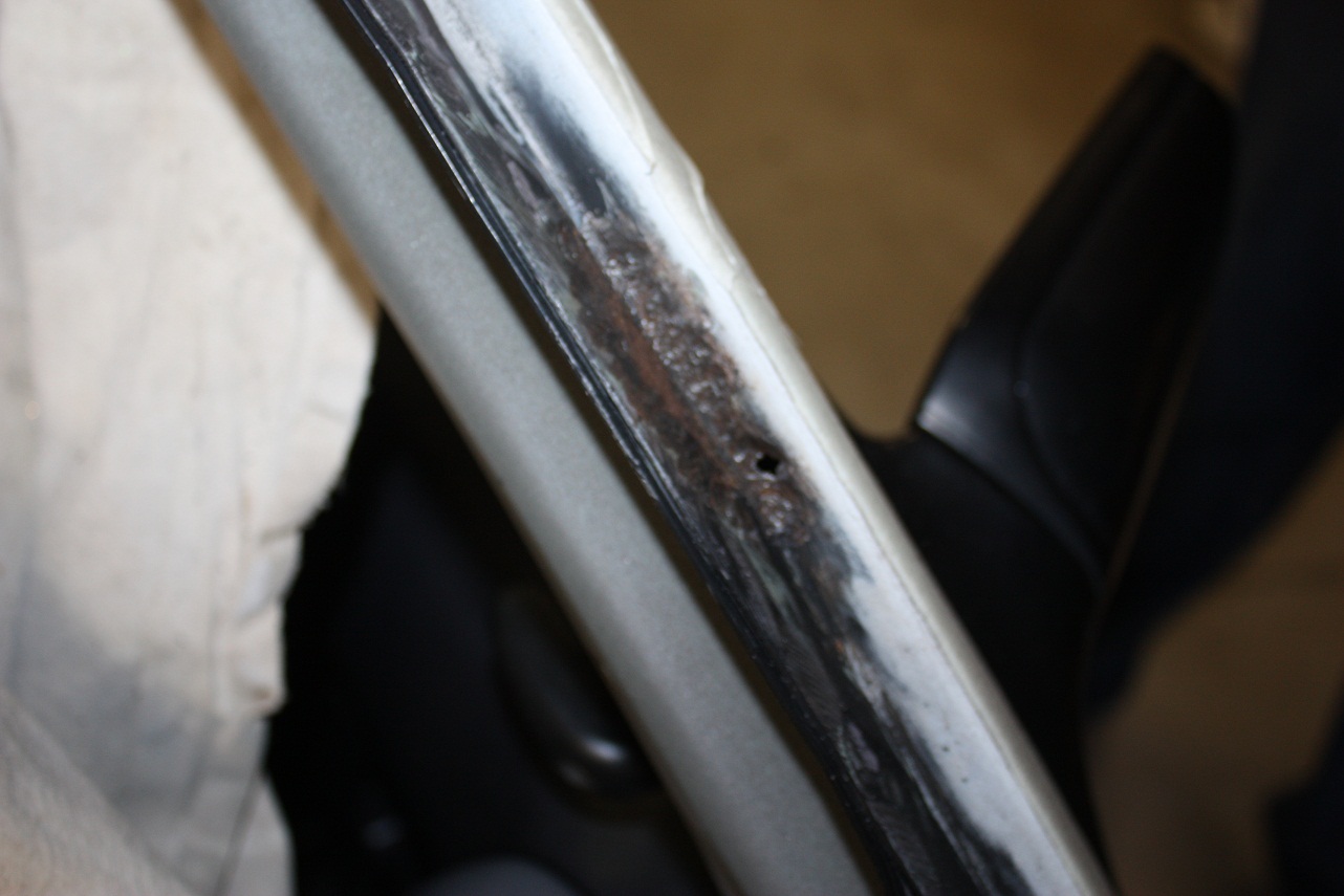

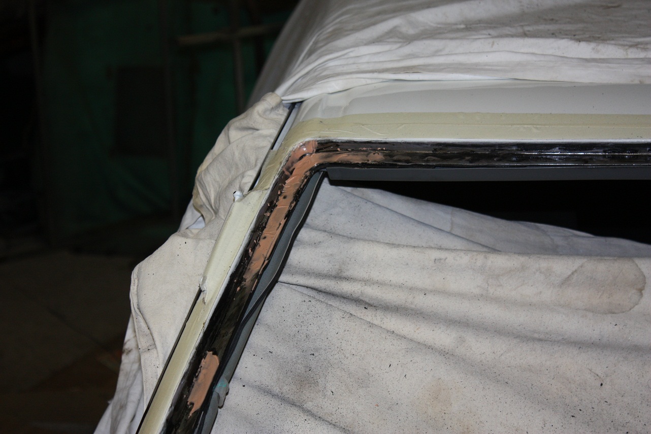

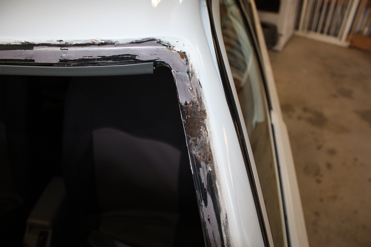

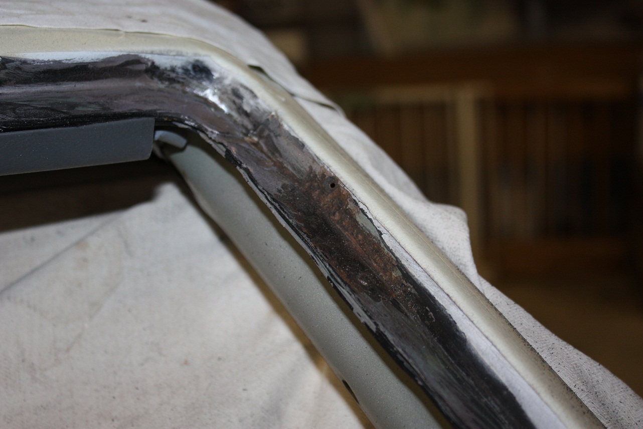

Well the guy came and removed the front windscreen and we found rust underneath it. So he left it and I told him to come back tomorrow and it will be ready and prepped for him to put it in.
post-10479-0-34132300-1318473410_thumb.jpg post-10479-0-41172100-1318473421_thumb.jpg post-10479-0-61493200-1318473457_thumb.jpg

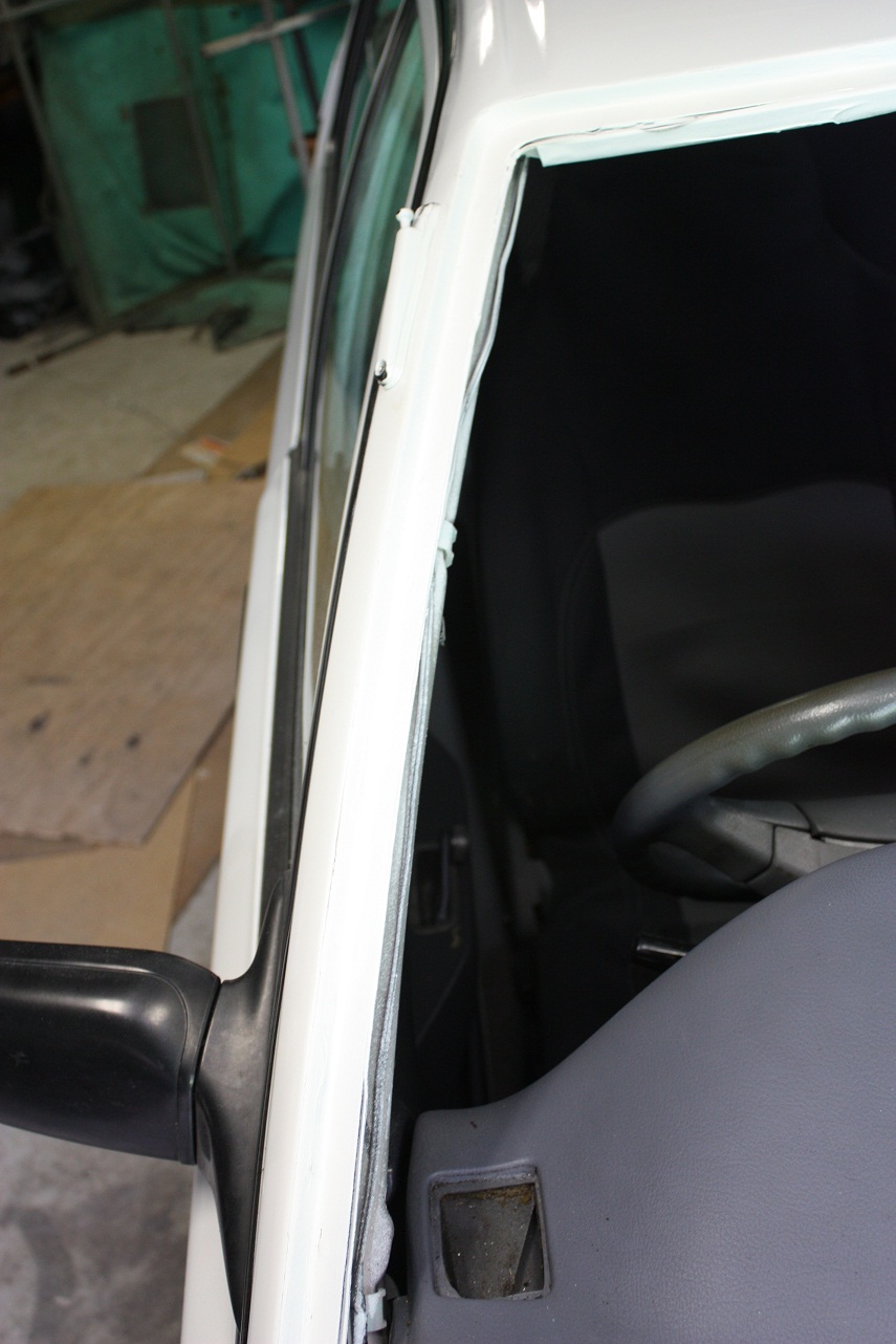

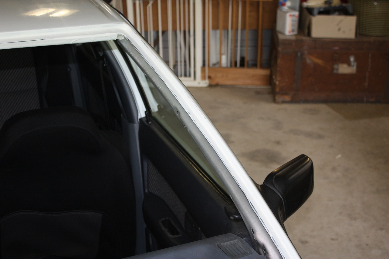

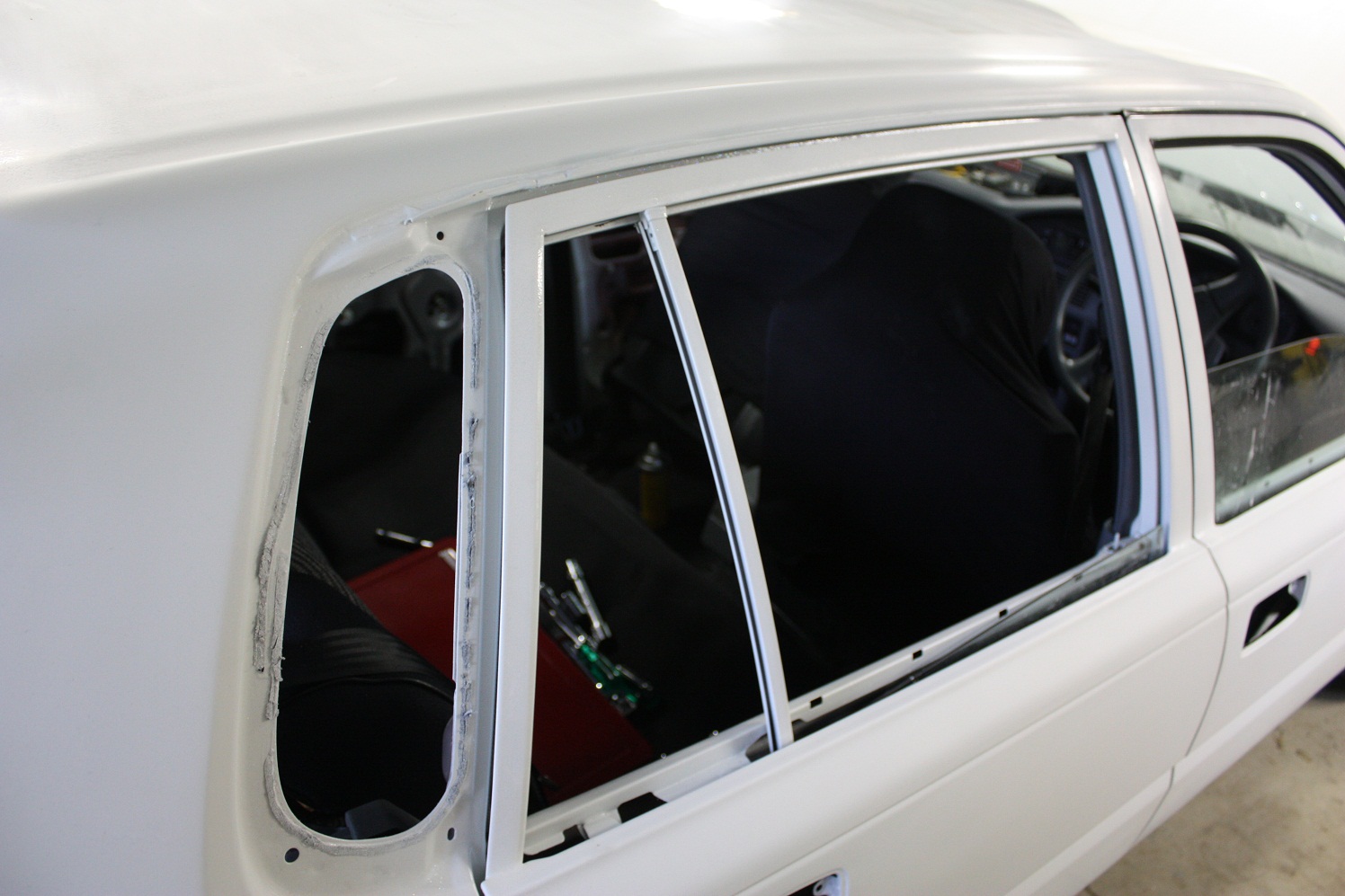

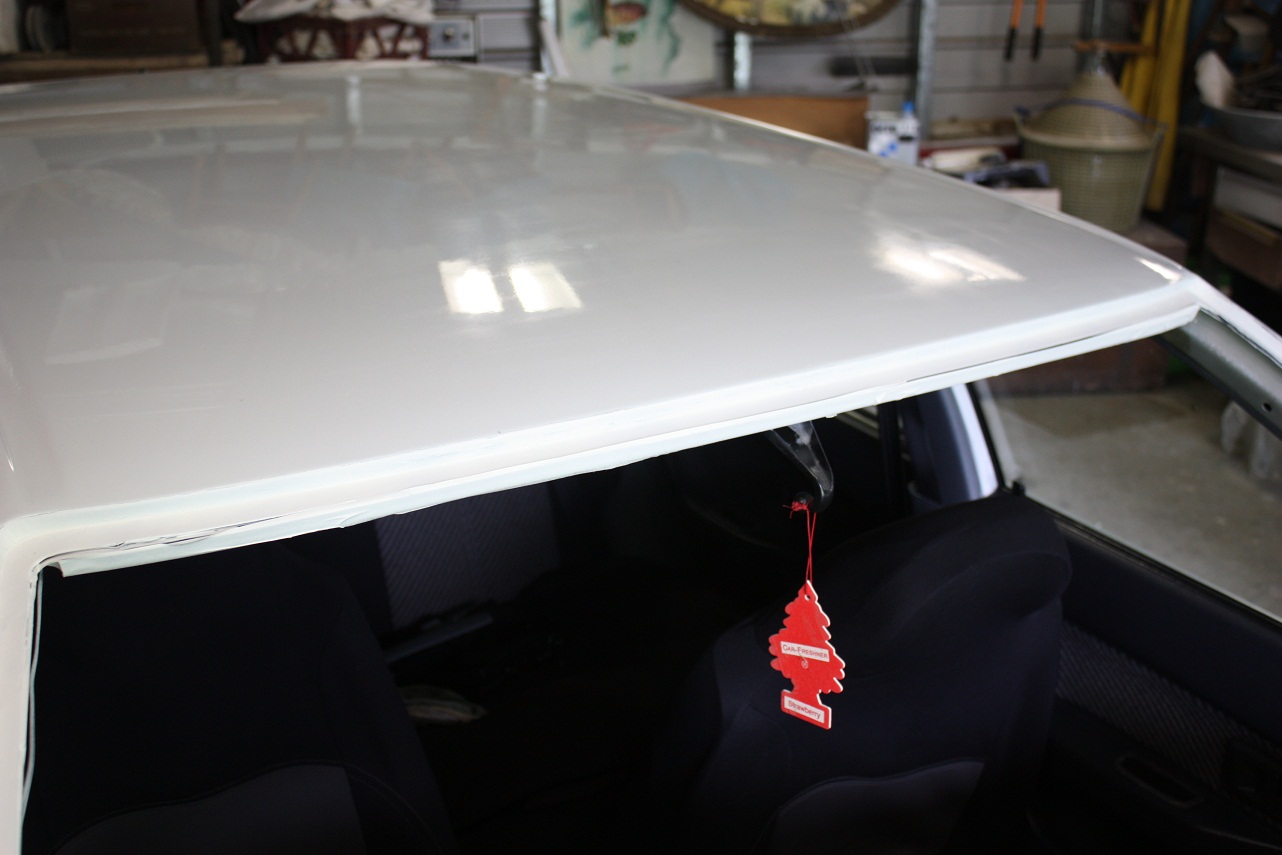

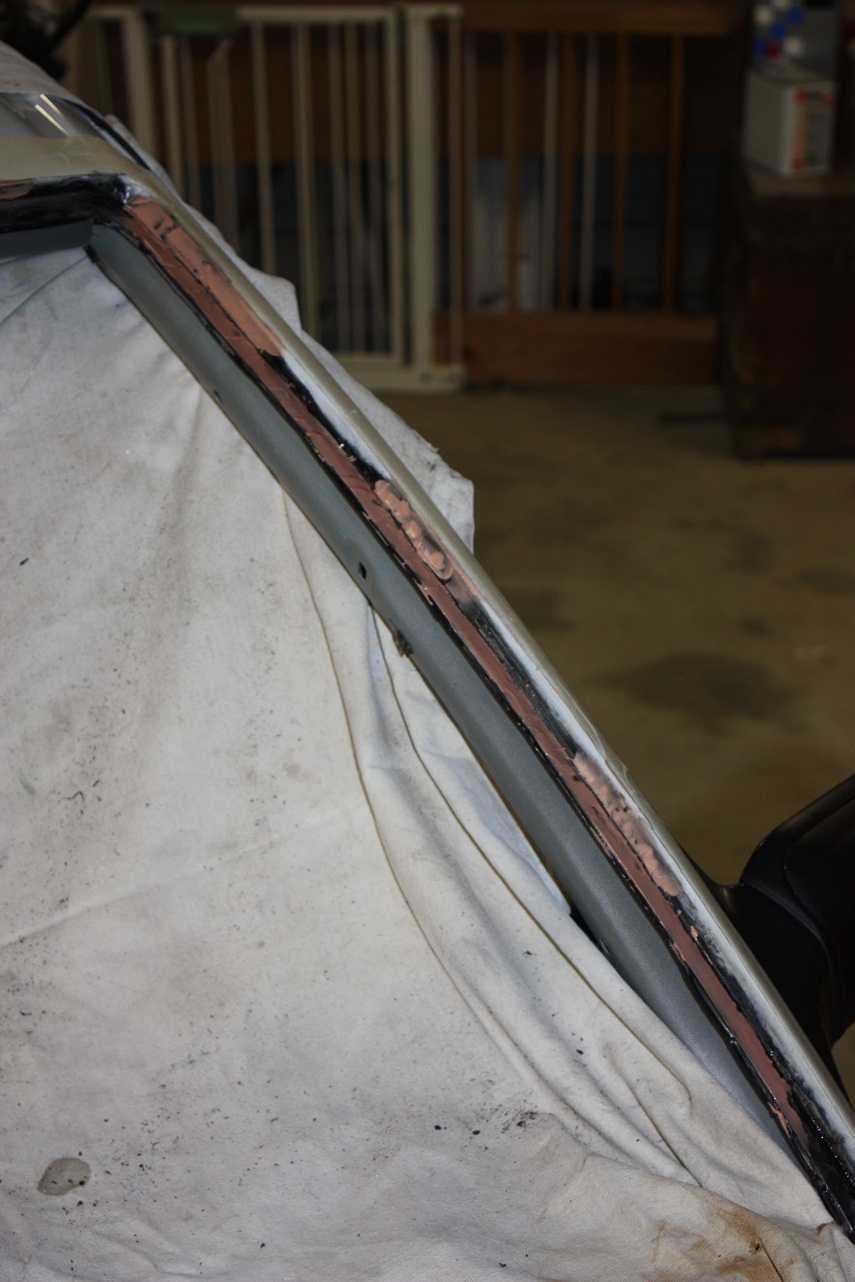

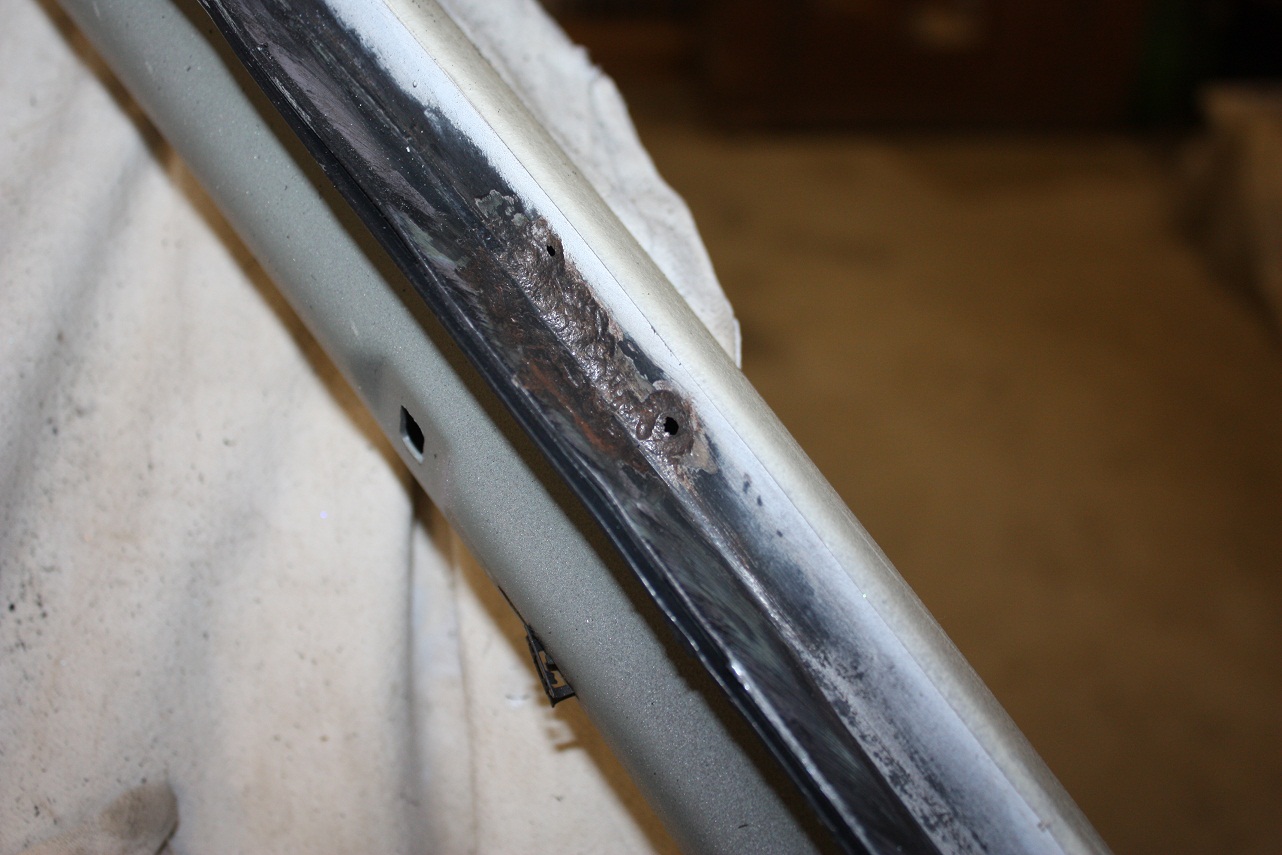

Got to work and masked off the windscreen and started to grind off the the rust and uneven areas. Then used the wire brush on the pitted area that couldn't be reached with the angle grinder.
After all that it revealed 4 small holes from were the rust has eaten through. So I rust treated the the hole windscreen area.
post-10479-0-13137500-1318473514_thumb.jpg post-10479-0-81193600-1318473526_thumb.jpg post-10479-0-09933200-1318473545_thumb.jpg post-10479-0-39750800-1318473573_thumb.jpg

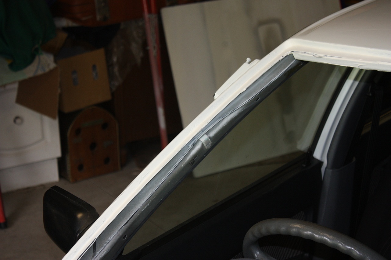

They were to small for me to get the welder in there and I don't have the correct welder for the job so decided to just bog up the holes because they where small holes.
post-10479-0-66967800-1318473783_thumb.jpg post-10479-0-27035400-1318473797_thumb.jpg

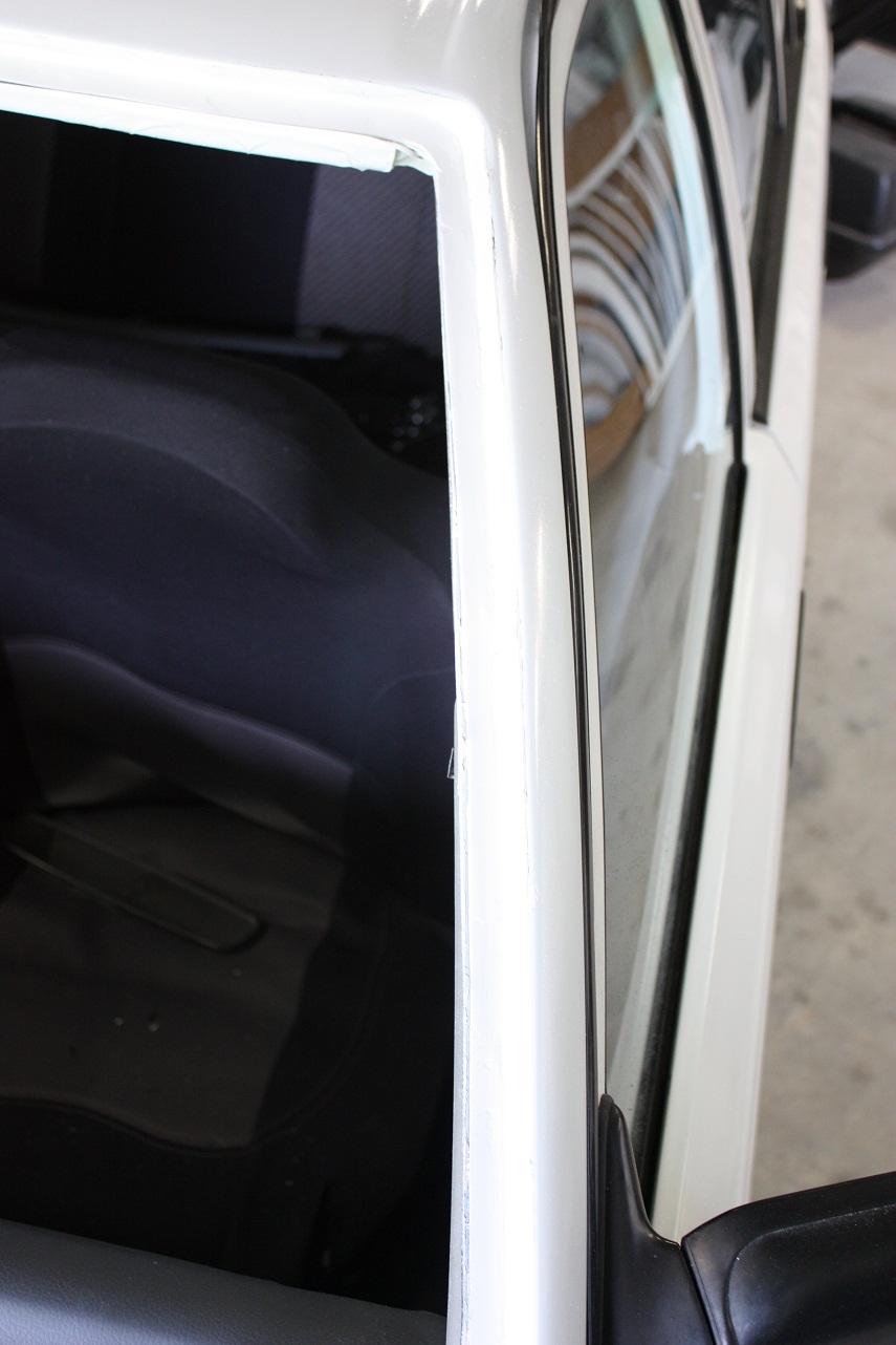

Sanded off the bog and white primed the seal area.
post-10479-0-08418100-1318473835_thumb.jpg post-10479-0-31460300-1318473846_thumb.jpg post-10479-0-39757700-1318473858_thumb.jpg post-10479-0-87095700-1318473868_thumb.jpg post-10479-0-77600300-1318473878_thumb.jpg

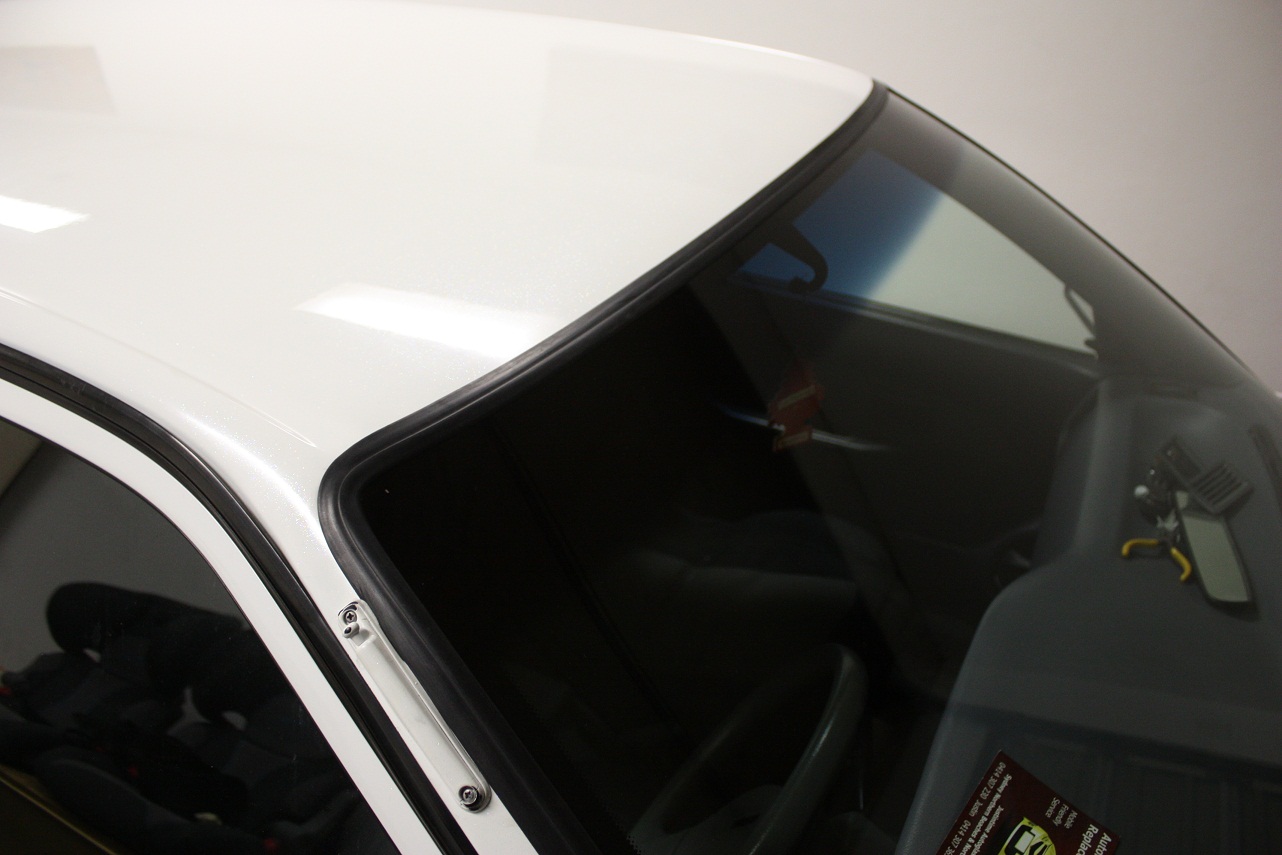

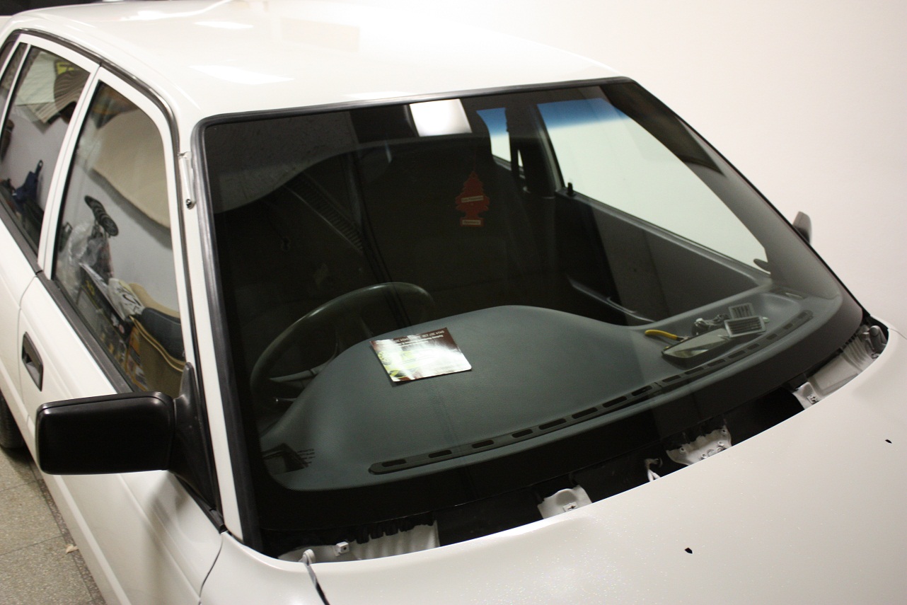

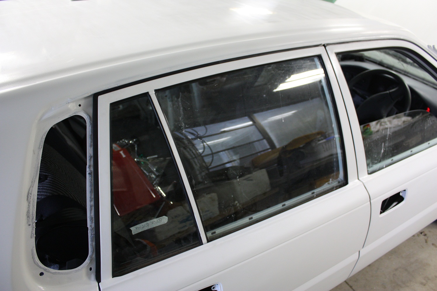

Guy came this afternoon and put the window in.
1 step closer to rego! can't wait to get her on the road.
post-10479-0-94715000-1318500830_thumb.jpg post-10479-0-15011100-1318500846_thumb.jpg
The guy that came and did my windscreen, I would highly recommended him. He has done other friends cars in the past and they have never had a problem.

Thats more like it! Just as well the old screen was buggered so you could pull it out and clean under it. And that seal finishes it off nicely, top work :y: Have you come across the CS-X handle plasics?
