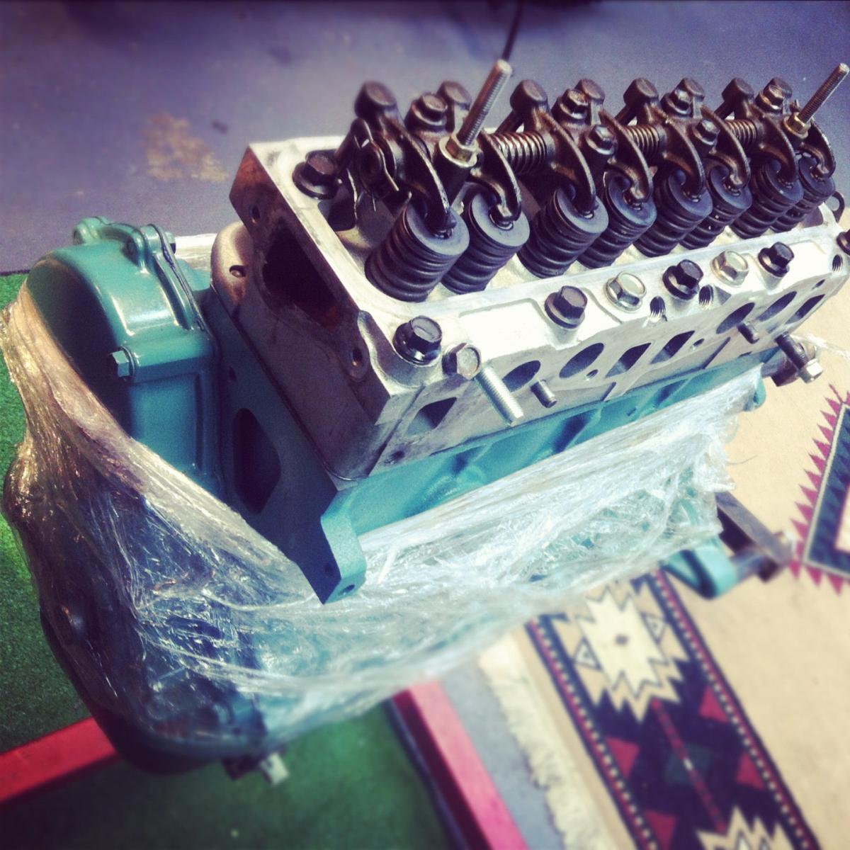

Hey, I've got a fully rebuilt 5K. I'm in the process of bolting on all the accesories. Now, i need to know whether to use bolts or studs with nuts to hold the Inlet and exhaust manifolds on. What do you guys like to do with yours? And what do you think is best? Cheers
Need advice.. Whats better for inlet or exhaust..... Studs with nuts .......or just bolts mo studs I'd personally feel better with using studs and bolts. UPDATE: Picked up some stuff today. - rocker cover gasket - spark plugs - oils - paint for extractors (surprise for colour to come) Parts coming are thermostat housing, new water pump, new leads! Getting there, should be running by next tuesday as thats when i get my cast off and can drive again. Yeeahhh buddy. And a new wheel colour is coming also! Peace out.
Yeah flat top 5K. Can't wait for it to be in and running haha.
Engine time... Need to get new bits, - Thermostat Housing - Water Pump - Spark Plugs + leads - Rocker cover gasket - Inlet/exhaust gasket - Exhaust/Inlet studs and bolts -Spakr plug seals HOPEFULLY running by next week
