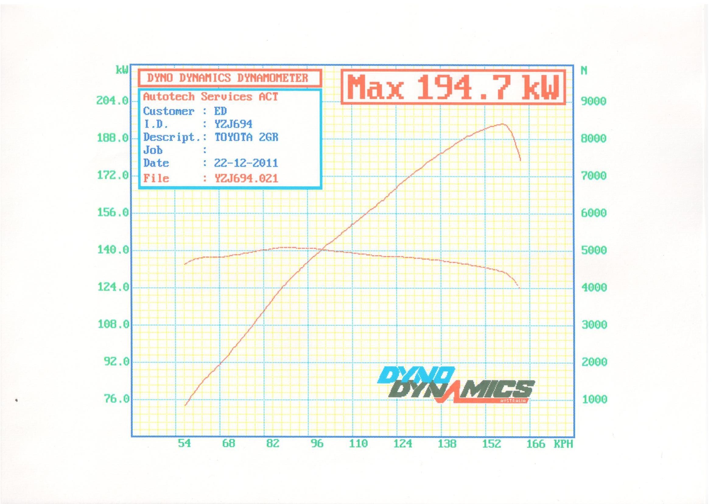

  1. I'm using a Celica/Corona 2S bellhousing - all we had to do was weld an extra tab on and helicoil a hole already in the block and she bolted right up :) Hardest part was mounting the starter into the bellhousing, as there's nowhere on the block to mount it Power's great for most things I've ried so far, it still struggles a bit with fourth gear stuff around Eastern Creek, but we've got ITB's and cams on the way to fix that hopefully :) I haven't weighed it, but it sits higher on the springs than it did before. No steampipe manifold, turbo and plumbing helps bring the weight down. No modifications to firewall or tunnel :) It all fits

  7. So had it at Powercruise on the weekend and foudn out that: - In the wet, it'll happily smash limiter in 4th anywhere you like, and almost pull fifth around turn 12 - In the dry, it runs out of revs in third and the RPM drop to fourth means I have to straighten up before I can get enough speed to turn 4th sideways... damn fast though We're going to lift the limiter to 8000rpm to see what she'll do http://youtu.be/NNw0FPhcJhs
