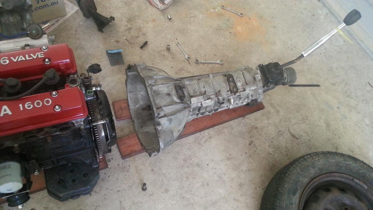

  1. Thanks Dashills, I thought that might be the case. I didn't want to go through the trouble of putting it in the car if it was a seal. I managed to salvage most of the oil fortunately
  2. Hey guys, I have made a rookie mistake (I think) by putting gearbox oil in a T50 before installing it on the car. The oil ended up spewing out of the driveshaft end and made a nice puddle on the floor. Is this supposed to happen? I assume the driveshaft yoke might stop this from happening when installed on the car or maybe a seal is gone. This is my first engine conversion so any advice is appreciated! Thanks

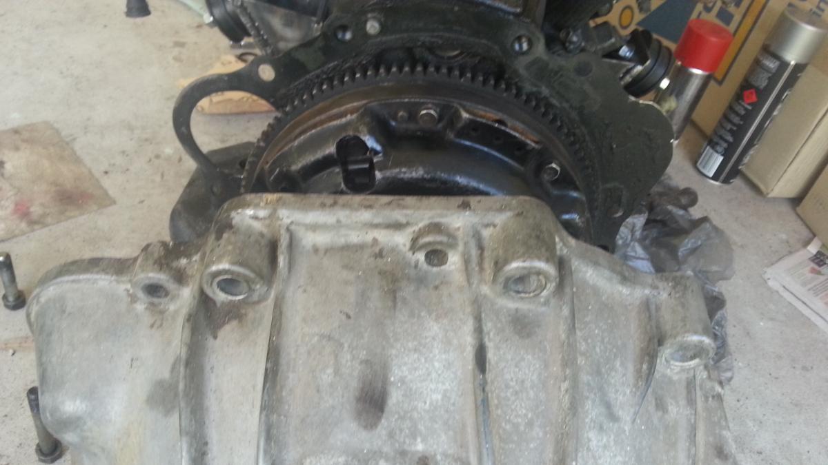

  3. That seems right... If only it wasn't so hard to find A-series bell housings :bash:
  4. Hey everyone, I just tried to mount the 4AGE to a T50 box. Only the two top bolt holes line up with those on the engine. Also there is a pin that lines up the engine, but the hole for that pin on the gearbox is on the opposite side. Is this a JDM/ADM issue? I know they differ by having the clutch fork on the other side, but I was told that any T50 box will fit as long as the splines are the same. Will a different bell housing fix this problem? Any advice is greatly appreciated! Thanks!

  6. It will need a fair bit of grinding to make it fit and then i'm still not sure if it will fit/be structural. I'll see how I go without it so I can use the car to run about in for a while.
  7. That clears up a lot of head scratching. Thanks!
