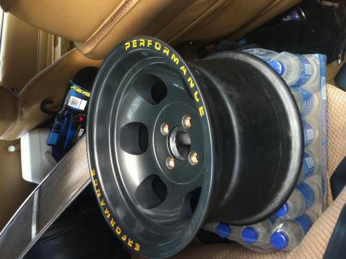

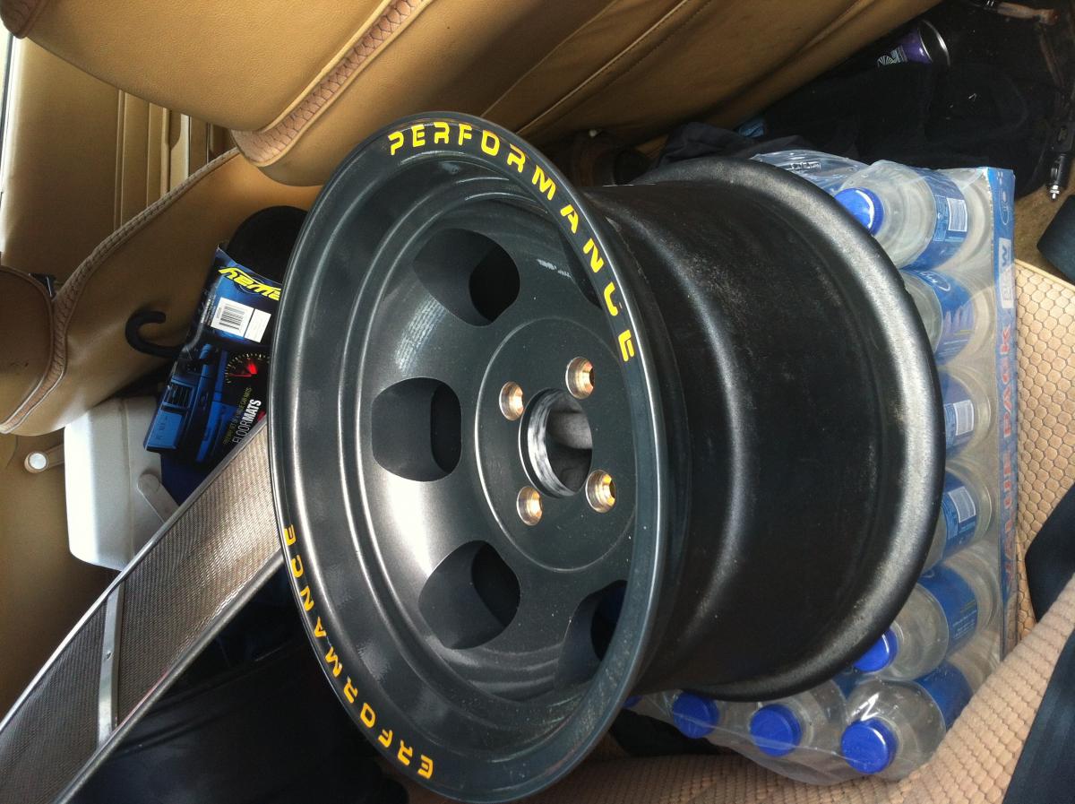

  5. Hey guys Managed to get my hands on a pair of these on the weekend, they are 13x8 performance spitfires Anyone ever seen onces like these before? Or know where I can get some. It looks as thought they came from factory like this as they have never been on a car Any help would be appreciated
