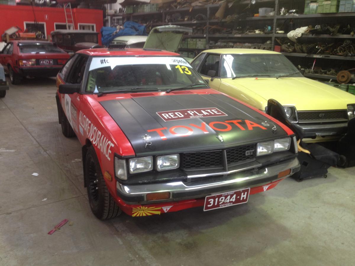

  2. any more info on this mate , keen to see another ra40 rally car out and about ! , Here is our ra40 rally car

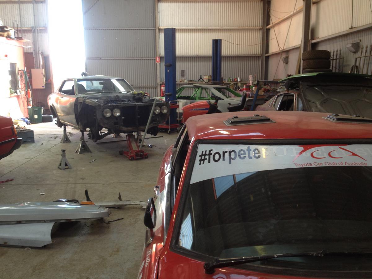

  11. so work begin within minutes on the grey car ! started stripping to get rid of the rust and dents . ][/size] even using Japanese newspaper fixing rust in sills and a skim of bog to get them perfect after welding . bit sad to see the rust had been filled with bog and painted over :/ so had to pull that all out and weld in some steel. also got a rear bob tail spoiler off ian which sets the rear end off nicely ! took a day off working on the car to go to classic japan ! heres dads rally car with the gt grill so spent about 3 weeks on the car getting it ready for primer will be painting the car a AMG Mercedes colour known as tenorite grey so that brings us up to date , have found a rear gt badge and gear knob just need a front gt grill now !
