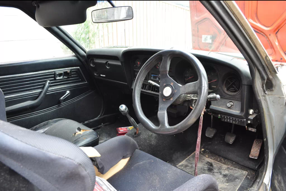

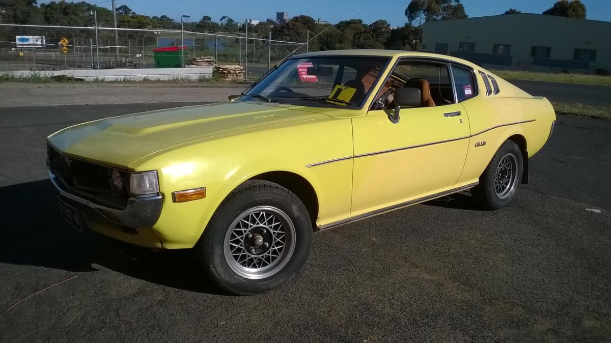

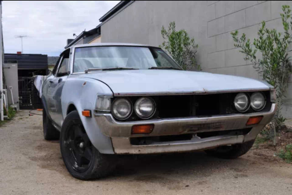

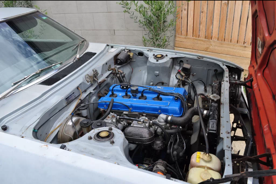

spotted it on ebay , turns out it was 5 minutes from home so a short drive over to the guys place to suss the car out , turns out he has had it for the last 16 years and it was his first car . The car has a rebuilt 18rg in it running on 45mm webers and running very sweet !

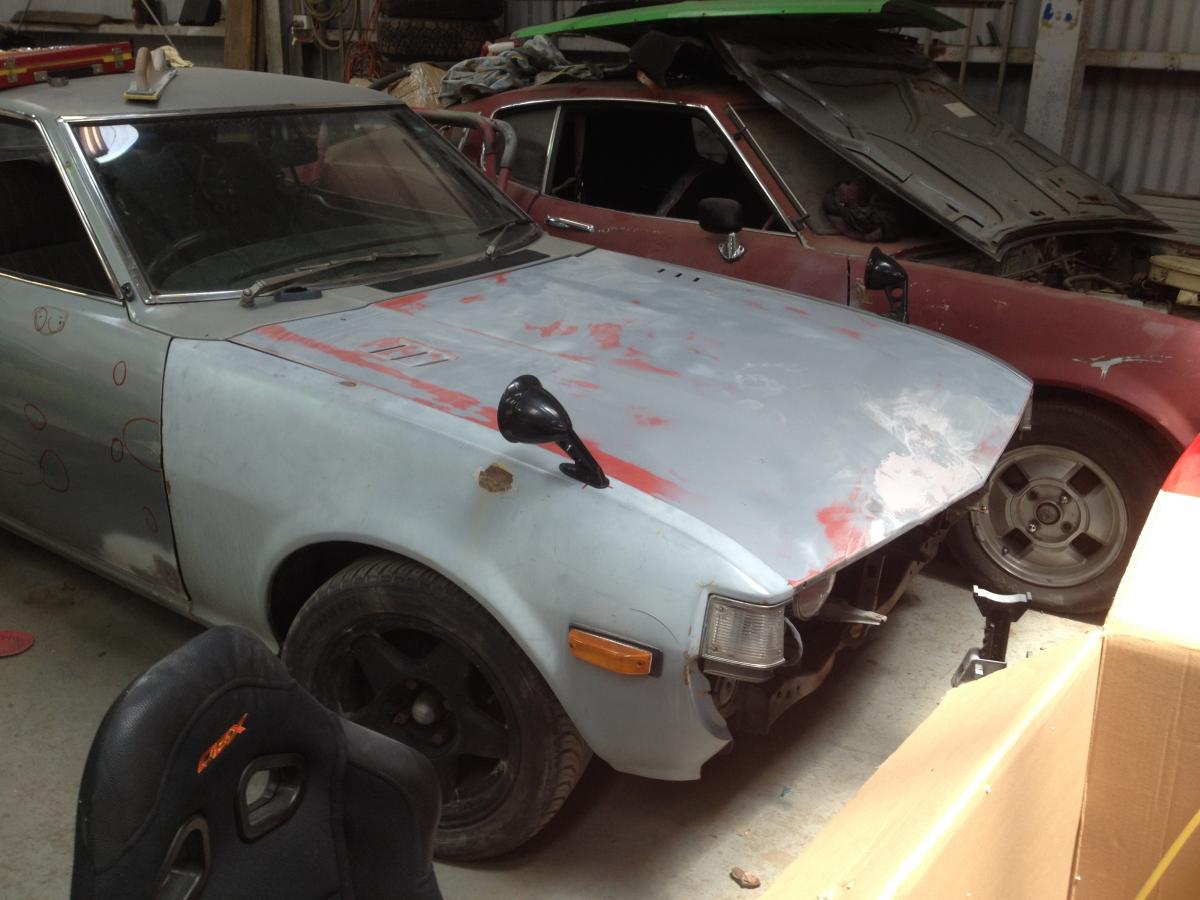

photos of the car when we got it
notice race seat , was used for some hill climb

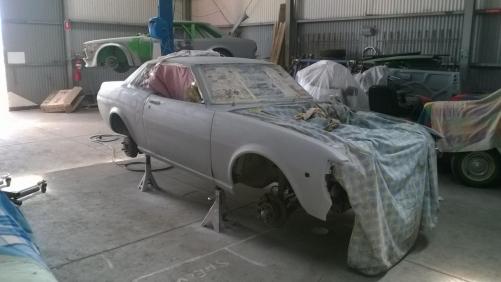

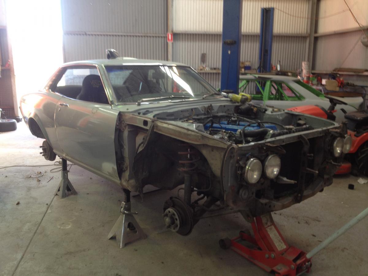

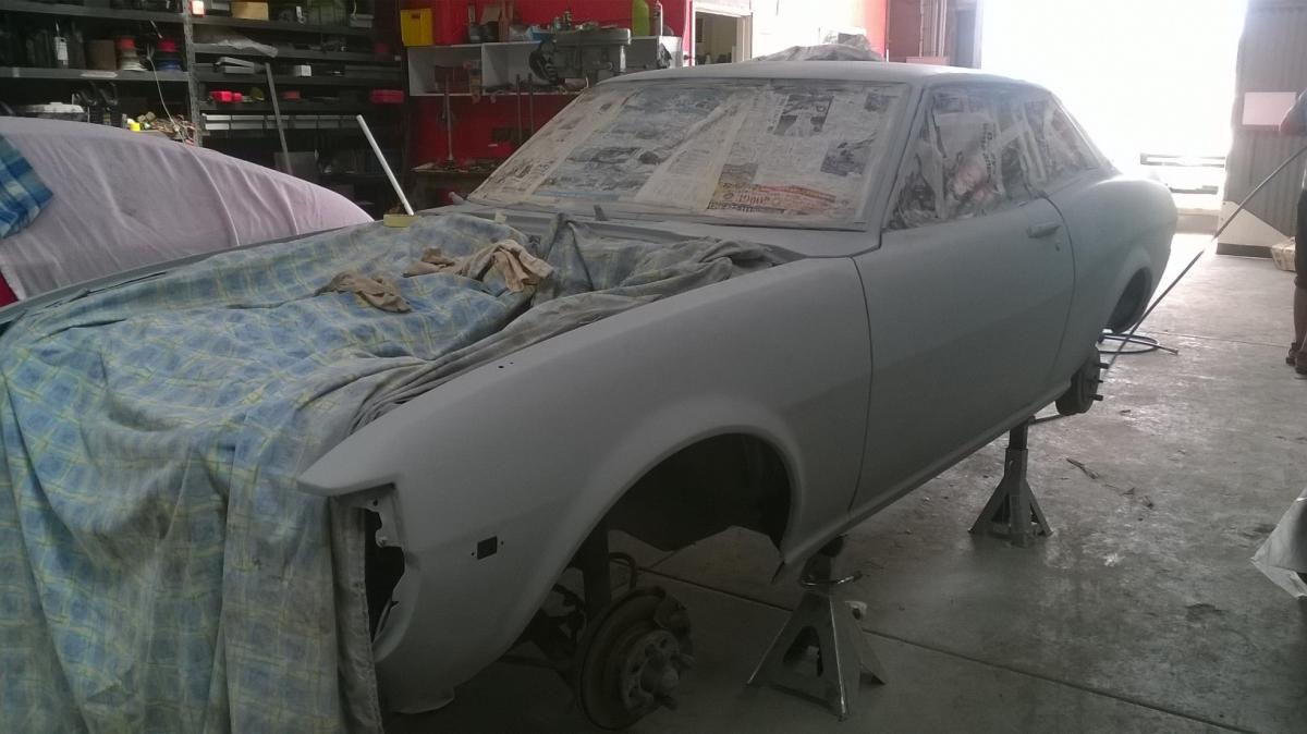

so work begin within minutes on the grey car !

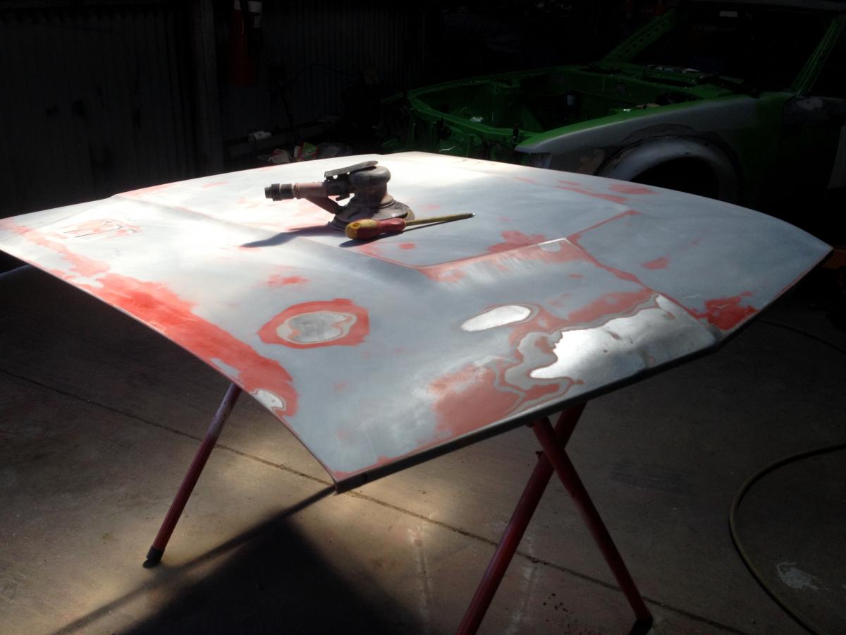

started stripping to get rid of the rust and dents .
post-17093-0-69417400-1419251176_thumb.jpg][/size]

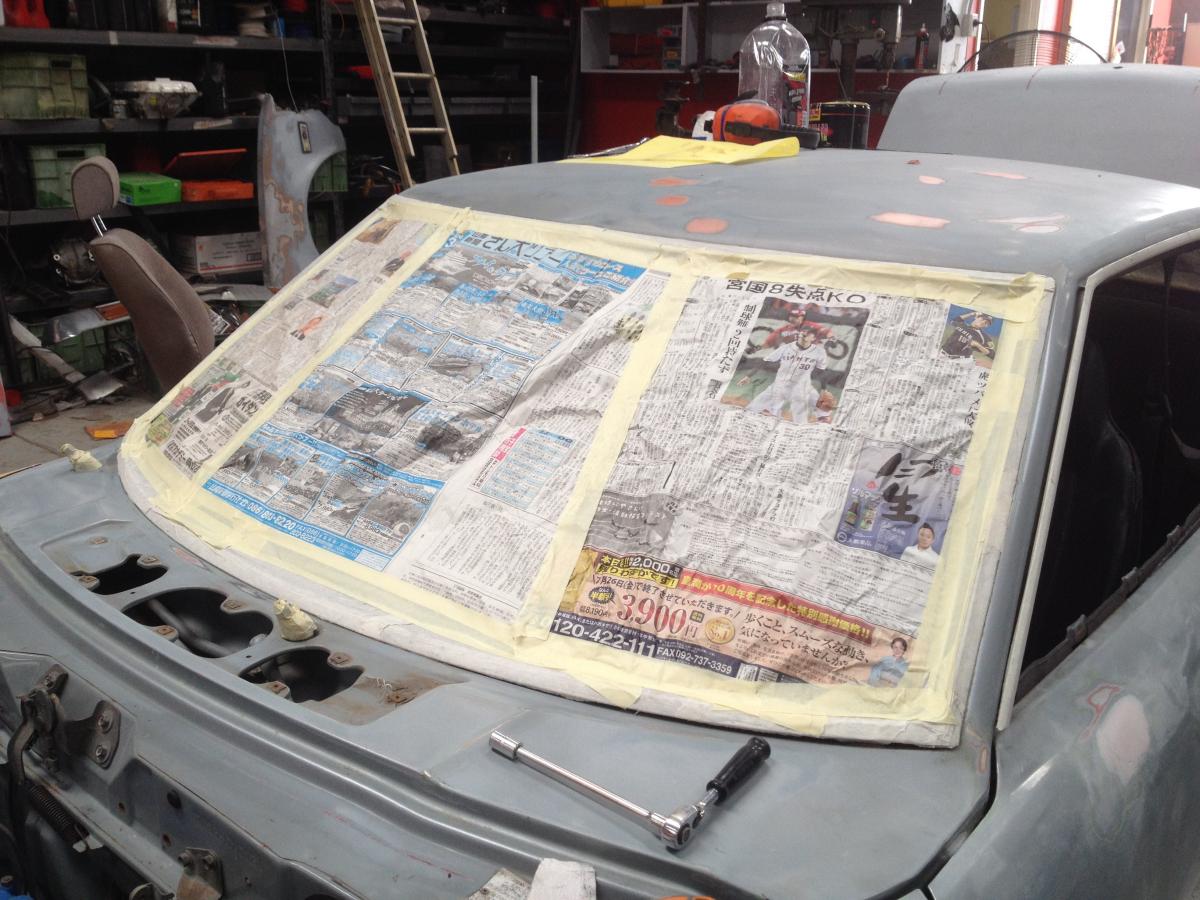

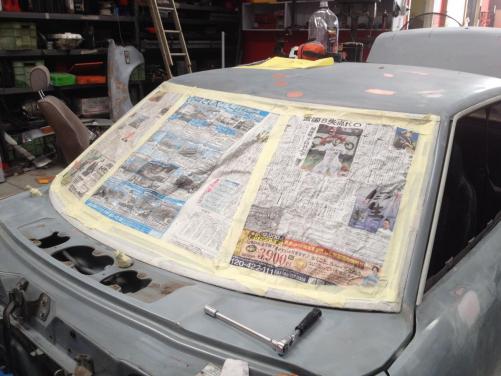

even using Japanese newspaper

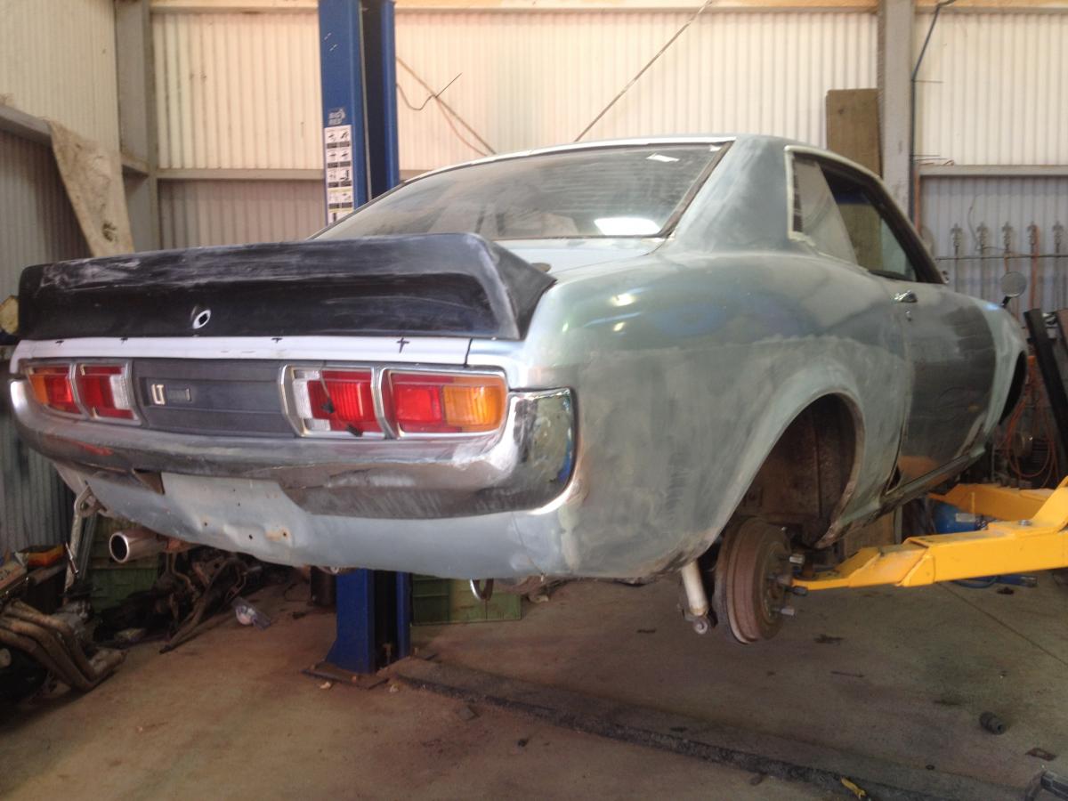

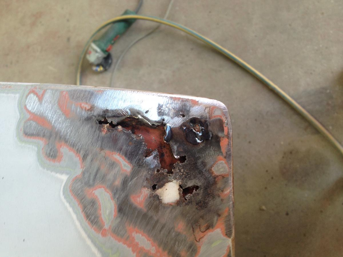

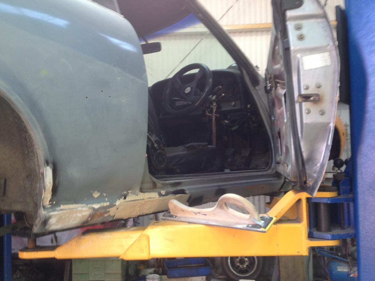

fixing rust in sills and a skim of bog to get them perfect after welding .
bit sad to see the rust had been filled with bog and painted over :/ so had to pull that all out and weld in some steel.

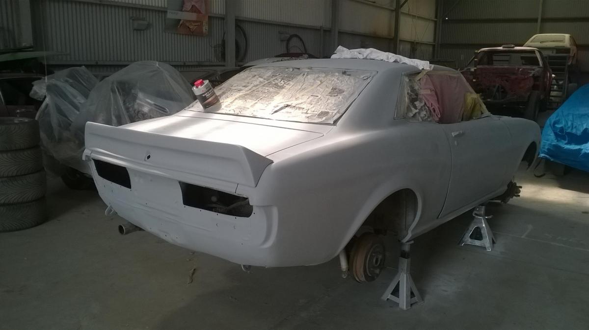

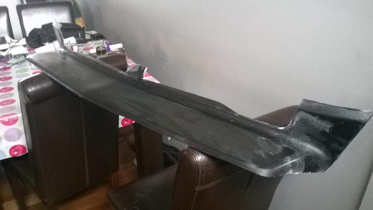

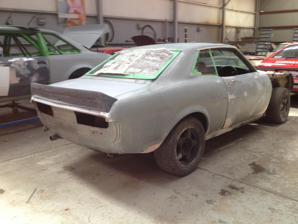

also got a rear bob tail spoiler off ian which sets the rear end off nicely !

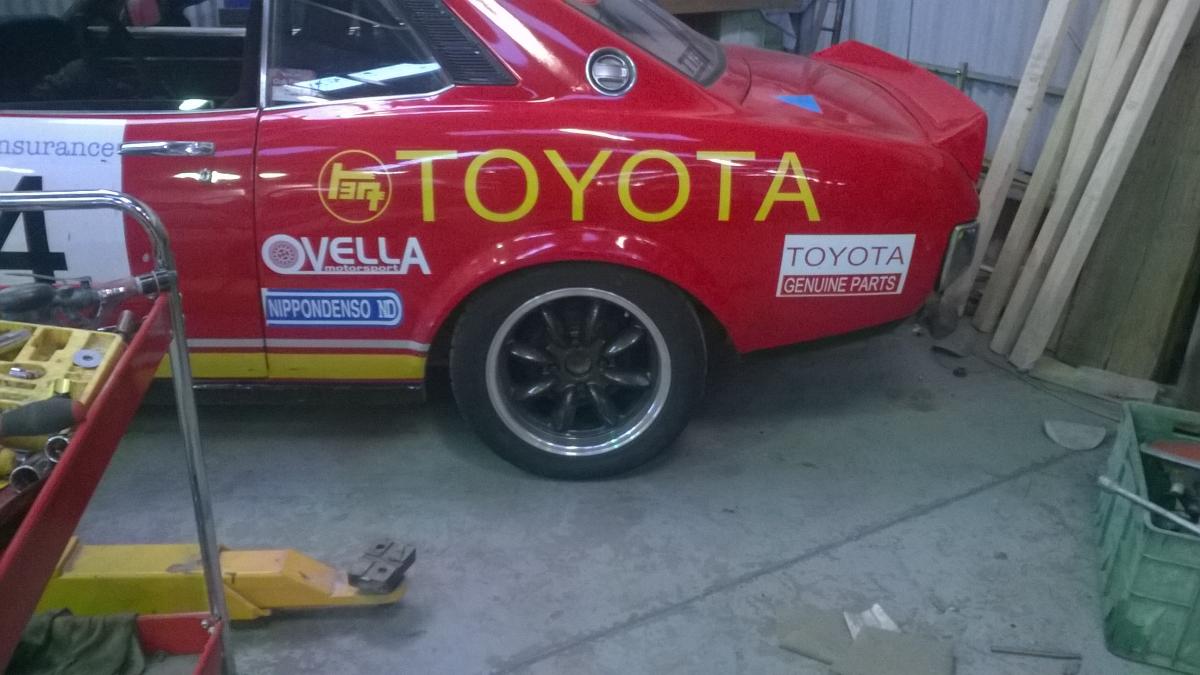

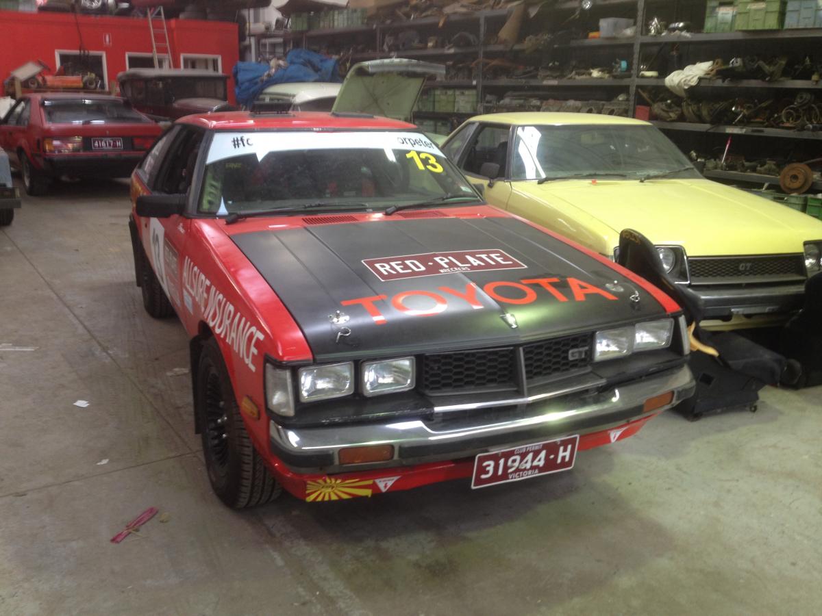

heres dads rally car with the gt grill

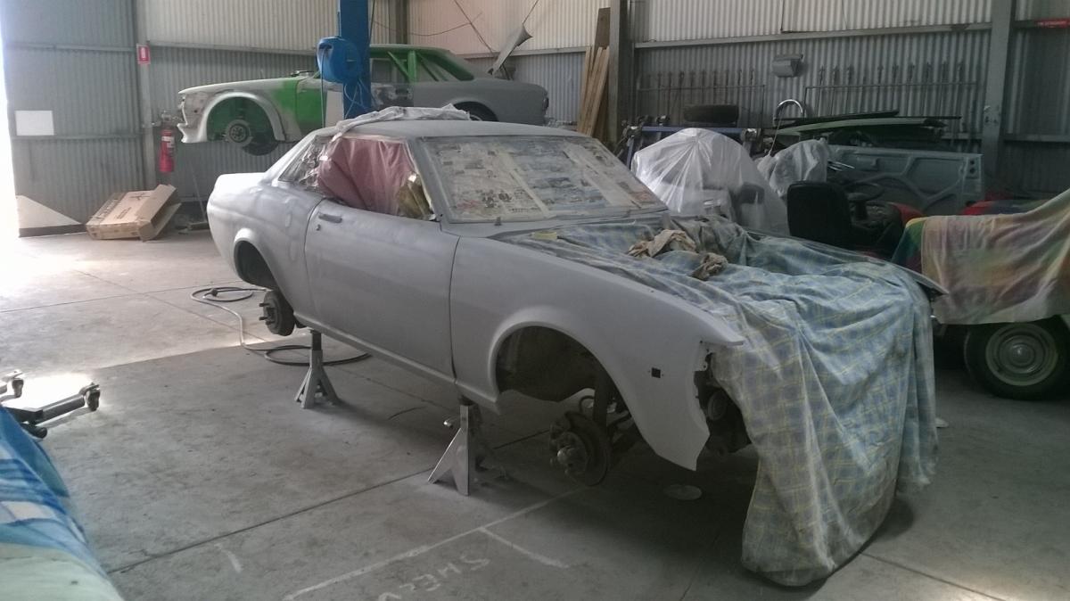

so spent about 3 weeks on the car getting it ready for primer
will be painting the car a AMG Mercedes colour known as tenorite grey

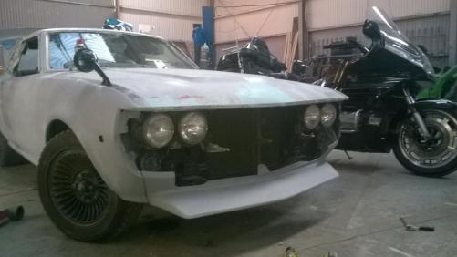

so that brings us up to date , have found a rear gt badge and gear knob just need a front gt grill now !

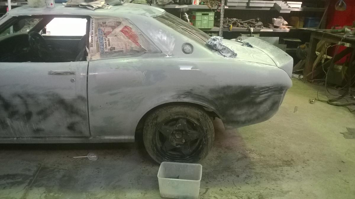

,ok update time . got a bit more done ..... car is now mostly in primer just trying to get everything perfect before i paint the base coat on ...

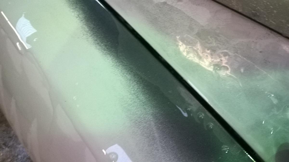

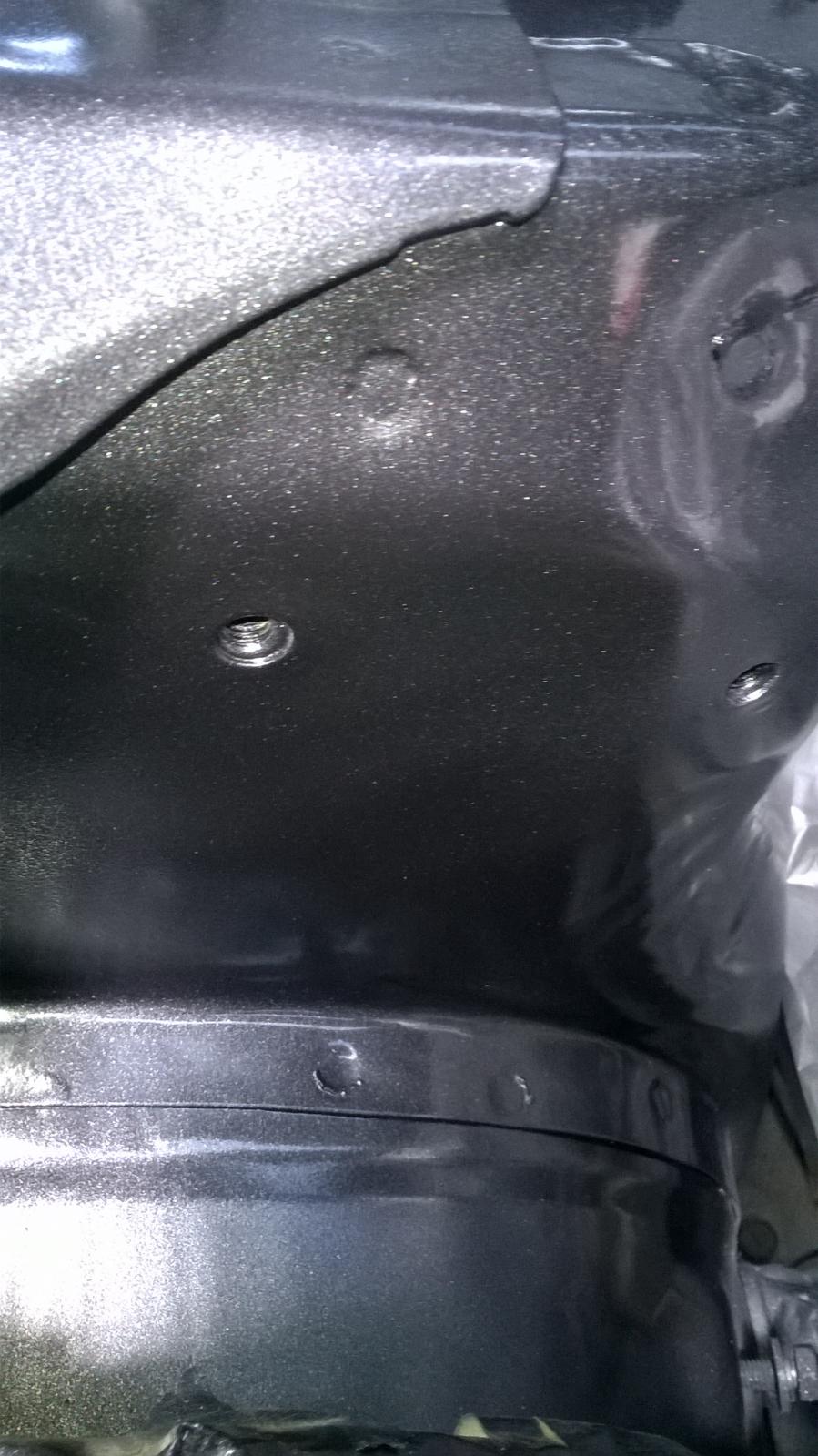

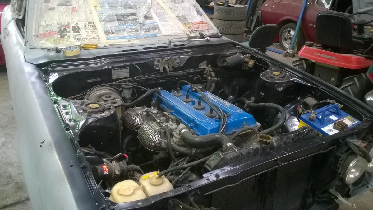

Also painted the boot and engine bay
Just a quick paint job under bonnet will repaint one day if the motor ever comes out ...

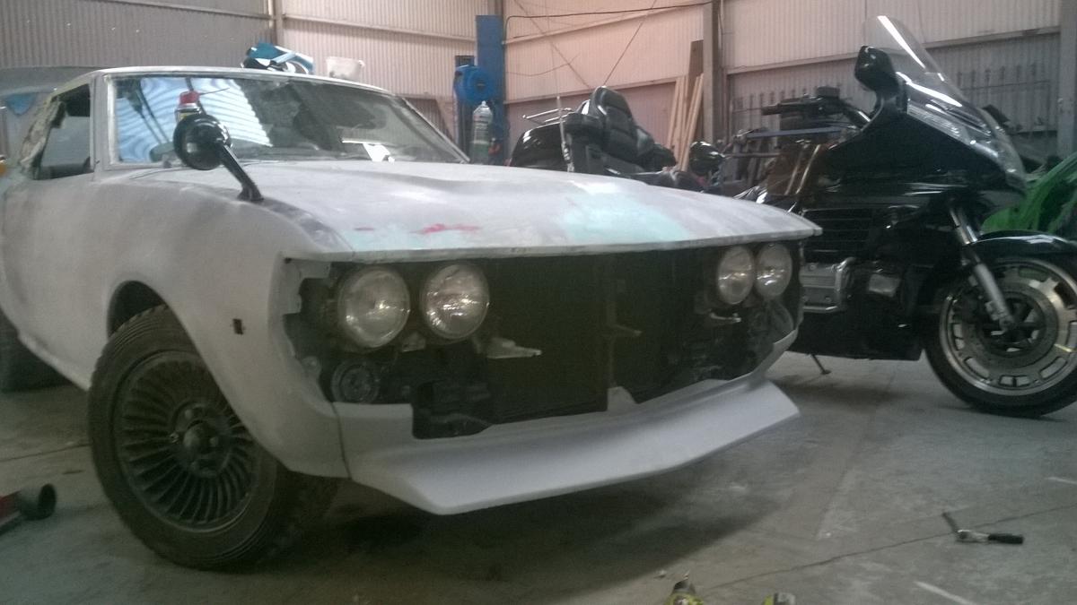

Spray a panel as a test and see how it comes out, If it's a bit dark try spraying some gloss white down as a base and then spraying over that.
I ended up doing that on my Celica
thanks for that mate will have to give that a crack
Primed the chin spoiler and mounted it , also fitted the fender mirrors for a photo post-17093-0-88897500-1421669457_thumb.jpg
