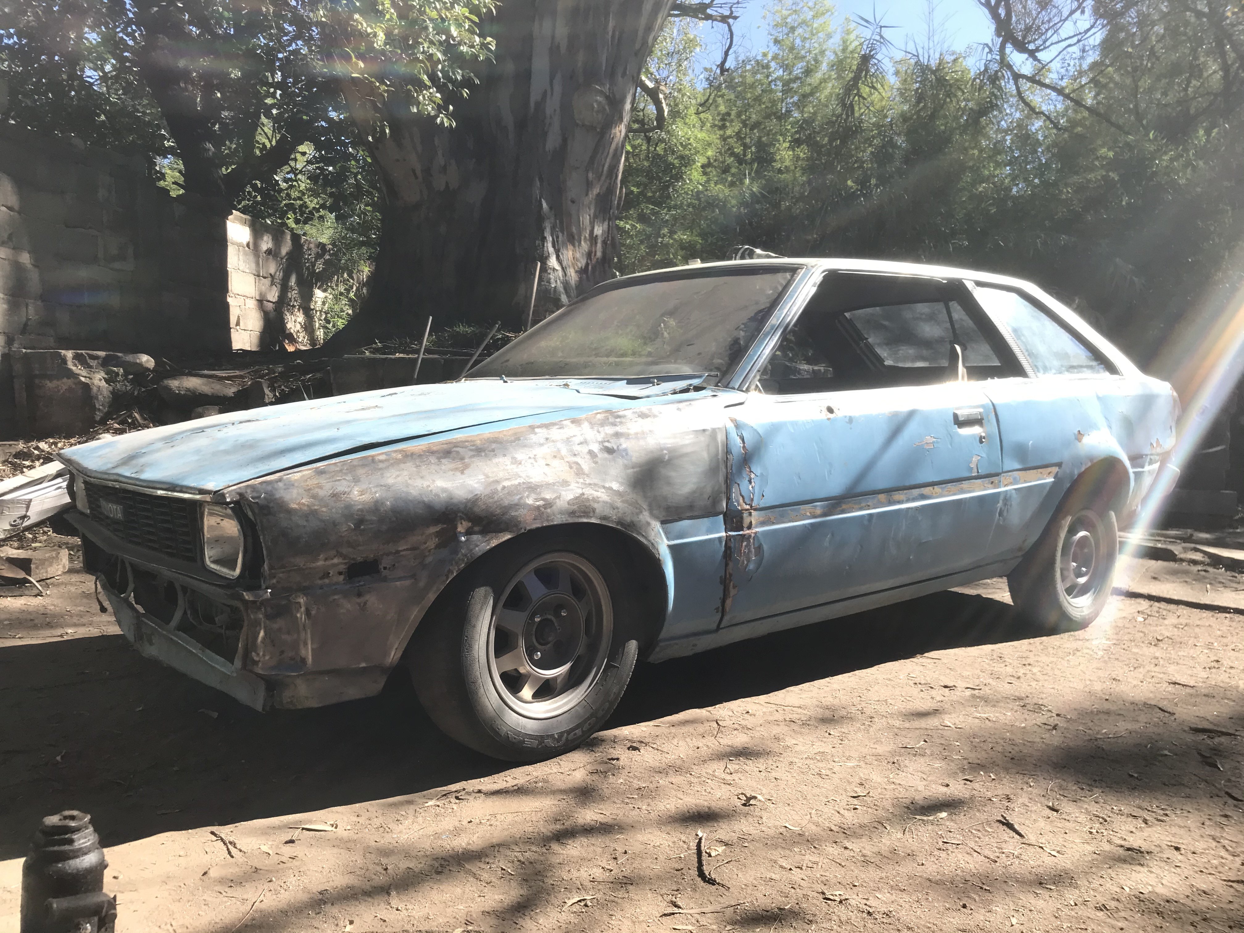

  8. Looking for a good safe ignition on power for electric fuel pump. Around dash or ehgine bay,had a huge wireing melt down .not sure if it was fuelpump wirng or coil wiring to much damage to be sure. Yes i have a relay on pump ,and fuses.(been working fine for years) 4age ke55 carbs
  9. Sure is a good one,i often wonder how many are left out there in this sort of condition. nice find banjo,got 7k laying around ha ha
