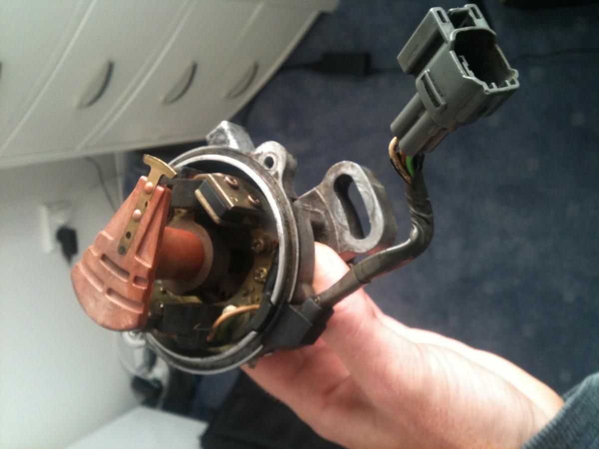

  2. After 6 months of running the wrong spark plugs I was getting miss-fire under load and over run. Replaced plugs with new irridium/platinum top range and seemed to fix for a while. The idle seemed rough and had a slight bounce or hunt. To the point one morning she struggled to start and smoke came out of the air intake on first attempt. Then would not start at all and half burnt fuel smell+smoke from air intake each attempt. I tested my spark at the plugs and found I had a weak red/orange spark. I have searched high and low for replacement dizzy to no end. Having purchased a new coil and igniter at some expense I have only been able to find dizzy rebuilders in vic or adilade. being on the gold coast and the car being my daily and already being off the road for 2 weeks (boohoo) I was hoping that the new Dizzy I bought would work..... FAARKIN ebay! I pulled mine apart and gave it a clean and besides some oil leackage looks in very good condition. I don't want to ruin my new igniter if its pooped Could the increased impedence destroy the condensors? p.s. Forgive my spelling if not correct :)
  3. Just wondering how or if a distributor can breaks down/ wears out? If nothing looks broken or worn out how might I go about testing? Below is my internals, bearing seems fine, it was a little oily which I cleaned up.. not overly bad. I have a new seal kit or possible replacements seals. Just want to know if anything can cook or wear out. I had wrong plugs in which caused (I think) the current problem. I'm replacing Coil, Igniter and thinking of getting Dizzy rebuilt but the later is time consuming and possibly further expense. However I have been informed if its broke it will damage new igniter. The cap seal was broken (as expected)
  4. So no love with the new Distributor.... :scarymovie: Wrong plug and wrong pick ups.....FAAAAARK! Ill post pics and see if anyone wants it or can think of anything. just going to use the old one for now as wasnt sure if it was at fault..
  5. The coil lead is in the middle of the plug leads... EDIT; Oopsy again Ill correct myself after looking at my own pic I took of my own dizzy I have been tinkering with for 2 weeks... Now where did I put my medication un-quote. Re EDIT; just noticed the coil lead plug on the pic above is different to my cap??? Should this pose a problem?

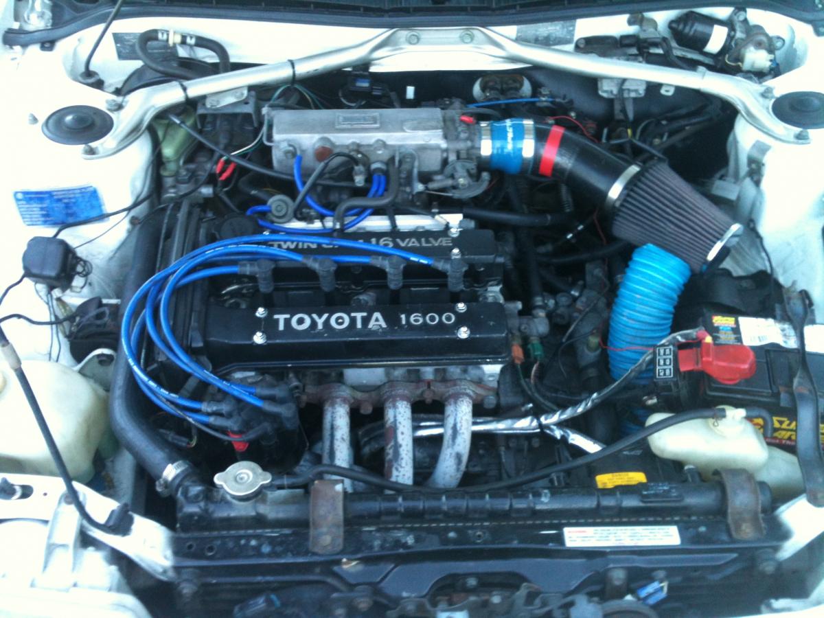

  6. Giggles... welcome to my world.. Like I said "frankensteinish" The guy I bought it off (dealer) mentioned the previous owner had "turbo spec`d" it. Implying it was to be turbo charged, couldnt tell me anything though. I did notice the other day it had Green top 250cc injectors, not standard I think? It has daily driven without incident for over 3yrs. All being beside the point as I have plans to add a Z to the AGE. It was I assume slapped together after engine rebuild/transplant as he needed to trade for van just as hed finished. I love it ;)
  7. lol lots of things arent right under my hood.. Althgough on some vary rare gti according to bill sherwood they did have a small port with tvis. However it does seem to me to be frankensteinish. I don't know the history of the car so I don't know. There are blocked off hoses and plugs not plugged into anything. I assume its not original engine. I can't find the engine number...Where is it located? The block has 7 ribs or at least more than a known 3 rib big port I have. The car was built for a hill climb racer by some young dude who put the graphics on (most of which I removed) The engine seems bullet proof and compression tested over the last 3yrs shows even 160psi+ on all four. Radiator fan is hard wired in.... blah blah blah. I did notice the tvis badge has been removed with some effort so not sure if its modded. also zero rust ;) Starting to turn a little now. Shes in for new CVs and replacing coil, igniter and distributor as some freebie platinum plugs ʞ©$ɟed it. Chassis number shows AE92R4agegt1 built on the 6th month of 1992 (- I have also heard that there was a very early (1983) and now rare 4AGE TVIS FWD that had black lettering on the cam cover, but the main difference is that the crank only has six flywheel bolts verses all the other 4AGE's that have eight and so it looks like it has a 4A-C single-cam type crankshaft. - Another odd 4AGE is one that has red lettering on the top, is fitted with TVIS & a big port head, but has a seven-rib block & a 42mm bearing crank. There are much easier to find around the world. They also appear to have no oil squirters on the inside of the block, unlike the regular small port types which do.) ( ) Is pulled from bills page.
