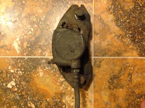

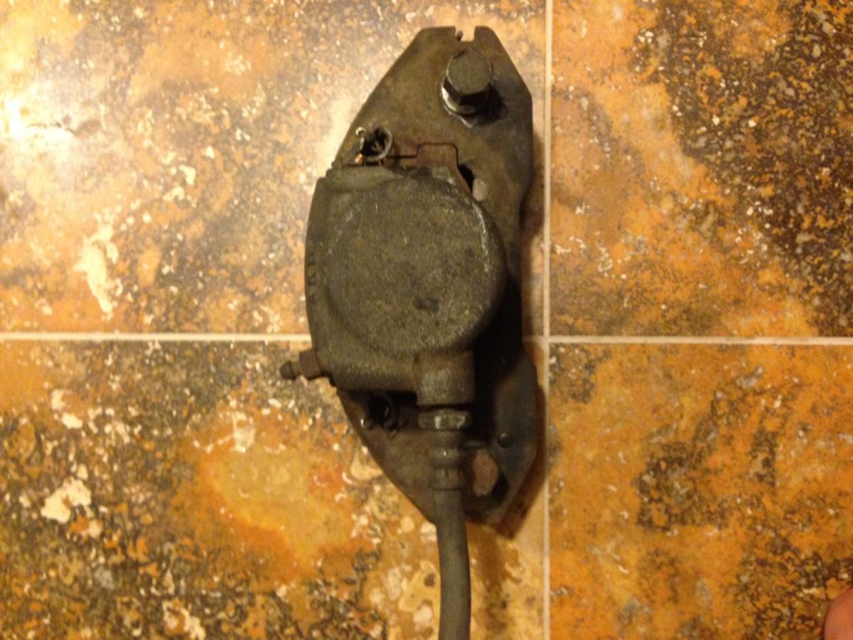

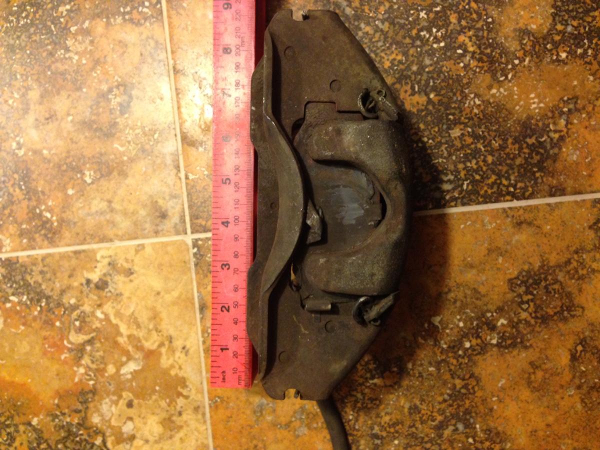

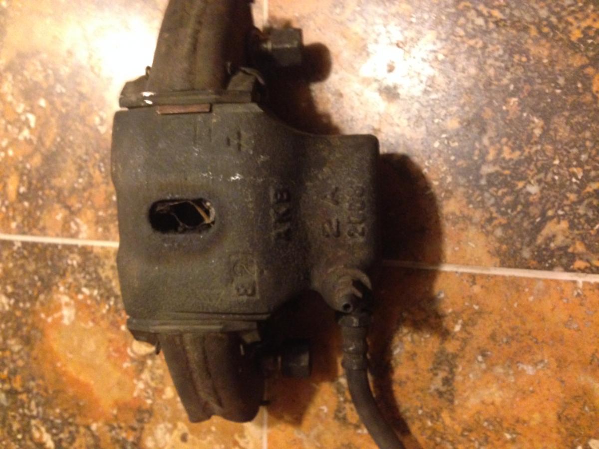

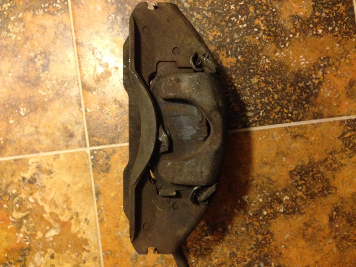

  8. Hi Guys, I again call on all you knowledge toyota-heads out there to help me identify the calipers I have on my car. As you may have seen from my last topic, I am doing a full revamp on the front running gear/suspension on my TE31. I figure since I have everything out and apart, now would be a good time to replace my worn pads and rotors for some better performing items. However, I can't seem to identify the calipers that are on my car. The previous owner I believe did an upgrade so I don't think they are the stock ones any more. Can you guys take a look and let me know? These are large Thanks, Chase H
