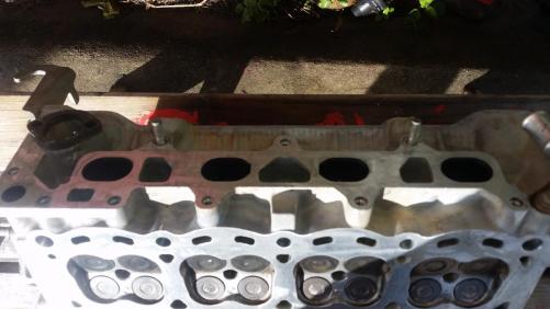

  5. Blown head gasket and leaking thermo housing so i pulled her to bits and put in a full new gasket kit. She runs like a dream now but there is a slight shutter at low revs like its not getting enough fuel. Its in every gear at revs around 1200. Everything on the electrical side is new so I'm guessing its carb related. Any experts on the carb. Put a few pics of the build just for interest sake. Under the rocker cover Carby looked like she had copped a heap of oil from the pvc valve and the auto choke is seized Pistins were built up with carbon The head off and cams out. Cleaned the mating aurface on the block and the pistins. To really shine up the mating surfaces i used a flapper pad with a super fine grit on a drill to pollish them up nice

  9. My 4afc use to stall when cold. The auto chocke was seized and The inlet manifold gasket was poked. Its not a hard fix but you may have to take the head off meaning head gasket as well as intake and exhaust gaskets. While your in there polish the ports and remove carbon from your pistons and valves.
  10. I recently purchaced a 1990 Holden nova sedan with the 4afc motor. It had a blown head gasket as a result of a faulty thermostat. The auto choke was also seized. I replaced the head gasket, intake manifold gasket, exhaust manifold gasket as well as the dizzy, ignition leads and thermostat. Full oil change and tune up. Having a few problems with a shutter or surge at low reves when driving. Any suggestions. While the head was off i cleaned the pistin heads and the carbon buildup on the top edge of the cylenders was removed and pollished. Valves also cleaned.
