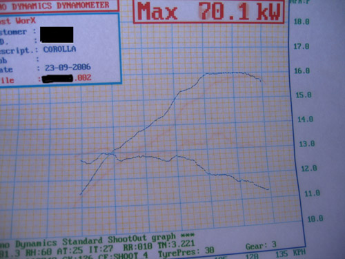

  12. nah its map standard for smallports. you can see the feint red lines on the graph too, they're the graph of the other smallport ae92 there on the day. he made less power but his mix is not as rich. econ isn't *too* bad, i tend to drive pretty hard so its never gonna be great, around 10/100 in the city and about 7-8 on the open road
  13. this is my power and AFR graph from the dyno

  16. car: AE93 sx corolla with cannon thing problem: pops/backfires when throttle is let off and re-applied around 2500-3000rpm, burbles on decel from about 3500rpm notes: when car was dynoed, AFR graph showed mix to be rather rich. : have had the O2 sensor off and cleaned : run 95 premium most of the time (98 sometimes, never 91/92) : only happens when car is at/nearly at operating temp, and is worse when hotter : happens almost every upchange questions: what is the problem : how do i fix it?
