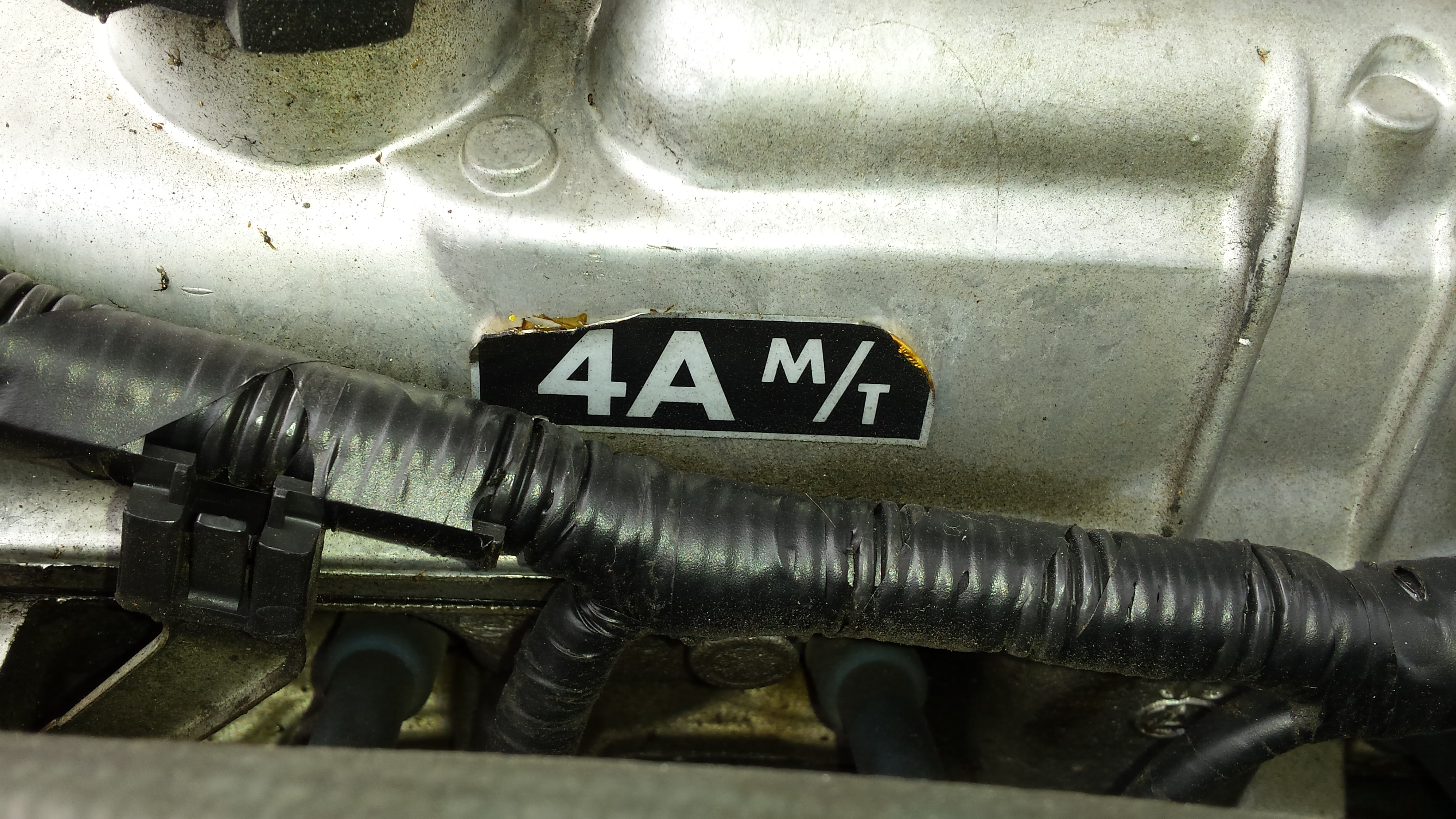

  5. Hi guys my car has the same motor with mt sticker Its most definitely the 4c unit Just wondering if yours has A rattle at the distributor end of the head

  8. Hi all I posted here a while back about my 88 AE82 4AC motor not idling. So the thermostat was stuck open and causing a problem with the vacuum lines. Replaced thermostat Still no idle so off with the fuel pump. and hey presto badly warn linkage in the pump causing fuel starvation under 1,200 revs. Replaced fuel pump Motor now idles but there is a rattle coming from the distributor end of the camshaft. Next step will be to remove rocker cover and observe. But for now has anyone had wear problems with the distributor on this motor. I would have thought that 132000 ks is relatively fresh for one of these and its not been flogged as its my mothers car. Any comments greatly appreciated.

  11. Hi all newbie here I am driving my mothers AE82 Corolla and it has a rattle in around the distributor. It wont idle properly if at all and has flat spots all over the acceleration cycle. I thought I would consult the brains trust on this forum before I start spending money on the wrong parts. The rattle is not from the engine and sounds to me like the dizzi fly weights or a loose wing nut around the carby area. Its not a regular mechanical knock. See picks
