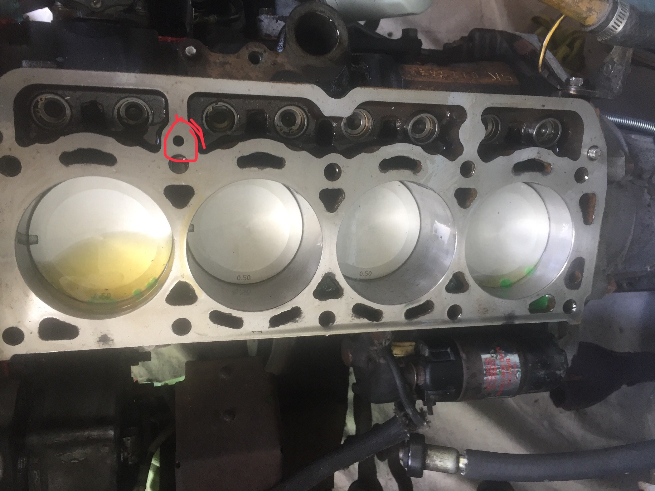

Hey Banjo, I have a brand spankin new Ryco z386 filter installed currently! The 5k does have a solid lifter conversion! Its running Holden 202 lifters, 1200 pushrods and 4k rocker gear. I chose to do this swap because its a 4k head on a 5k, and the original 5k pushrods were way too short for the rocker gear. Because the head has been taken off, it shouldn't matter what the lifter/rocker setup is, because no oil is being pushed through the oilway to the head whilst I'm turning the pump? I don't believe there is any shims under the rocker shafts. Shims, do they look like washers etc? I just want to clarify, that when I mean no oil is coming to the deck, that there is no oil coming out of the oilway that's in the block, circled in the image below. Oil is being pumped by the pump! A real head scratcher! p.s: excuse the oil sitting in the piston. I poured too much in. Its gone now. Used it to wet the deck and walls so that it doesnt rust. I live near a beach.
Hey Banjo! Took the head off, and spun the oil pump again. No oil is being pumped to the deck. The head gasket was a standard one, but it was installed correctly and I was told is totally fine for the motor. The rocker gear lines up perfectly with the oil feed hole in the head and isnt blocked! I stuck a long screw through the oil feed hole in the deck, and it hits something! It looks like the end of a temp sensor that goes into the housing, cylindrical in shape. I couldnt get a picture sorry! I couldn't tell if its partially blocked or fully blocked. Could it be something that is attached to the cam system/screws in around there? I'm racking my brains, but I don't believe that there is anything that does! I'm really stumped!

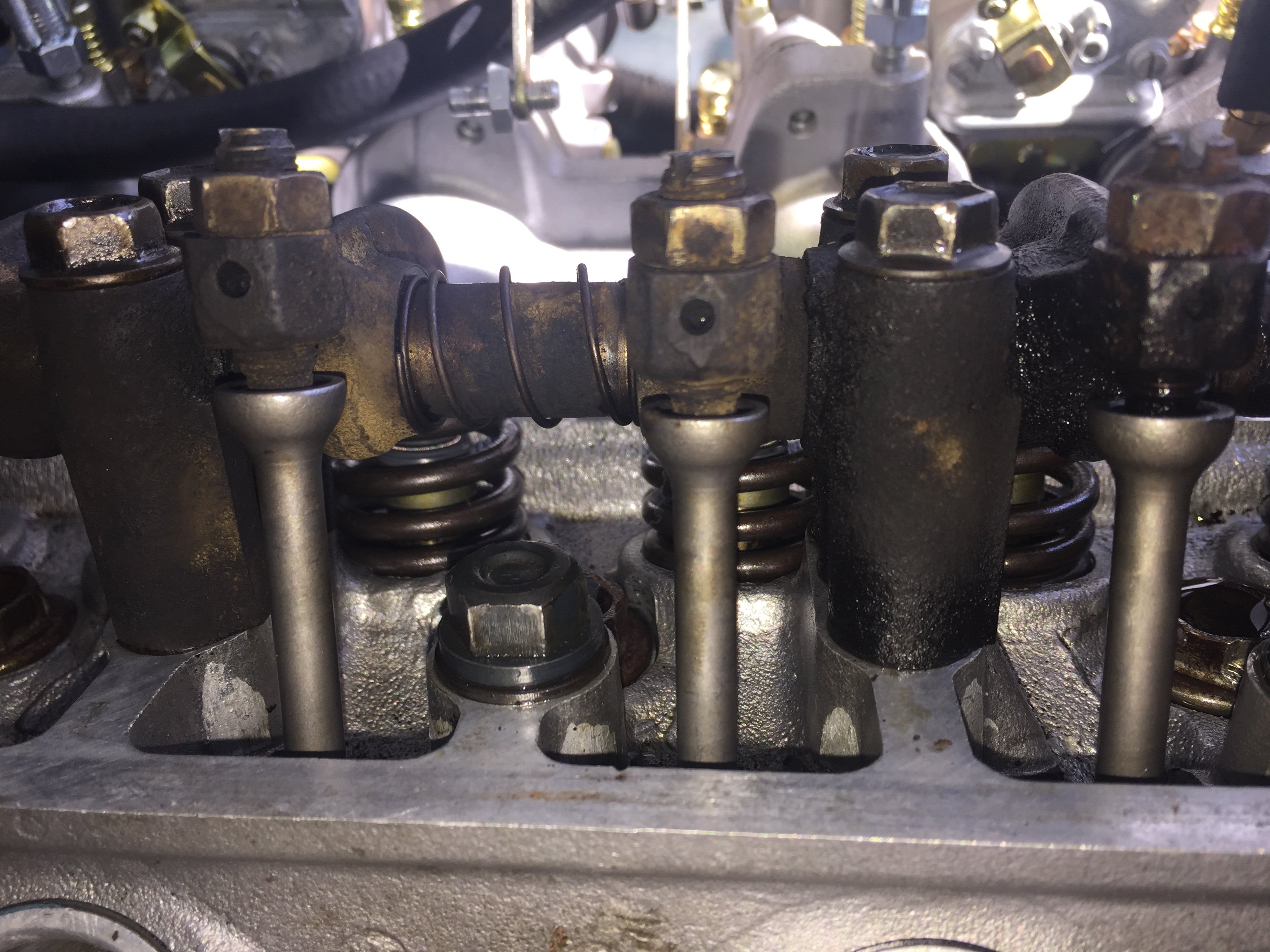

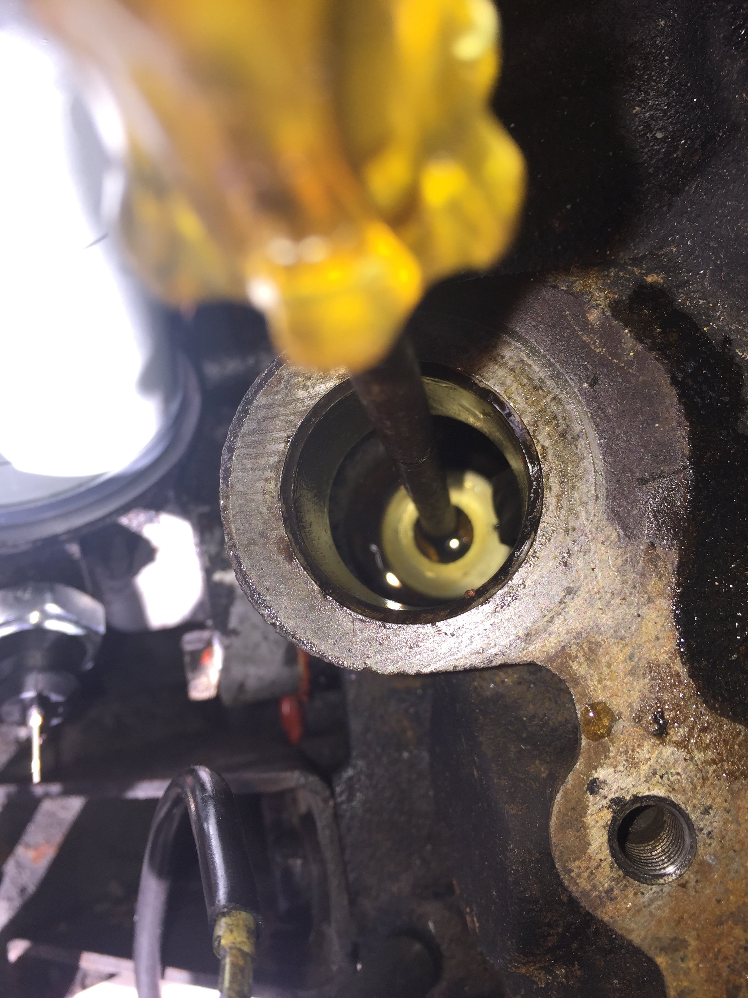

Thanks for your responses guys! So, Ive been out in the garage today doing some of the stuff you have suggested! First off, I took the oil pressure sensor out of the filter housing and span the oil pump by hand with a screw driver. And oil was coming out! Yay! Oil pump is not broken! I kept turning the oil pump and oil began to come out briefly where the oil pump connects to the dizzy, where I was spinning. I am assuming it is, I wanted to check if that was normal! Also, Altezzaclub mentioned that oil should come out of the rockers. I forgot to mention, but I have a 4k head on a 5k with 4k rocker gear. I couldn't see an oil coming out of the rockers while hand cranking, so I got a flathead and cut off the handle to prime the oil pump. Still no oil going into the rockers even with the drill on full blast! Does the engine have to be cranking? Cheers guys! I really appreciate your help!
