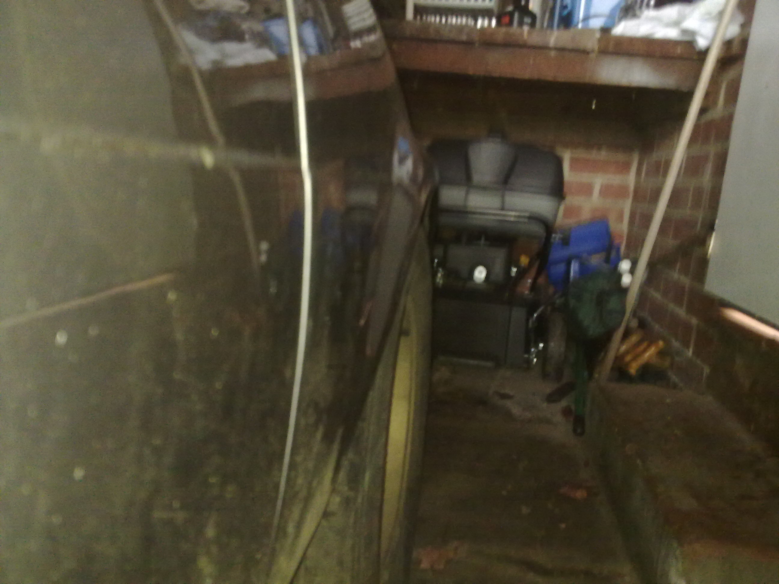

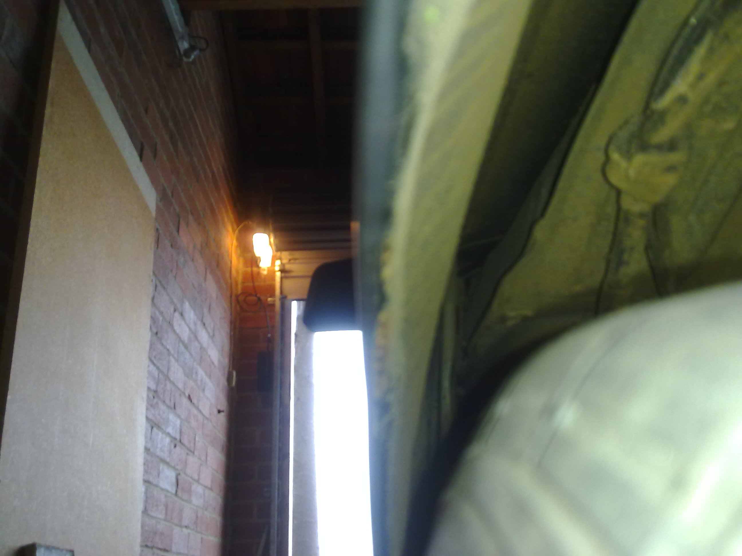

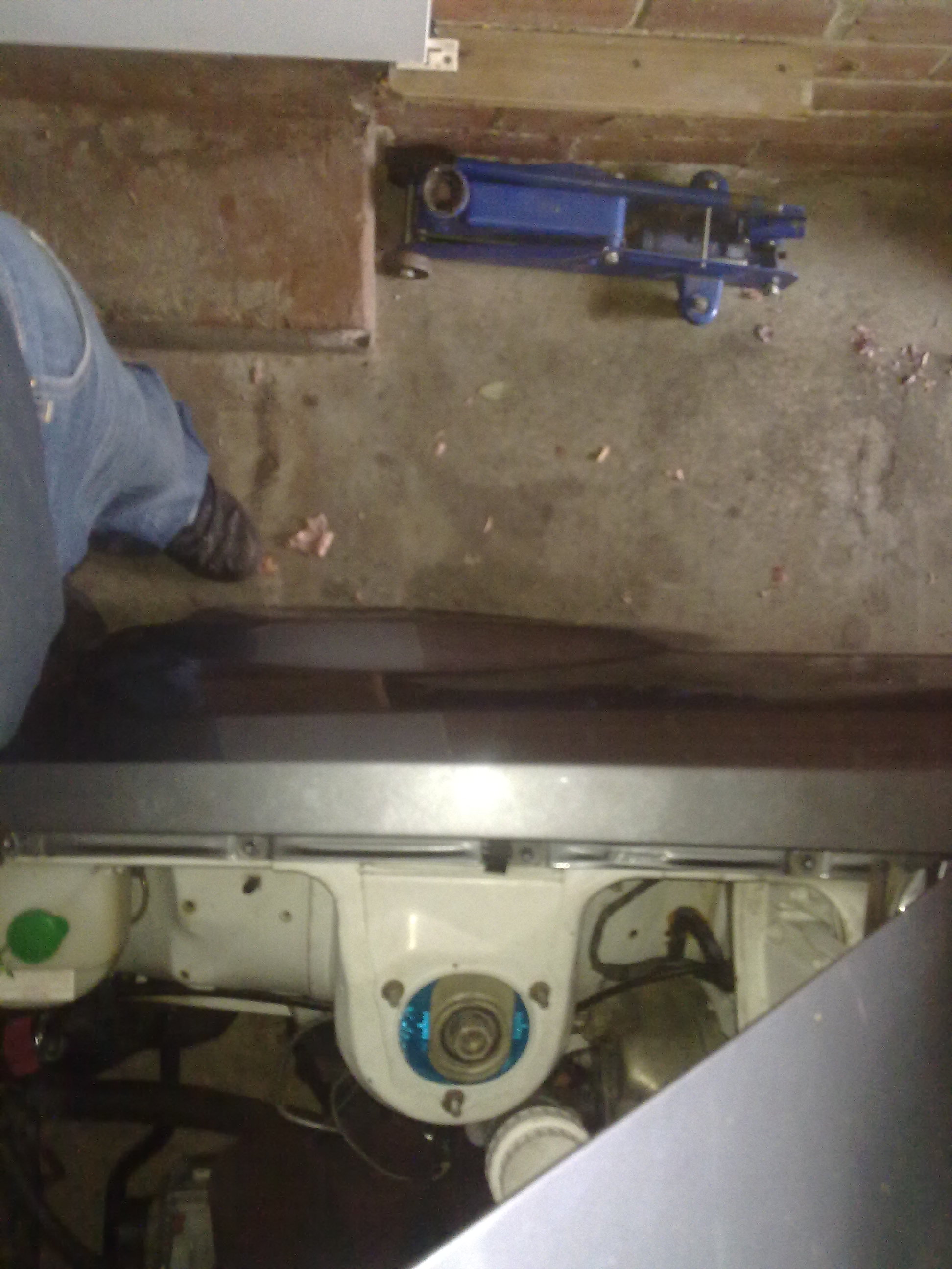

  14. I will try that first, at the moment I don't have a stock control arm either. The track measurement is made from the centre of the tire on each side, so unfortunately that won't change it. The annoying thing is I remember seeing a post on a forum somewhere basically listing the lengths of all the different control arms but I'm stuffed if i can find it. So I have a lead on a stock arm but I would really like to just find the shortest arm possible and go with that and save the stuffing around.
  15. Yeah its actually insane, I didn't even think that wheel offset would effect it originally. I've actually just taken those pics I'll have them up in a sec. These aren't my 15s though cos they are away getting reconditioned, I had to remove the calipers so I could fit these 13s. They have a similar offset though
