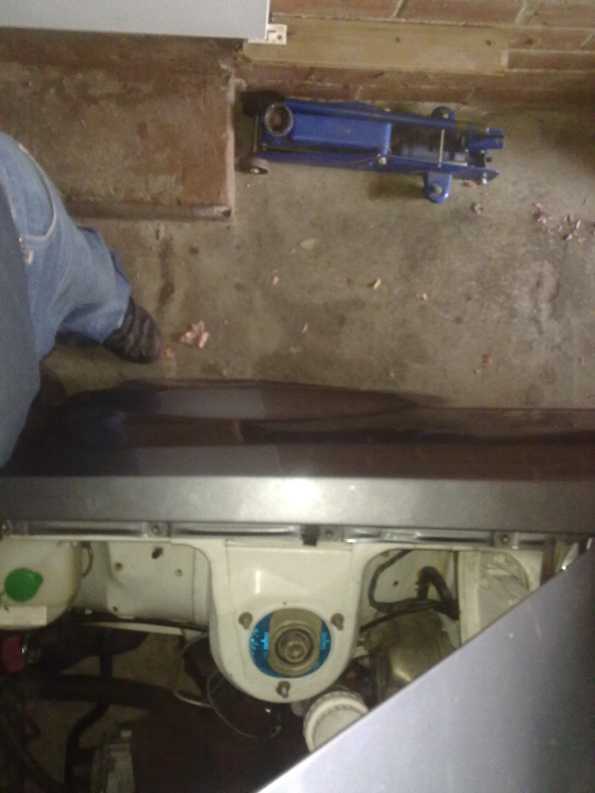

  15. Yeah its actually insane, I didn't even think that wheel offset would effect it originally. I've actually just taken those pics I'll have them up in a sec. These aren't my 15s though cos they are away getting reconditioned, I had to remove the calipers so I could fit these 13s. They have a similar offset though
