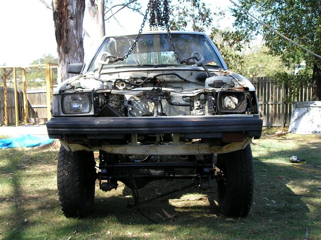

  3. No, new tyre wheel package to come, from 215/75x15 & 5.5" rims to 235/75x15 on 7" I want to bring the body down by 25-50mm yet. Q4 first, The wheelbase on the Rolla is 40mm longer, so it makes sense to do a RUF (rear up front suspension change) which will get me another 50mm longer in the wheelbase. Q3 the wheels will fit better in the arches & I will open them up as required & it will have flares to cover the wheels.
  4. Well it happened & is pretty damn close, had to cut two small brackets off the chassis but not much else. I will have to modify the sub frame of the rolla at the front & stretch the wheelbase 50mm, but all in all it's pretty close.

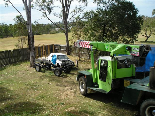

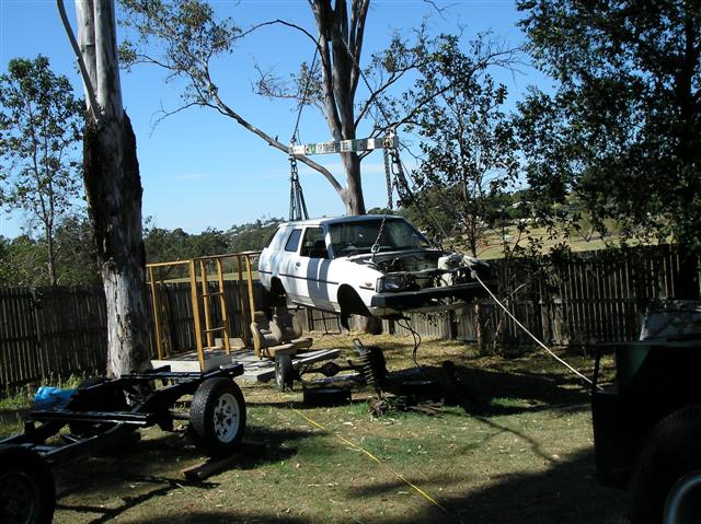

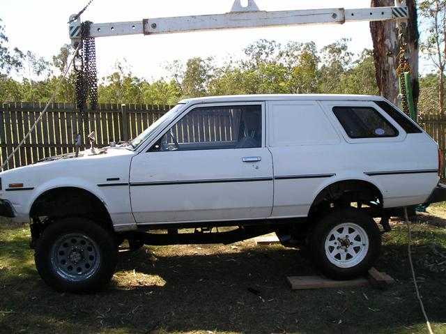

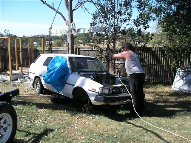

  6. Ummm NO!!!!!!!!! No room here for lots of cars....... unfotunately. I will be using the strut towers & the hole for the spare wheel bolt as lift points, will only weigh about 400kg so it won't be a big lift at all.
  7. Done, cause that's how it's getting done....lol.

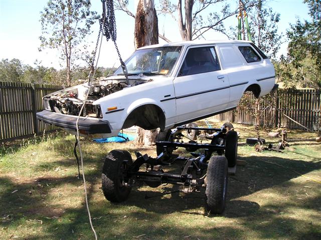

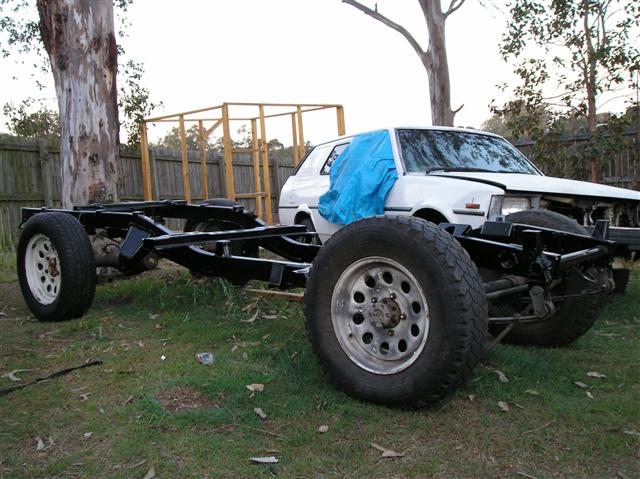

  8. Got the LWB chassis rolling now....... finally...lol. Next weekend will be the trial fit of the Rolla shell....
  9. Hopefully this weekend coming mate. :hmm:
  10. Chassis now looks a lot better thats for sure. Can start assembly now, gunna be slower than I would like but long as it keeps goin forward.
  11. 6 pack of Barefoot radlers would do just nicely....... :y: I have now procured my FULL SIZE side windows for the Pano including rubbers, hinges & all the bolts & screws. Gunna cost me postage only from Un Zud......... :lolcry: :lolcry:

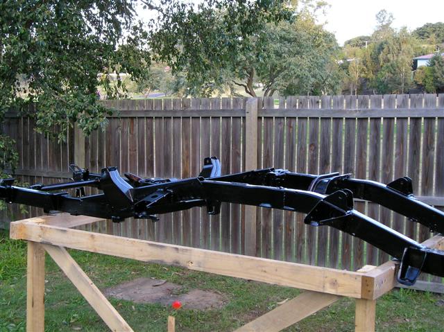

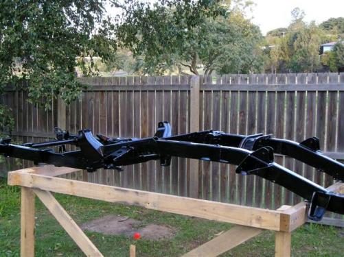

  12. Finally work has started, built a rack to clean & paint the chassis on. Looking at having the Pano body sat on the chassis in about 2 weeks. The cheapie clean & painting rack Had to buy this from ebay....... just seemed appropriate.
