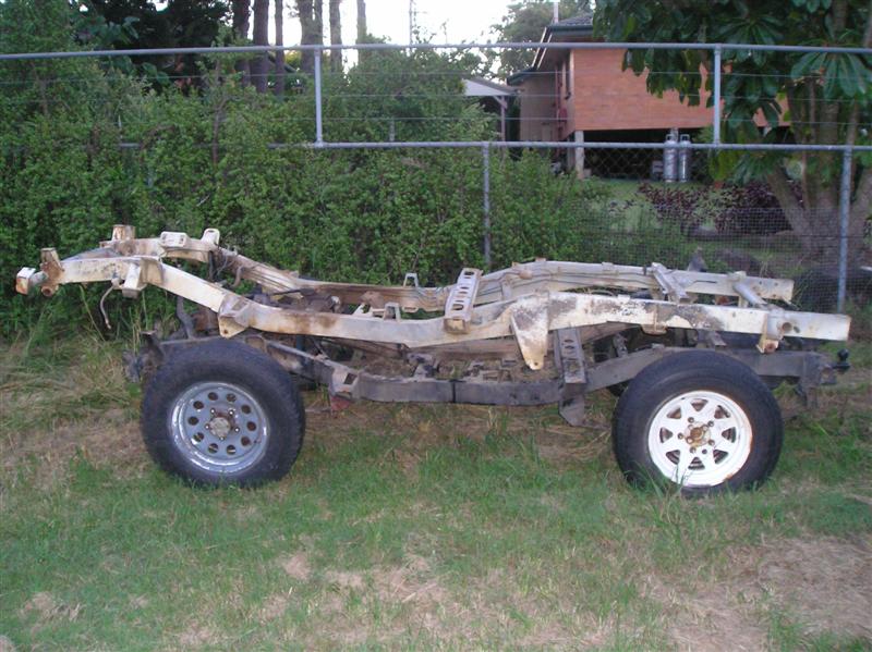

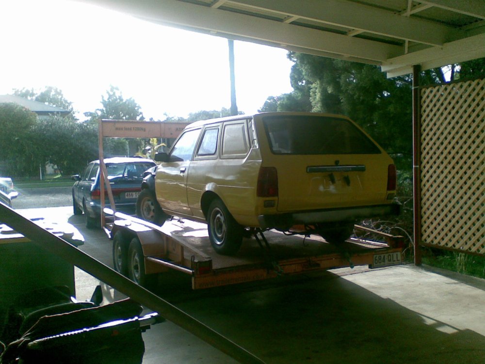

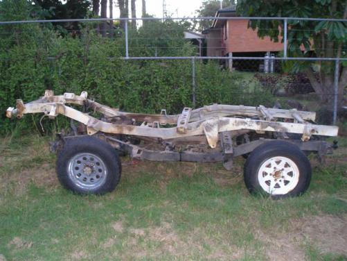

This is a project I though of doing a lot of years ago & just never got around to it. I have a LWB Suzuki Sierra chassis & drive lines & I am about to put a Corolla station wagon onto it. :D It will be an Individually Constructed Vehicle for rego purposes which means about 2k in Engineering fees but ya get that.
1.6 Engine & Auto will be donated from a Vitara (so far), unless you lads can think of a Viable yota alternative, still open to suggestions on that.

Both chassis in the pics are Wide Track chassis & came with the 1.3. Was thinking of using the 2.5l V6 in it, still could happen.

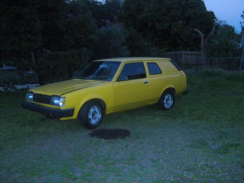

Ah I know this Pannel van well that will be used in the conversion.
