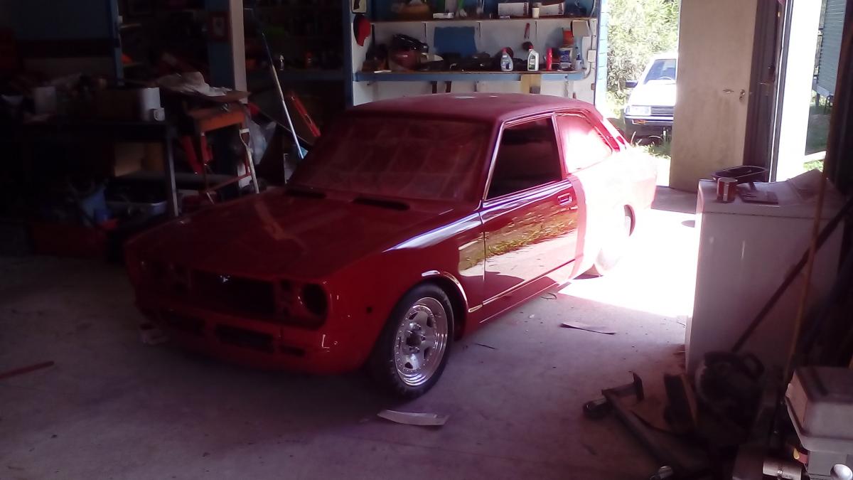

Thanks guys. Give it a few weeks and I'll post up the finished painted product.

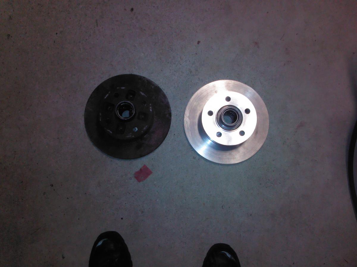

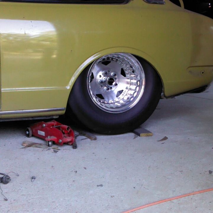

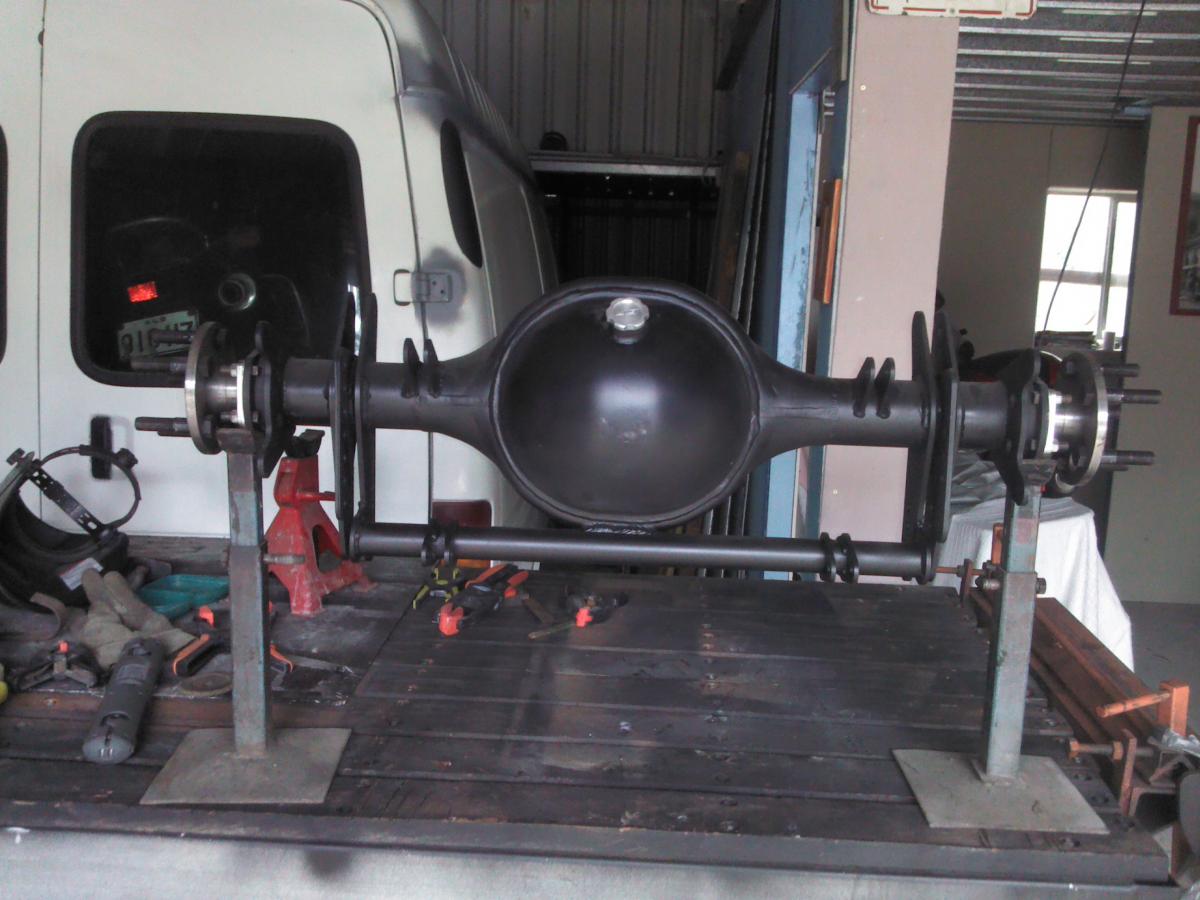

original disc and hub on the left. The one on the right is the same hub and disc turned down to locate alluminium hub face with 5 stud ford pattern. This has allowed the wheel to be relocated about an inch inboard.

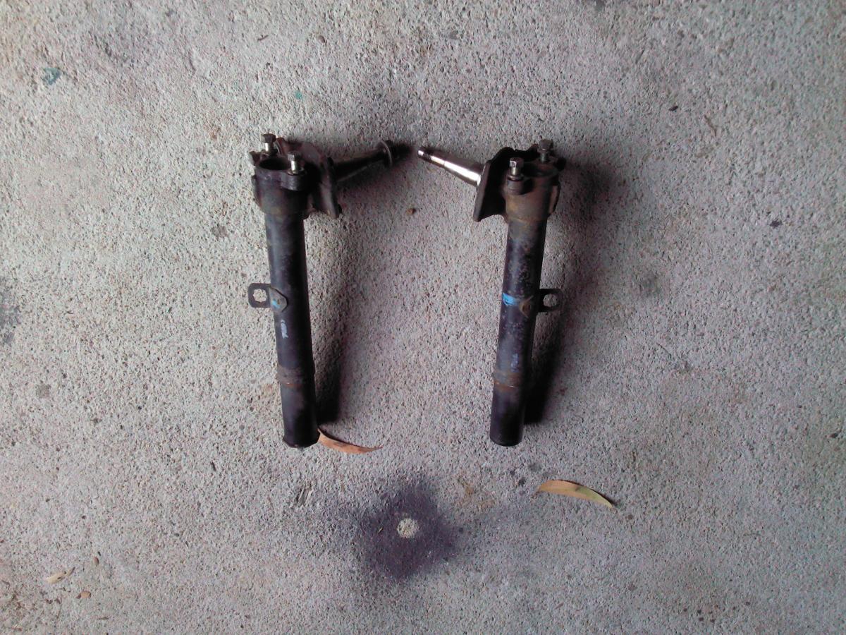

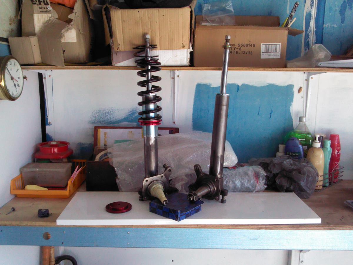

rt132 struts. cutting them down about 3 inches and using ae92 inserts. Then welding on some coil-overs. Should sit low like the rear. To bring the wheel track in, I'll cut the lower control arms and make them adjustable. I hate the frog look some cars have.

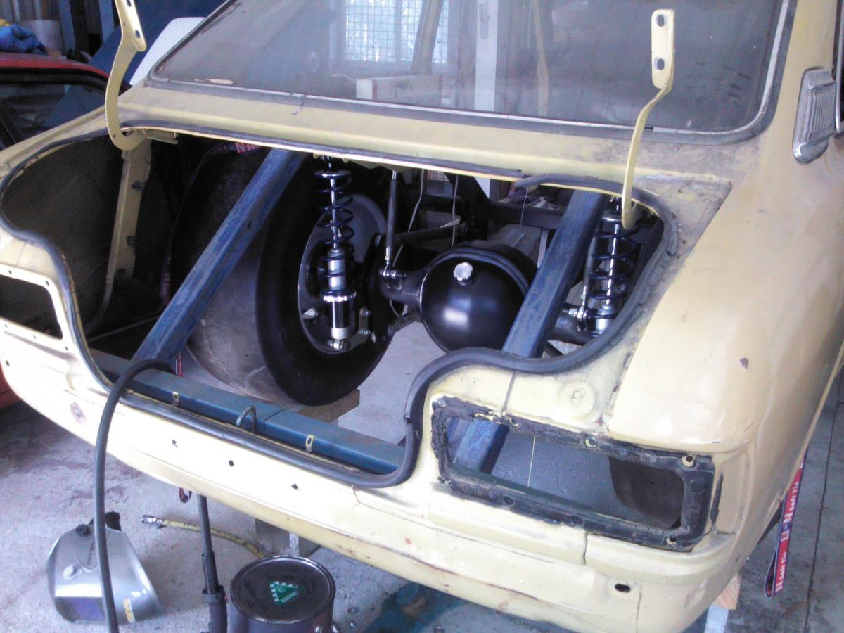

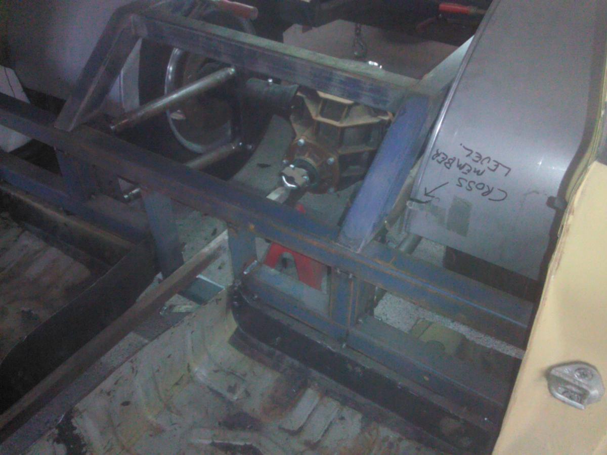

Just welding on spreader bar with wheelie bar mounts. I want to get the car on the ground soon, so I'm finishing off everything on the under side.

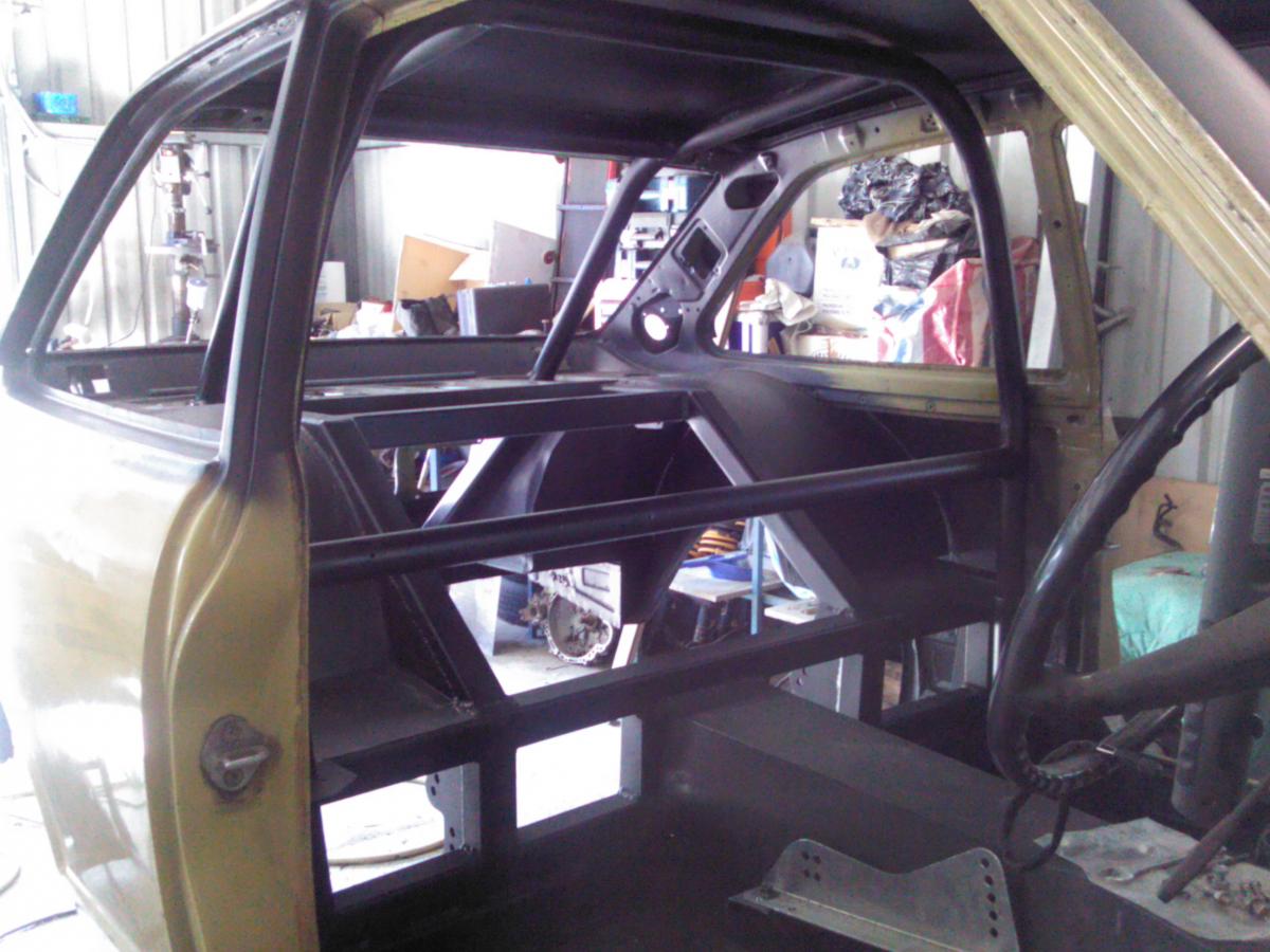

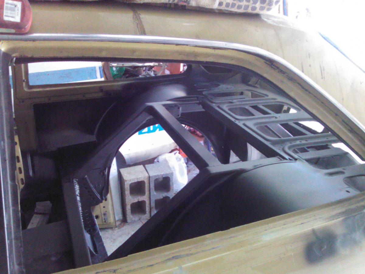

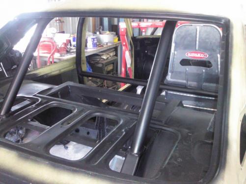

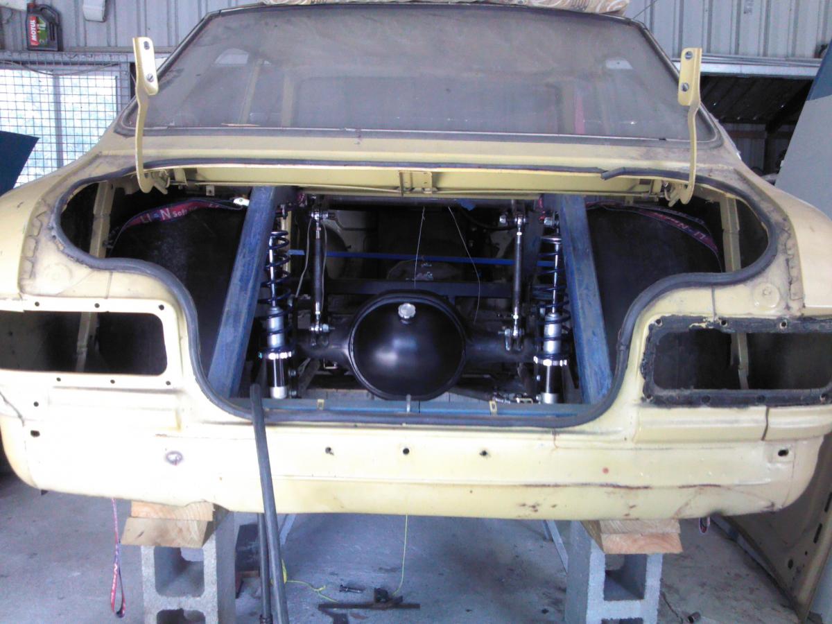

Re-did the rear clip. Wasn't happy with it. Now has way less flex.

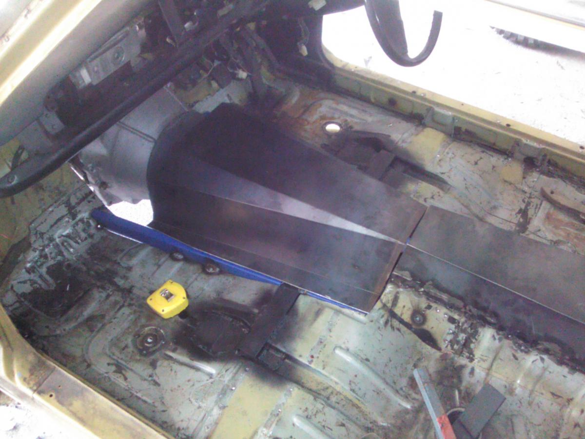

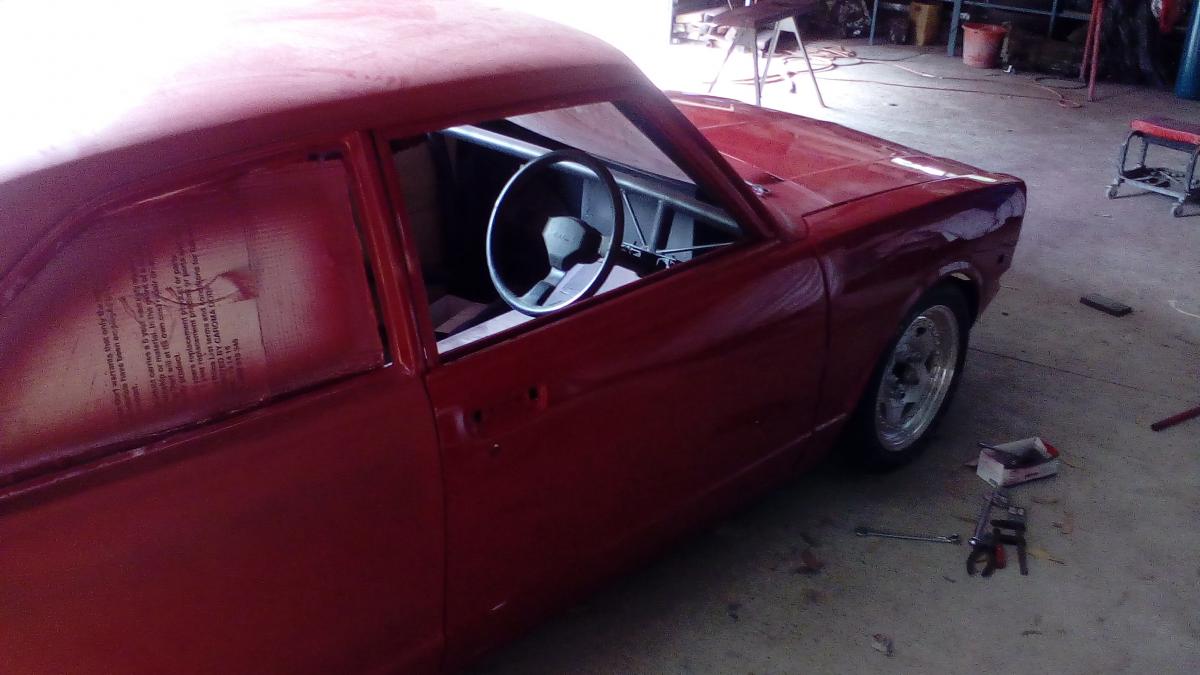

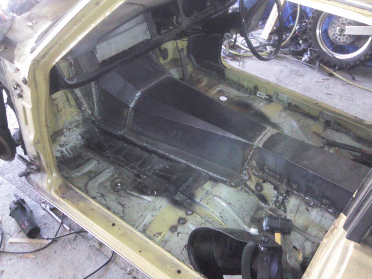

Thanks Troy. Saw your car in one of the magazines. Looks fantastic. I won't be turboing the 2j. I'm using a rotrex supercharger. Should make good numbers. These units are very effecient. Doing firewall and floor at the moment. Pictures soon.
