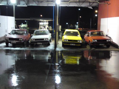

  18. Pic of my wagon and my mates ke's :D soz bout crappy phone pics ;)
