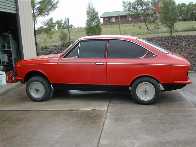

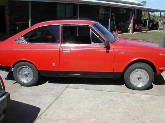

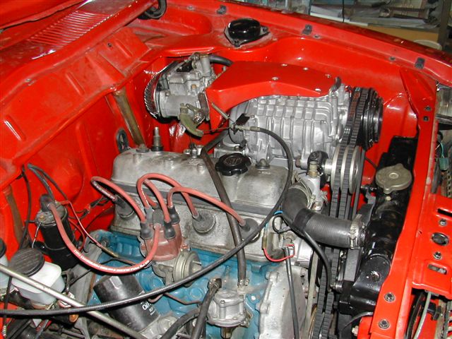

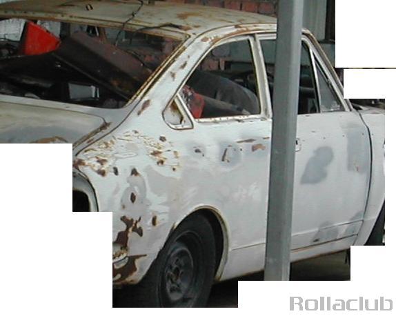

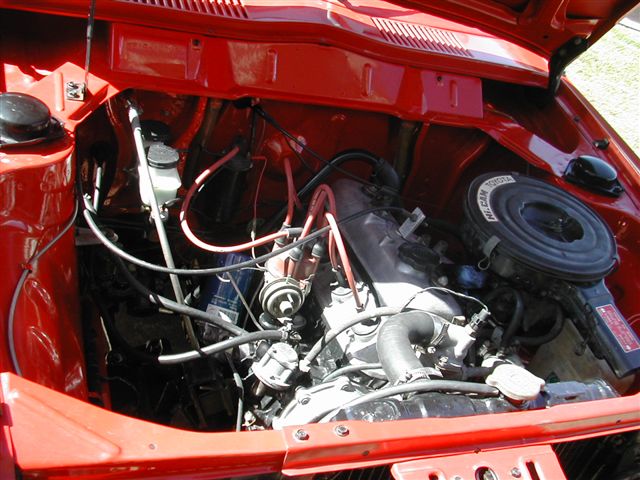

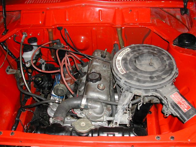

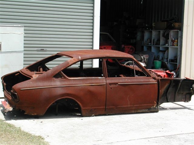

Profile Information

  2. Drives great ,with the 5k even with the low compression off boost (2500 rpm) would be just like a NA 4k .With boost very different .The supercharged 4k had a lot of torque down low ,but this is very similar .Often go around corners in 3rd,4th gear & just accelerate away as if it was in 2nd .Have to be careful if the road is wet it will spin in every gear inc 5th if you accelerate too hard .

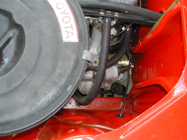

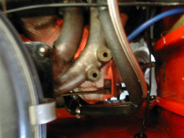

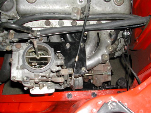

  3. About time I did a bit of an update .I replaced the std carbie with a 34adm weber from a 4.1 falcon as I made the manifold to suit that carbie .It improved the boost & power straight away as the std carbie was a bit of a restriction. I've added a manual boost control & can easily take it past 20psi now the std carbie would only let me get 15 . I've replaced the 5k head with a well ported 4k to lower the compression .Some problems have poped up .The clutch is not happy a HD one is to be fitted & the normal manifold gaskets not liking the boost but all just little things to sort out as I get time .Attached is a pick after a bit of hard running the manifold is still glowing red as I let the motor idle & cool down

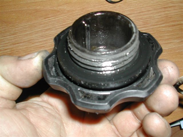

  5. The measurements confirm it. As I said above it is the seal that goes into the oil filler cap screw on type .
  6. The rubber one looks like it is the seal inside the oil filler cap screw on type .

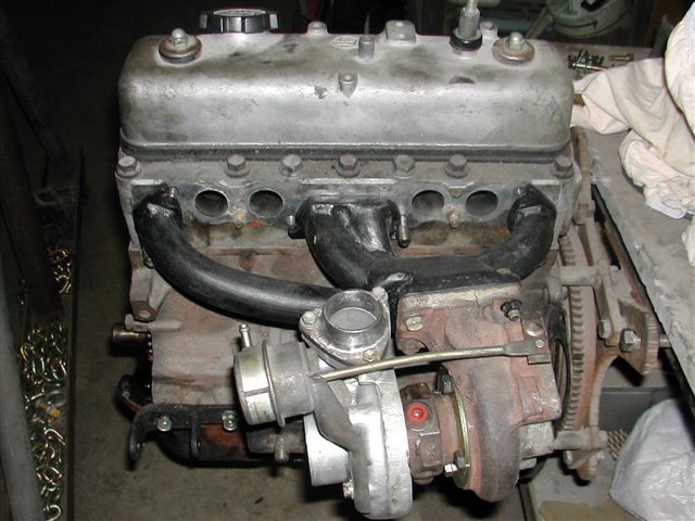

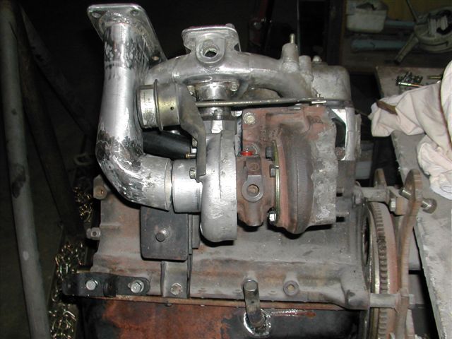

  7. Hi I made everything myself so no idear what it would cost to get it done by someone. I'm thinking about building a couple manifold kits to sell but that will be in the future & have no idear on price yet.The turbo has to be be rebuilt with a carbon seal fitted .I got the T25 for $200 & a carbon seal rebuild kit for $100 .I rebuilt it myself quite easy but maybe a bit too much if you haven't done anything like that before. T25 has internal waste gate up grade water pump ? why? oil is taken from oil filter houseing .I drilled & tapped a new port into my houseing but you can just T into the oil pressure sensor

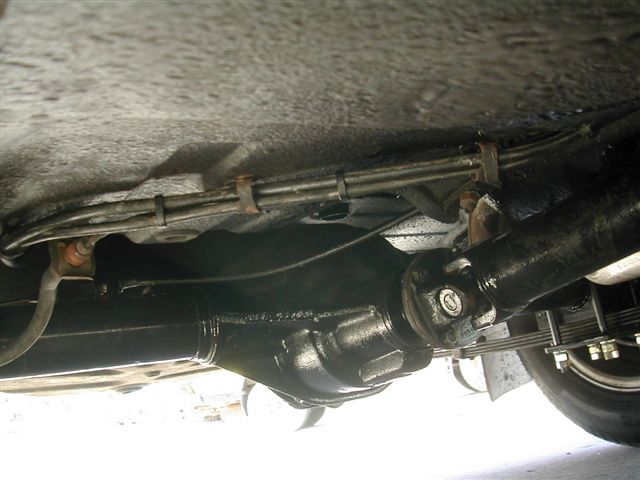

  11. Thanks Justin The std pump was fine with the dellorto it flowed enough and never leaned out. I used the corolla pump that has a return to tank bult in so there wasnt too much pressure on the needle & seat but I did restrict the return fitting on the pump to give me a bit more pressure than std. With the draw through you don't have to worry about boost pressure affecting the carb like in blow through just have to make sure it flows enough . Also just added a couple new picks one of the diff I just fitted & the turbo now that it is wraped Cheers Steve

  13. It was I tried to ues as much as i could from the old car. I even got the origional white on black QLD number plate number as personalised plates means nothing to anyone else :dance:
  14. Yeah the first pick is the shell that is now the red sprinter .Then the ke15 that was burnt out .I was the the third owner to that when I got it I was still an apprentice 19 years old it my 2nd car i'm now 44 it was a very very good origional sl sprinter. other picks are the engine modes I've done
