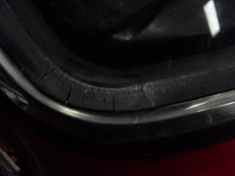

I got two sets from lilavadee about a year ago one set is on one car as you can see from the picks they didn't last an that is with the car garaged .Door rubbers are better but are a bit too hard you have to slarm the door to get it to close even after a year (new rubbers do make it hard to close door at first but after a month or three start to come good not these) Boot rubber is ok if you get the right glue not normal contact get the right stuff from clark rubber it will work .I have a spare set of front & rear rubbers for a ke15 that I'm not going to use if anyone wants them at a great price front is same as a ke10 .It's a bit hard to complain to the seller in Thailand a year down the track that the rubbers you got are no good .Would be nice to at lease get 5 to 10 years out of them before they crack that bad that you worry that the trim strips may fall out let alone the window.The pictures don't lie and both front & back rubbers are in the same condition.
