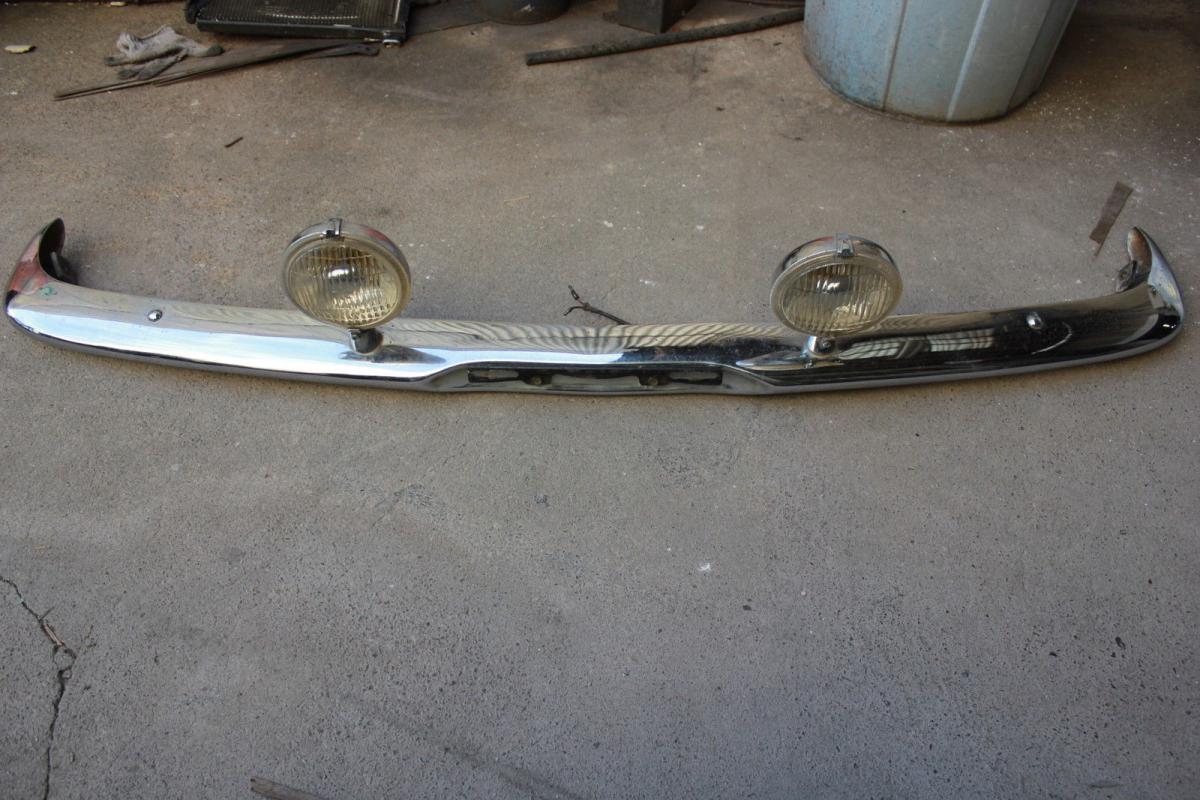

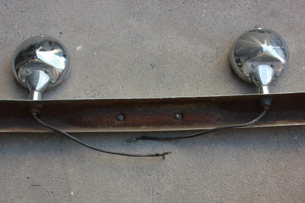

  6. I recently purchased an Ke1x foglight fitted front bumper OEM my query is how where these wired? was it straight into the high beams? was it on a separate factory switch?
