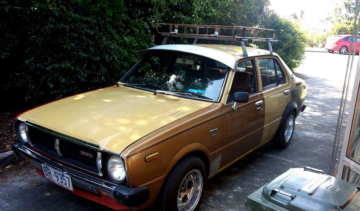

  11. pozza123 replied to pozza123's topic in Rollaclub Rides
    Had a good day out today in the rolla!

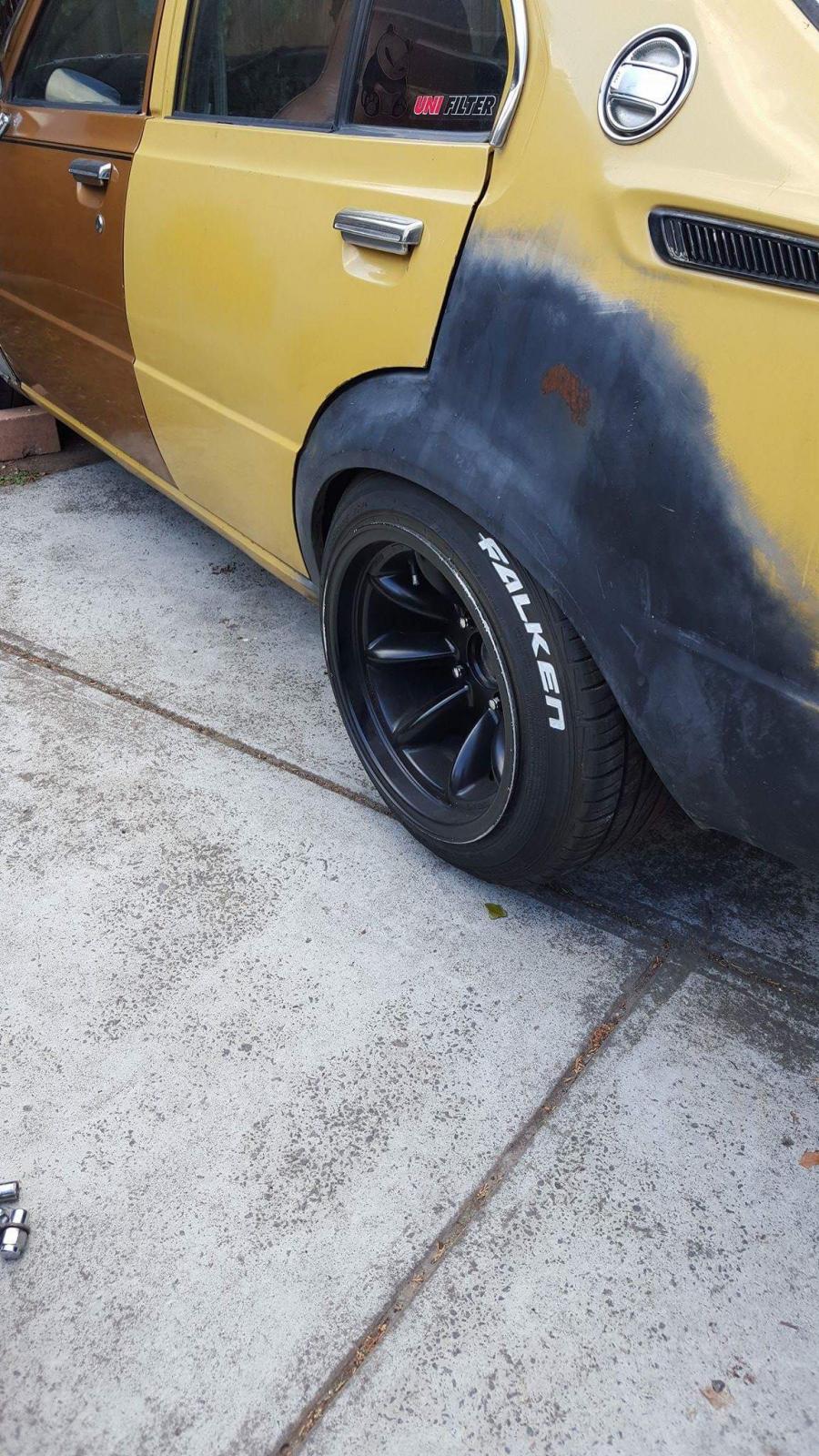

  23. pozza123 replied to pozza123's topic in Rollaclub Rides
    Tried one of the wheels off my celica on the little rolla today 15x10 -26 superlight looks pretty good! Might have too try the front ones as well :)
