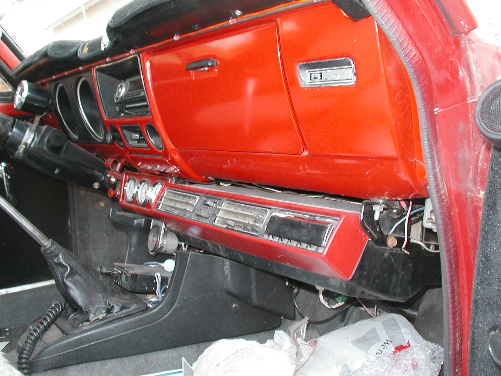

the '74 TE28 i had had non-dealer a/c
i say this because i am sure it didn't leave the factory with a/c, but it wasn't put on by the dealer, probably done when it arrived at the docks
it's all nippondenso........
Yeah that looks like the same setup I had on a datsun 120Y... generic aftermarket gear with compressor brackets etc to suit particular models.
works well, but not integrated with factory controls and seriously reduces space on the passenger side

yeah except that THIS unit is genuine toyota; it's the same one used on all toytas up until '71 (except crown) and corollas until '75, hiluxes until '78.......HERE

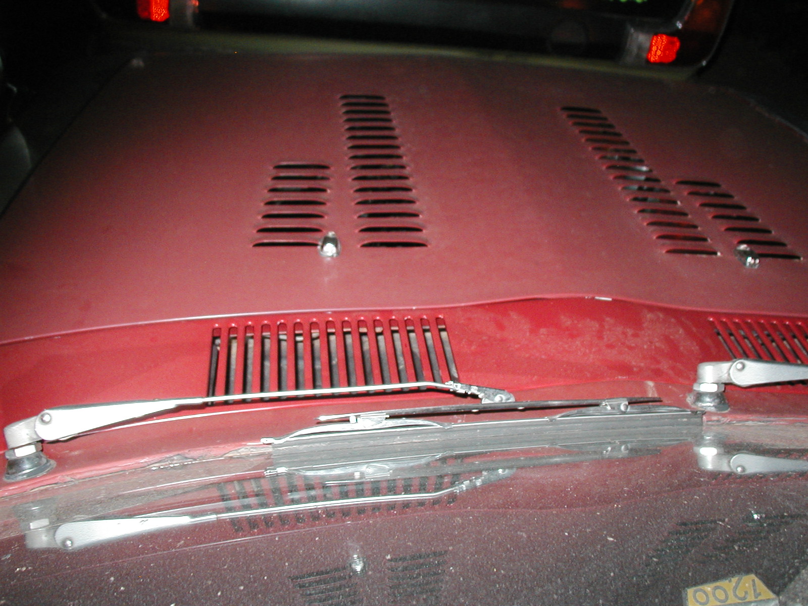

this one used copper lines, the evap unit is shit, doesn't cool that well at idle- 20-30* less than ambient temp, but it's a constant 35-40* coming out of the vents going down the highway at 90*
i added the louvres to the hood for a huge improvement
