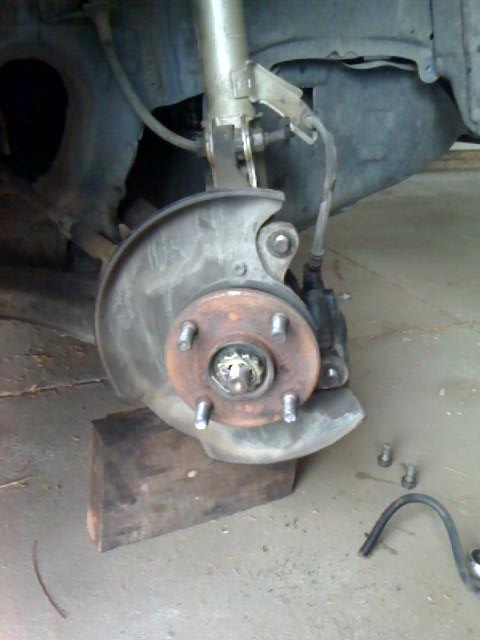

Before you pull apart your car get some brake fluid if you do it my way.
After you have taken the wheel off undo the brake hose from the caliper and fluid will go every where just don't let it touch your paint work and make sure you have the right sized spanner so you don't round off the hose nut.
Undo the two bolts on the back of the caliper and the caliper will come off and the pads will either fall out or little wire clips holding them in place.
This is what it will look like once the caliper is removes and the rotor(disc) removed. You can see the hose is still attached but it is easier to get it undone while the caliper is still on the car.
once you have painted the calipers and they are dry put them back on in reverse order and refill the brake resivior under the bonnet and bleed the system with another person to help you as it easier with 2.
hope i helped Des :P
