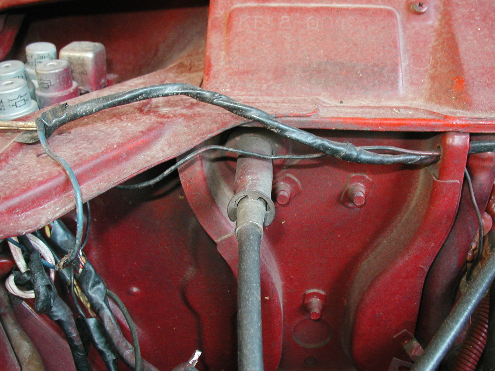

mikeys toy[RL] Posted December 31, 2006 Report Posted December 31, 2006 when I replaced the K40 in daisy (1969 ke18) with an '82 starlet (kp61) k50, the forks were different; I had to make a spacer on my firewall Quote
