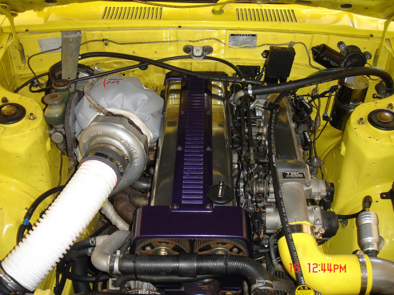

Well you will have 2 or 3 cylinders in front of the crossmember which will upset it, A 1jz into a corolla will not be cheap.
A 1ggte looks very tight in a Ke70/Ae71 engine bay so a 1jz would be a killer to fit in.
Think about the things that have to be done to fit it in:
Intercooler + piping.
Wiring + aftermarket computer.
Gearbox tunnel mods + custom crossmember.
Custom engine mounts or crossmember.
Custom tail shaft.
Will need a much stronger diff ie hilux.
Fuel system upgrades.
Exhaust.
Radiator will most likely have to be mounted on the other side of the radiator support panel.
Stock suspension wont do.
Brakes will need to be upgraded.
This is a Member from Toymods with Xt130 corona with a 1jz in it, Mind you Coronas are a bigger car but you get the idea.
