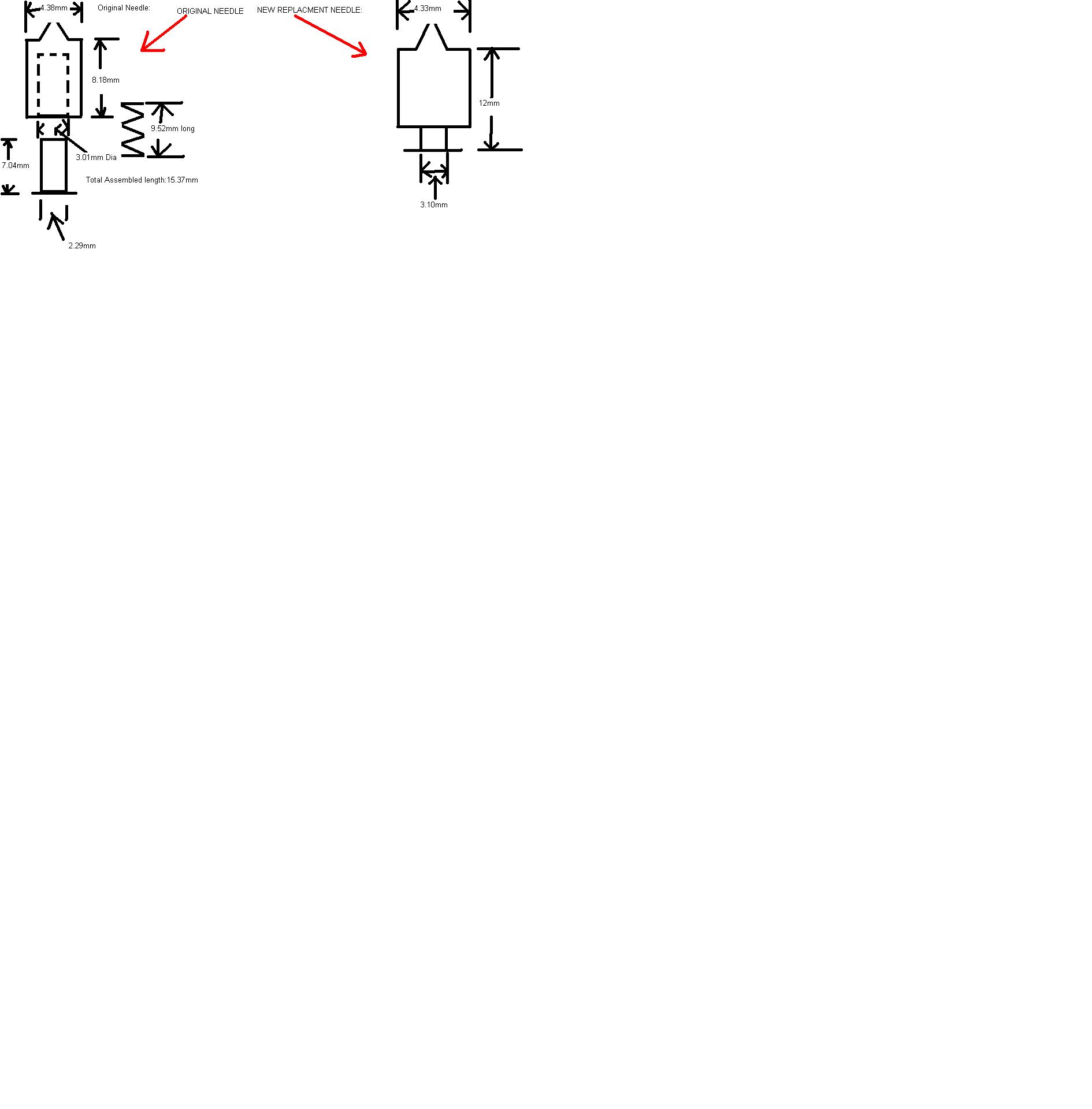

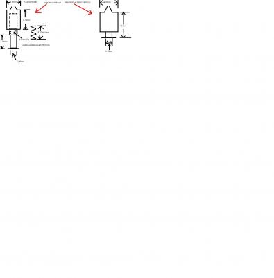

And one more note I measured the original needle that was sitting in the no pulled apart carby I got in the parts box with the car and compared it to a new needle I bough that should be a direct replacement which isn't. The picture of that is below.
