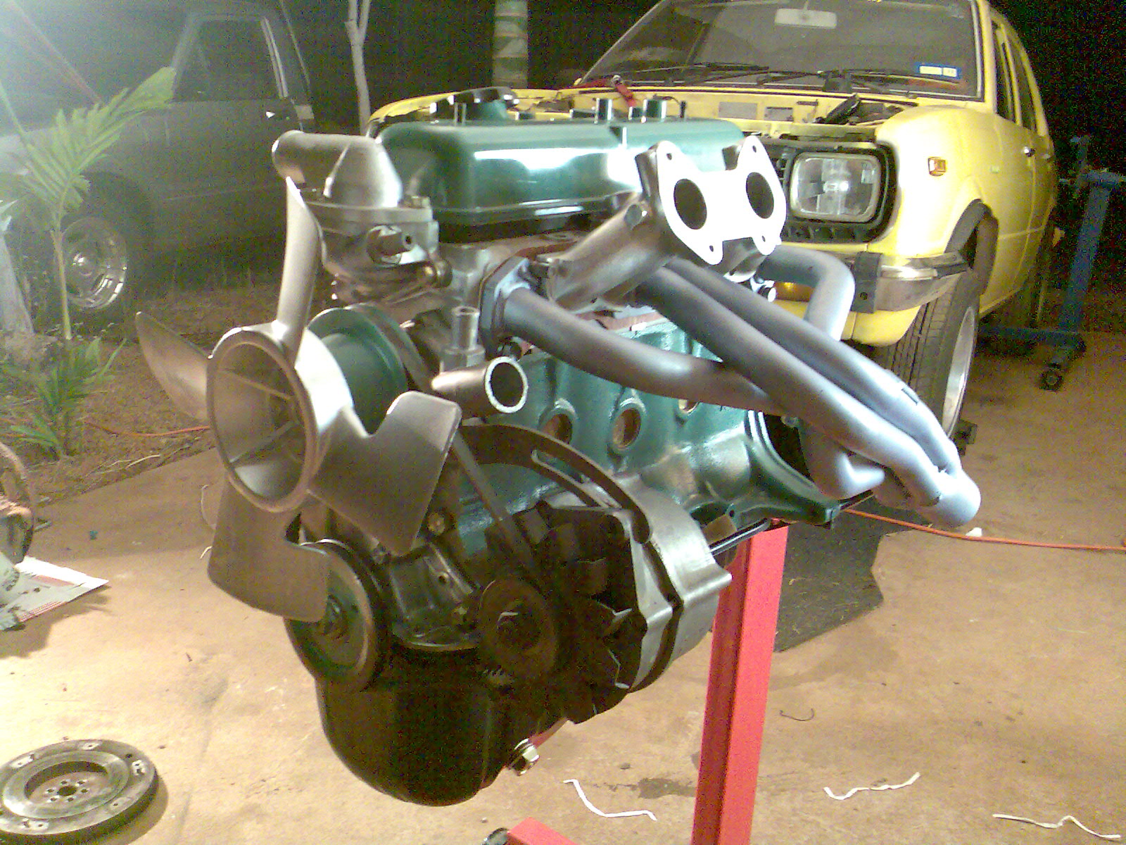

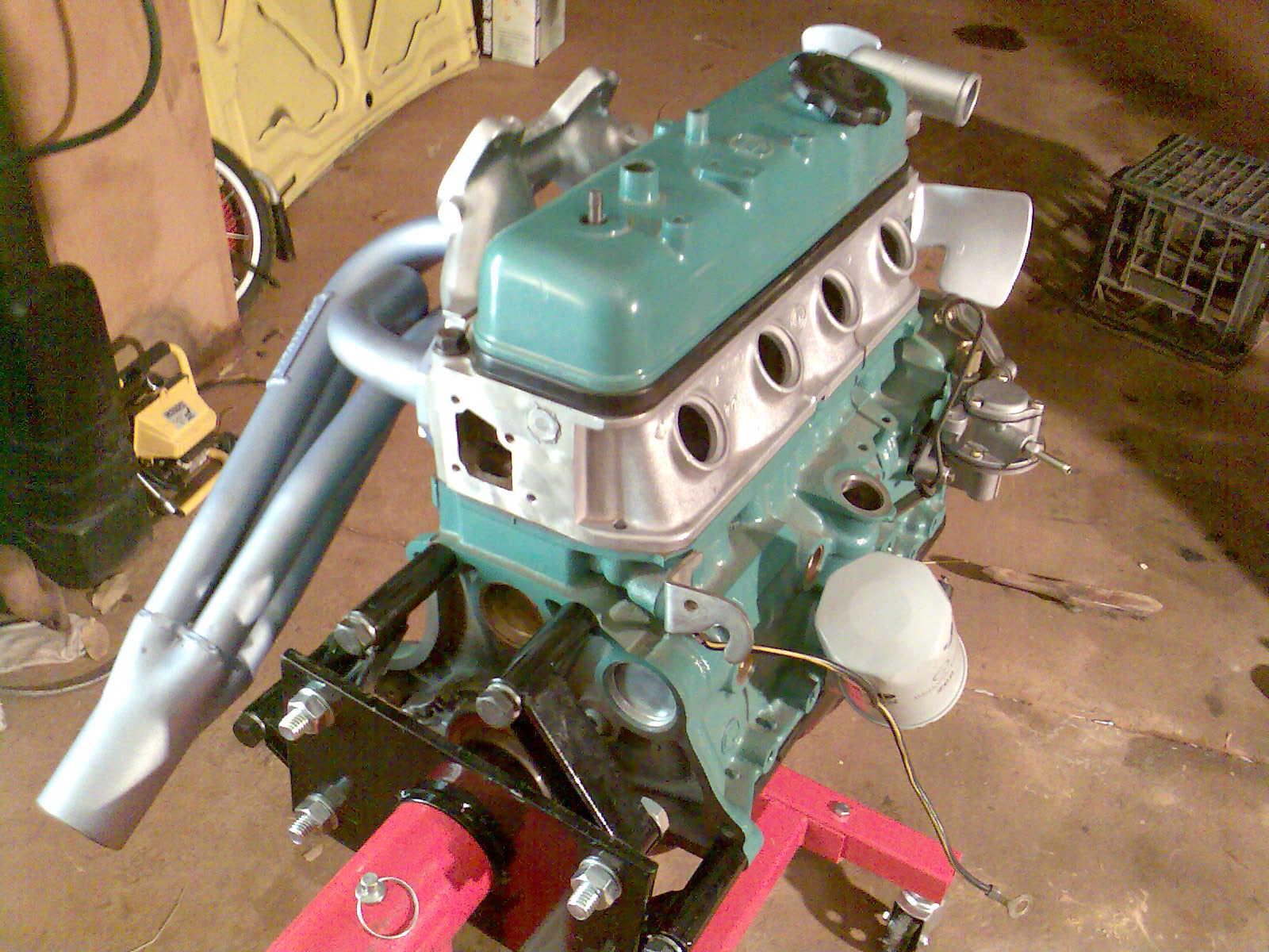

Hi everyone.
I have a fully rebuilt and mildly worked 4K engine.
It has flat top pistons
20thou oversize
Custom made billet cam

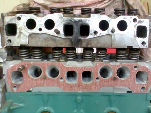

Extensively ported head
Pacemaker extractors
and all the inside stuff done to it
I bought the engine like this and am continuing the project
Since owning it ive put a:
new fuel pump on
dizzy, new points, cap, rotor and polished the dizzy
alternator
Rockers
and other odds and ends.
The engine is going in my 81 KE55.
I'm after a couple new parts, none available genuine so if you know of where some are available (NEW only) then let me know - include a web address or phone number.
Intake/Exhaust manifold studs and nuts
Head Bolts
Lifters
Push Rods
anything you can recommend :P
Cheers, rolla.

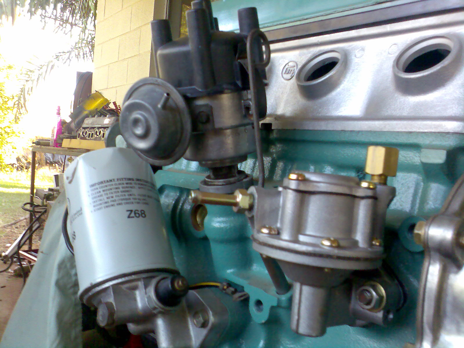

One other thing I might suggest, depending on what this car will be used for, is an oil filter sandwich plate. I bought mine from Bursons for $80, but they do look after me. heres a pic of mine....

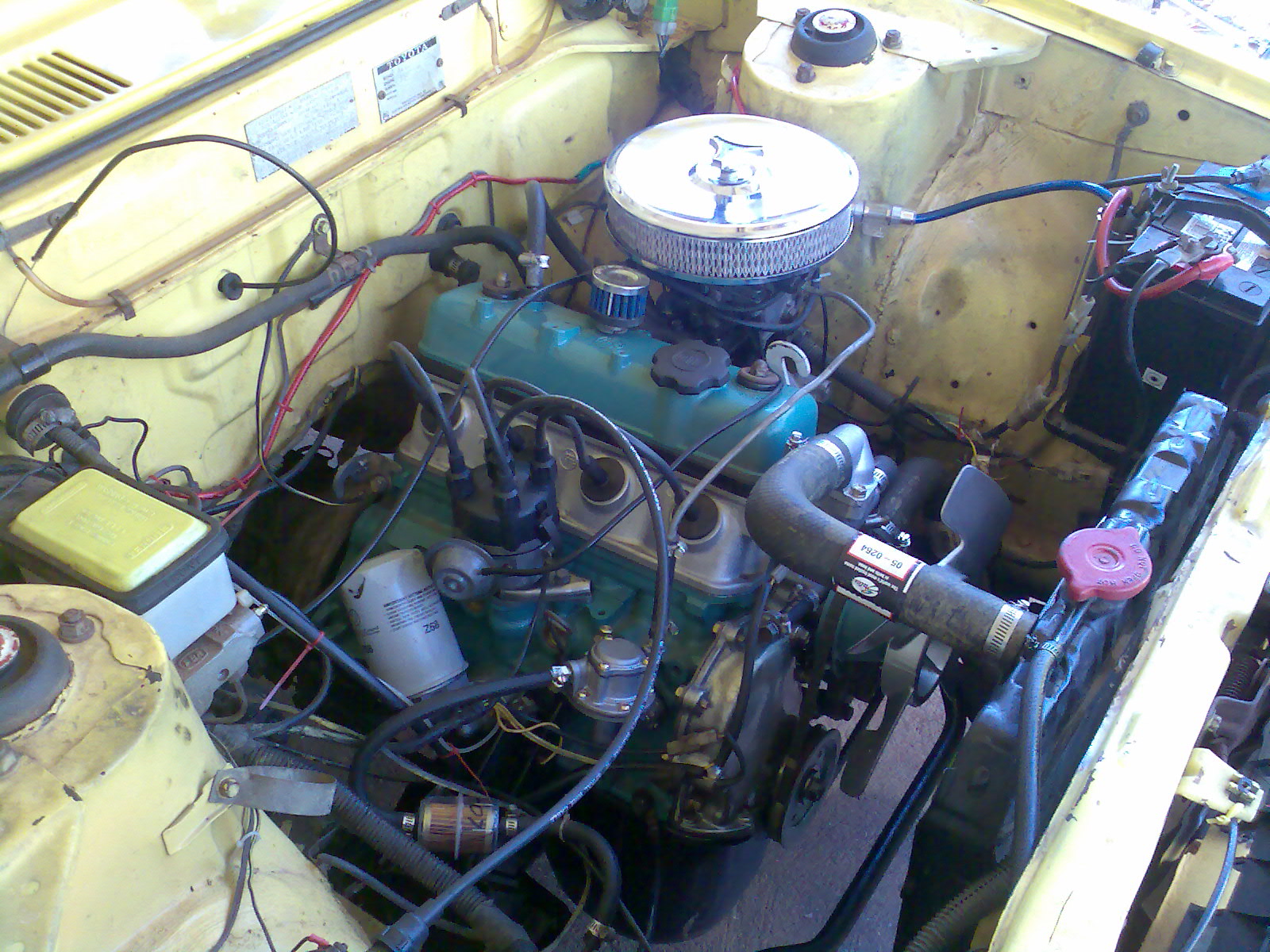

hey everyone, the engine is in! Runs sweet, all new points, plugs, leads, condensor, all the stuff! Idles at 900RPM, snaps to 5000rpm, getting the exhaust made for it this week $500 or so later!
Running a downdraught weber of some sort?
I have a Lynx Twin SU Manifold, brand new if you're interested. Click on the writing in my signature and it will take you to the page with all the details.
Cheers
Raven

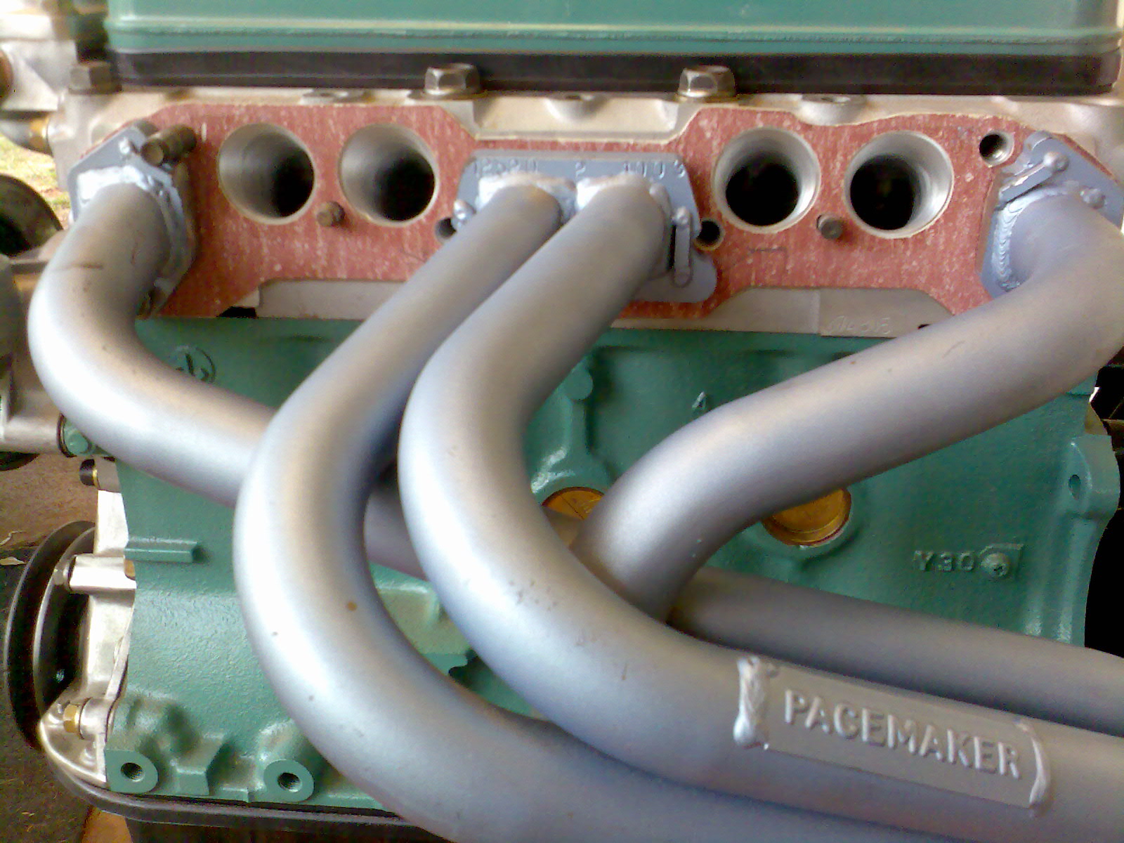

I'm going to run a redline manifold and Delorto double barrel carby. Just getting the linkages for 4K made for it now. I'm using the standard manifold and carby at the moment, the carby actully cannot give enough fuel!
The head has been ported so much that the pacemaker extractors actually act as restriction because their not wide enough lol!
