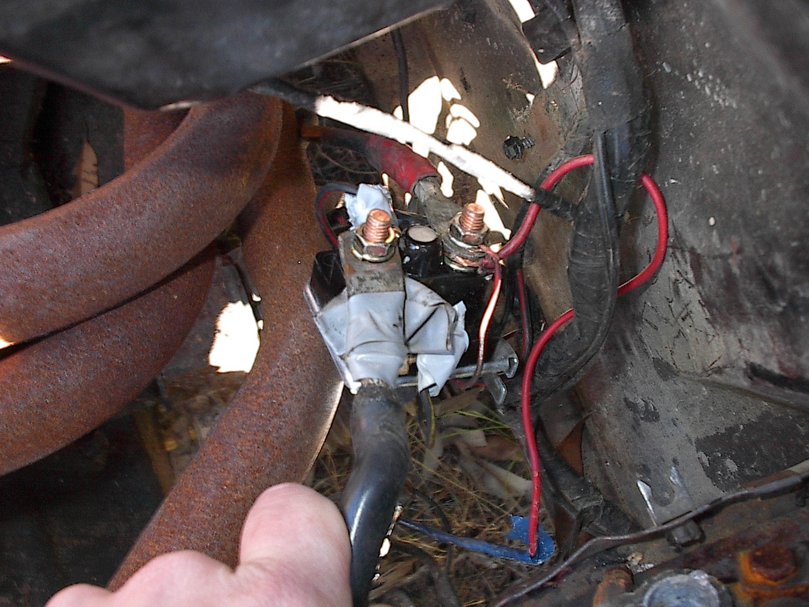

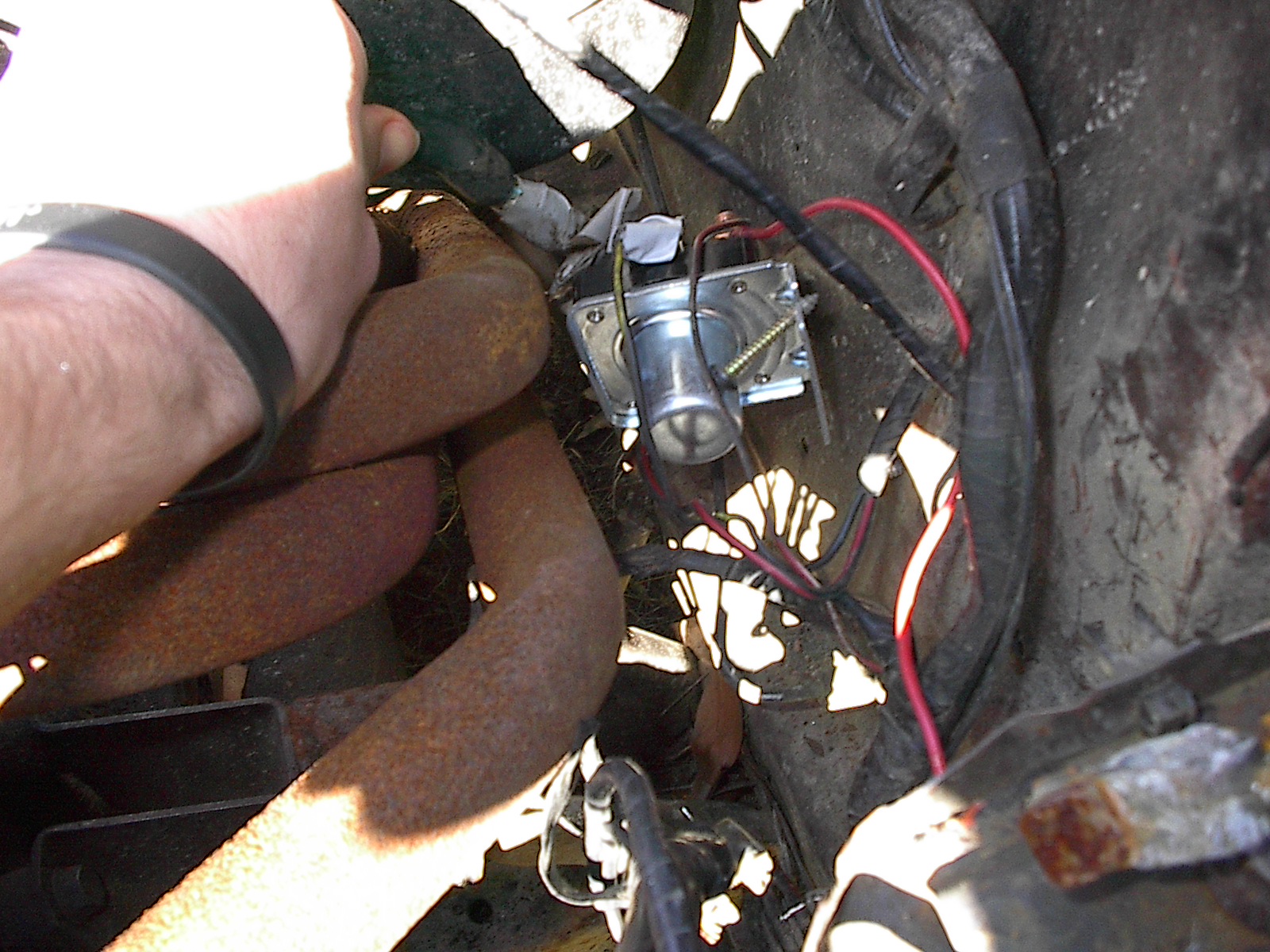

Mushroom Posted July 5, 2007 Report Share Posted July 5, 2007 Hey guys, as the post says above I'm asking for a little bit of help with my escort, its a 1980 ford escort sedan 4dr (ill try and get some pics up tomorrow) , thats all i know about it, and the solenoid has broken, I'm guessing its called the starter solenoid, i bought a new one, but stupid me didnt take a picture of it before i pulled all the wires off of it to take it into the shop to get a new one, and now i have no idea where which wires are supposed to go, if any one know where the wires are supposed to go it would be a great help, if not if somebody could point me in the right direction that would be great too, thanks guys. cheers harley oh and the pic is of the solenoid that i bought, Quote Link to comment Share on other sites More sharing options...

Mushroom Posted July 8, 2007 Author Report Share Posted July 8, 2007 here is a pic of the actual car that we kinda improved on, and the second photo is of the soloinoid, i have been told its part of the starter motor but its all the way over near the manifold, if you need any more pics let us know. and if no one has any idea thats cool ill figure out a way haha, cheers for your time guys, harley Quote Link to comment Share on other sites More sharing options...

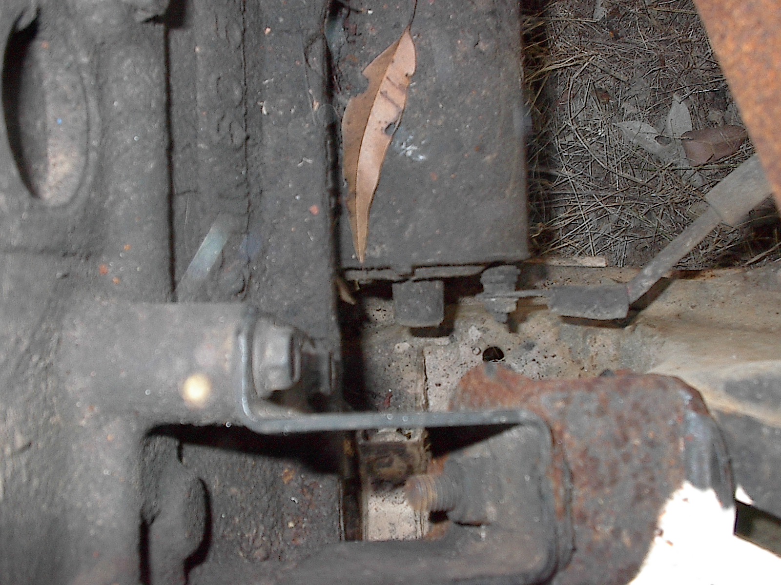

Mushroom Posted July 8, 2007 Author Report Share Posted July 8, 2007 and a pic of the starter motor and a pic of my dodgy wiring attempting to remember how it all went together, and the car has a full inside and outside rollacage, 4 point harnesses and bucket seats and dual tires. Quote Link to comment Share on other sites More sharing options...
Medicine_Man Posted July 8, 2007 Report Share Posted July 8, 2007 It should work like any other relay, 2 sides, The control circuit and the load circuit. The heavy gauge wire should be the load side - One from the battery, The other to the starter (Goes to the two big terminals). Also should have an earth (Or earth to the body) and the signal wire that activates the solenoid.. I can't say I've come across a starter with an external solenoid, Most starter solenoids are attached to the starter. Or is this just being used like a relay to get good power to the starter? Quote Link to comment Share on other sites More sharing options...
Mushroom Posted July 8, 2007 Author Report Share Posted July 8, 2007 yea after talking to some guys today i think its being used as a relay to the starter motor Quote Link to comment Share on other sites More sharing options...
Medicine_Man Posted July 8, 2007 Report Share Posted July 8, 2007 Yeah, Makes more sense to me that way. Didn't it come with instructions? Sometimes they print numbers near the pins to indicate what they do.. Any closer pictures of all the contacts on the solenoid? Quote Link to comment Share on other sites More sharing options...
