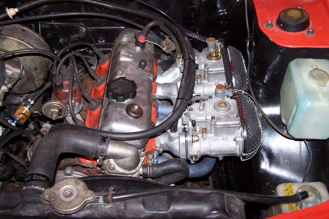

here is a pic of my 4k with worked head 30/70 cam and twin 40mm webers....goes very well indeed....as someone said stick with the webers
Edited by corolla-ute
That's purdy! :wink: Any idea how many ponies?
Mike
