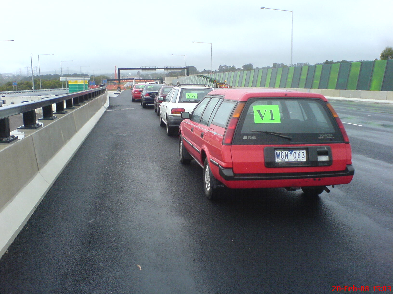

In the mean time i've been using the cheap to run rolla for Eastlink testing, see photo.
Also check out my cool number plate, that was a fluke, it is not personalised.
