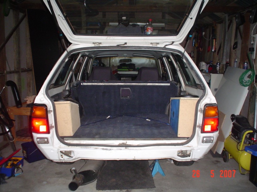

September 27, 200719 yr comment_200246 You can replace the factory 4'' speakers in the footwells, its a bit of stuffing around but i actually managed to get some sony 6'' in there. For the boot Strathfield have 6x9 speaker boxes at the moment for $25 which is about half price and will save you a lot of trouble. Report

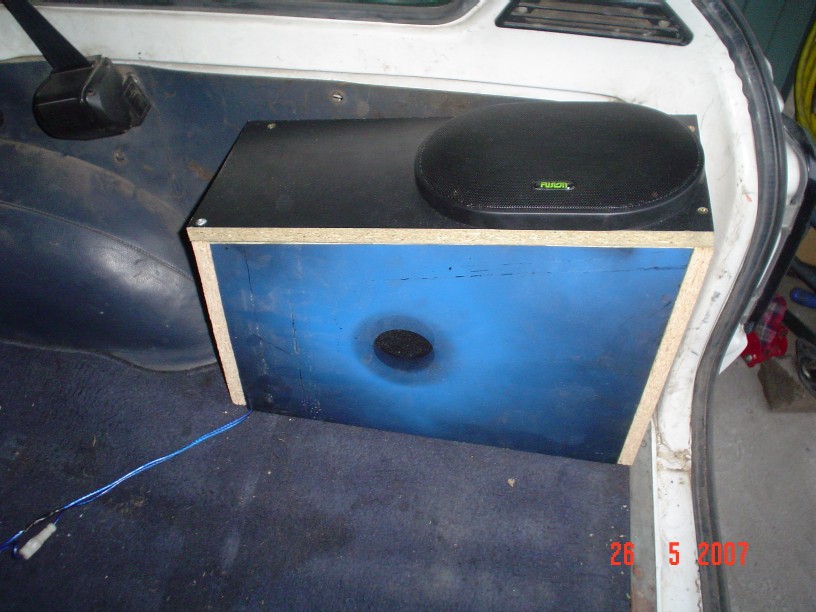

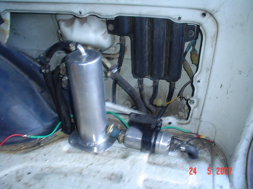

October 3, 200719 yr comment_201484 I built my own 6x9 speaker boxes, there big and ugly but it's whats inside that counts :no: considering I don't actually have any 6x9 speakers Those prefab boxes from strathfield would probably be the easiest option, cause there's stuff all room inside the inner guards. Passenger side has a wheel removing things and drivers side has all that shit in the above pic. Cheers Harvo Report
