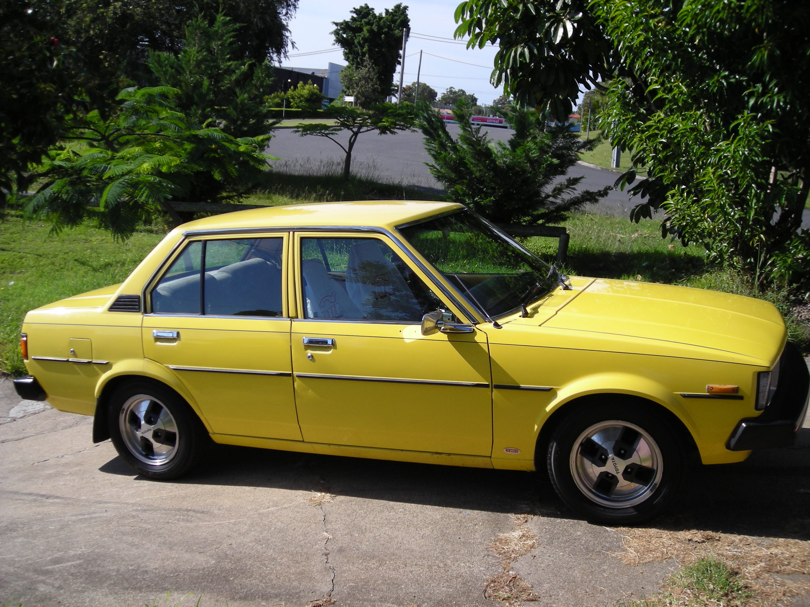

  7. Howdy guys I thought i'd post a bit of information on my rolla. She's beautiful! :yes: I bought her from an older guy who's been racing for about 15 years. He used to race a datto 1600, sold it and then built this to replace it. It came with a build-up logbook with photo's, part numbers and all the specifications. Its running a 5k engine that has: - +.020 thou. cast hypotec pistons - king competition big end and main bearings - 308' wade camshaft - Precision solid lifters - Roll master dual timing chain - extended capacity sump with windage tray - lightened flywheel - Excedy sports clutch - 3k bigport head with modified ports and bowls - 38mm inlet valves and 31mm exhaust valves - crow valve springs - 12'' thermo fan - bosch 'lectronic ignition - match ported 4-1 headers - match ported inlet mainfold - twin 40mm dellotos - comp unifilter - tuned length ram tubes - carter fuel pump - 3/8'' fuel tank pick-ups - lovells springs and monroe gt shocks - 2.5'' zorst - uuuuugly celica rims :hmm: Makes about 135hp at the engine. :o Sounds hot. It hasnt got any stereo at the moment so thats high on the list of things to do, and then really the only other things i would like are some nicer wheels and some nicer front seats. Its pretty granny spec from the outside as you can see.
