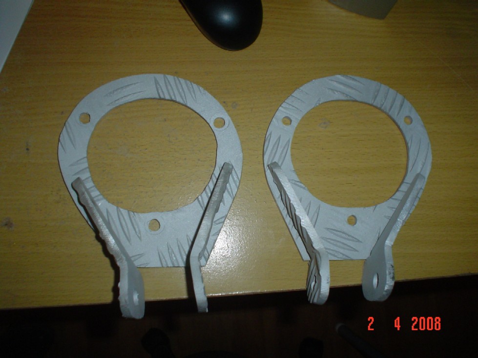

  23. I'm making my own at the moment out of alloy for my KE70. I made a template out of cardboard transfered that onto the sheet of alloy and cut it out with a jig saw, to easy :lolcry: I'm going to make it solid for now and convert it to an adjustable type later on with a turn buckle in the center of it. These are the brackets so far, Cheers Dan
