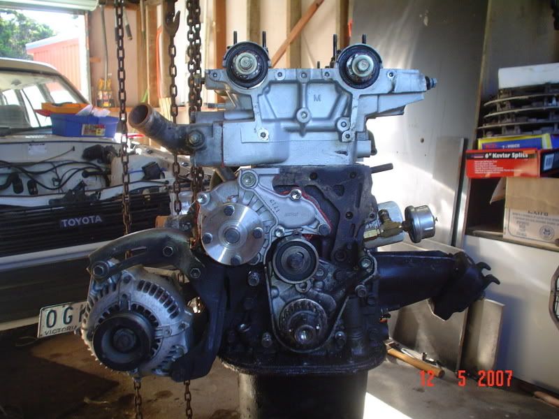

Not sure if it's FWD or RWD I think it's the RWD bit longer are they? and are the studs in the block? cause mines bolted on, Don't recall seeing any studs, why do they need to be changed over anyway? clearance issues? My water pump

Gotta have something different out of 3 4AG's (1 to be 7AG).
Yeah RWD is longer, Nah the studs are where the fan bolts to, I was thinkin of removing the studs from mine and getting some nice chrome dome nuts.
RWD on the left.
