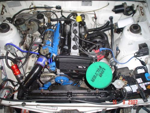

So, all the time and money spent modding the computer/small port dizzy was a wast. It now has a custom trigger wheel/haul effect? sensor spinning off the crank pulley which also had to be modified along with the pulley on the alternator for clearance. It was firing randomly at start-up/low rpm which wasn't noticeable with the dizzy but with the coil packs it was a different story.
Well this is what the engine bay looked like when it left, still so much to do, it's depressing to look at :yes:

Good news is it's fixed and running again as of last weekend, was a dodgy earth connection :laff:
She made 240hp just shy of 180rwkw and was a real f@#kin handful when you open her up, comes on boost hard with the big high flowed turbo on there. does suffer a bit of lag tho, but you get that.
