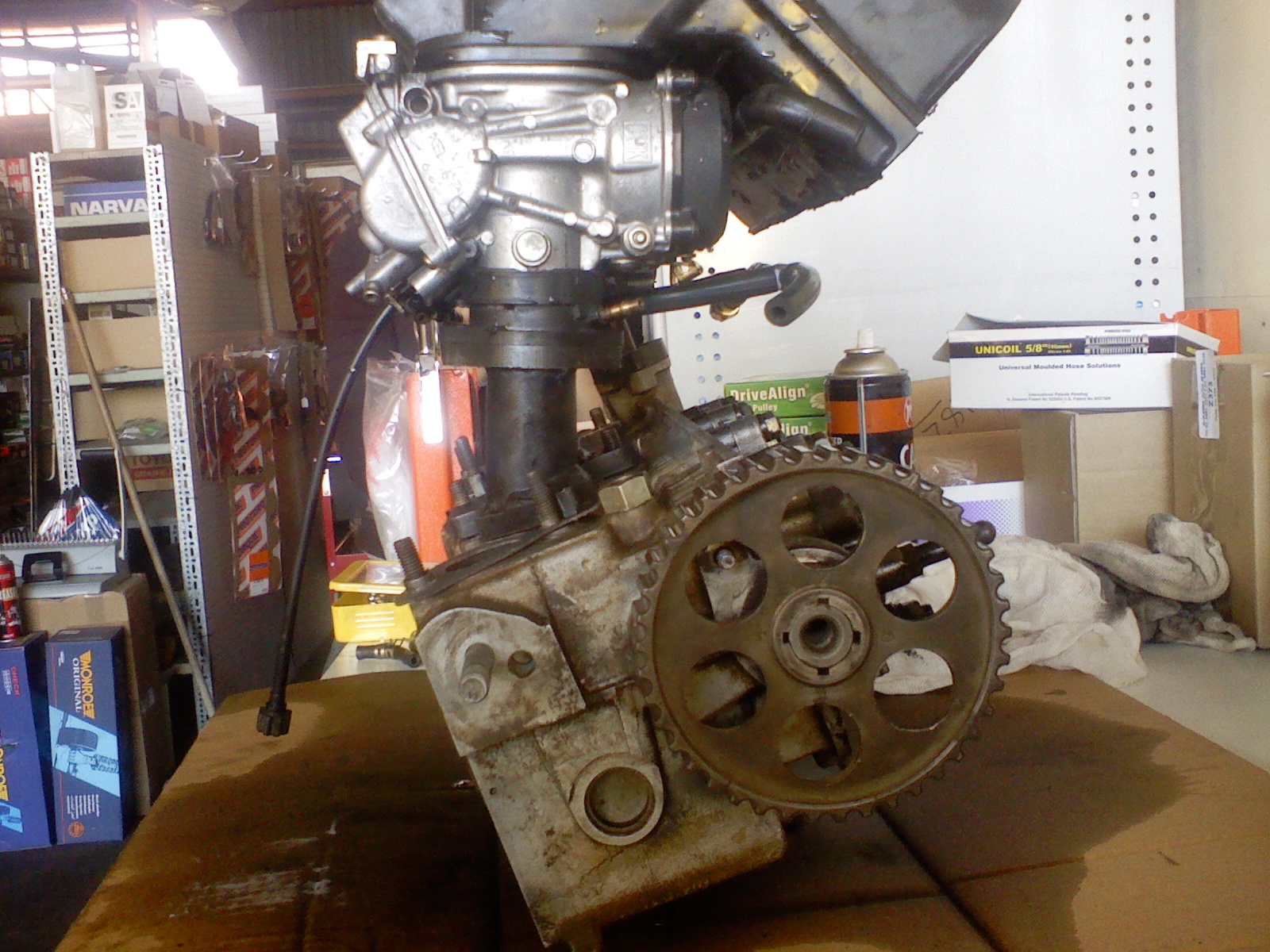

just a quick question, what is that thing that gose from between the carbs and underneath them? kinda look like a electrical connection, which if it is you may run into problems.

the thing on the bottom is the idle adjustment and they are gravity fed no fuel pump.

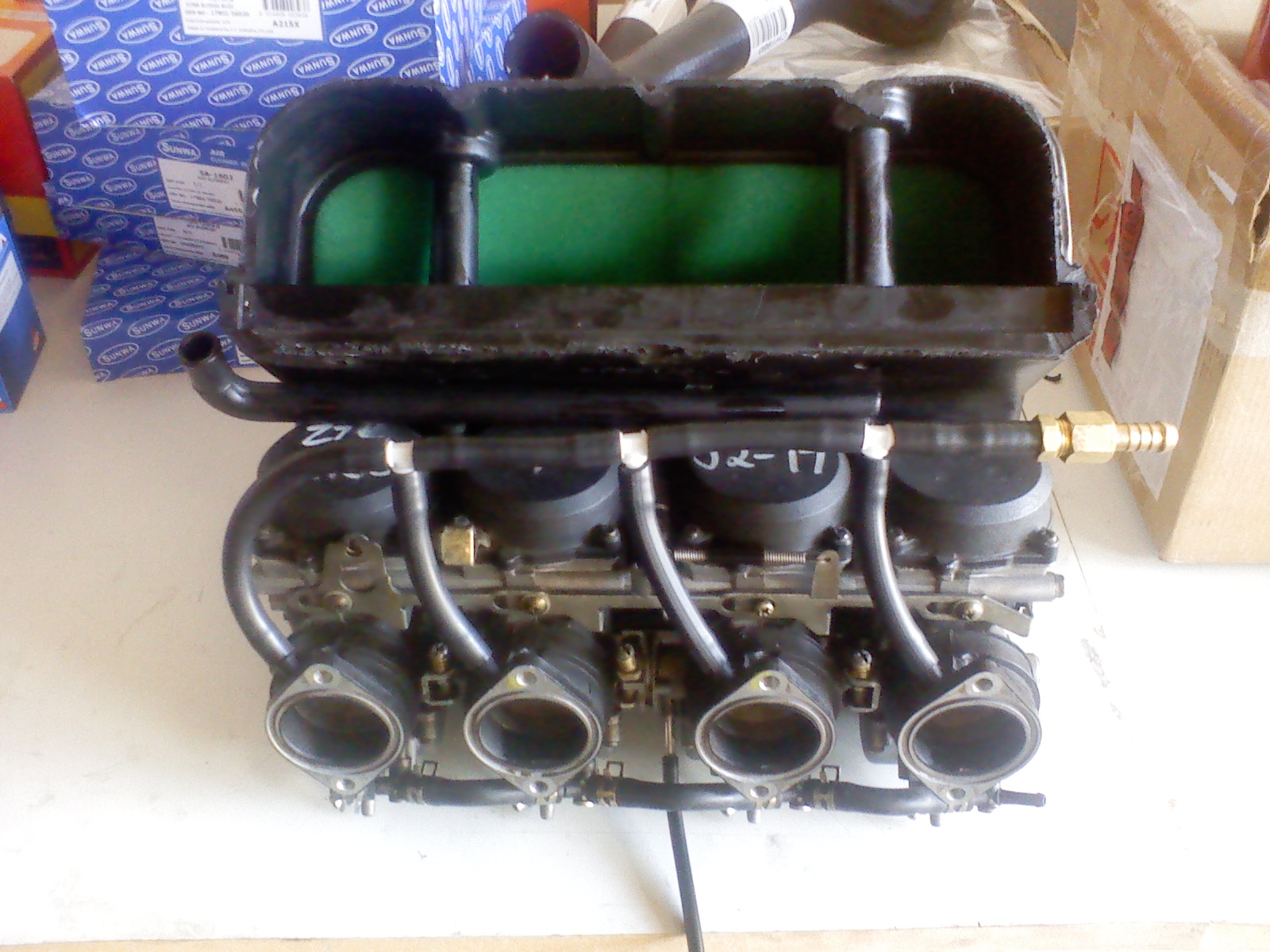

Their Keihin carburettors, very nice...

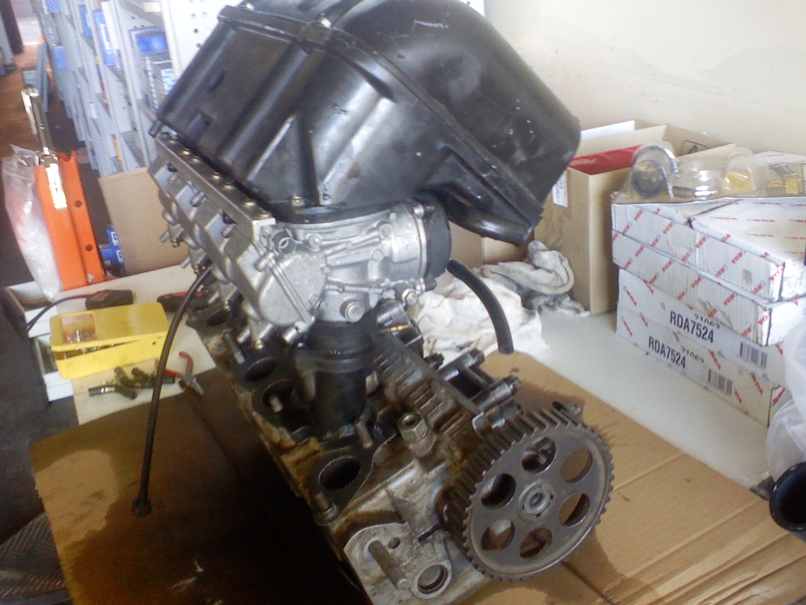

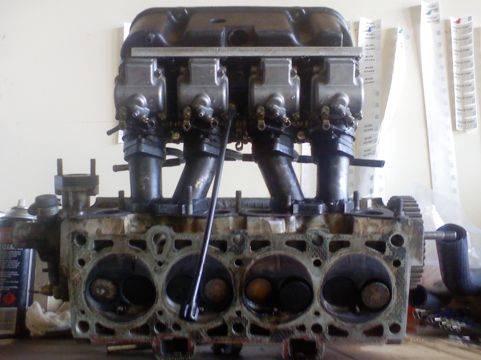

How you going to fit them to a manifold ?
I'm doin the exact same thing to my worked 4k, I'm using 41mm quads from a zzr1100. and getting a manifold made up to suit from a mate.
As for the manifold I had an idea to run it similar to the EFI 4ks and have long runners and the carbs sitting near the rocker cover. Means very good low end torque with still very good top end. Will basically have to make my own manifold but I'm not worried was origionally going to use twin SUs with a similar setup.
You might even have to down-jet carbs off a 1100.
ZZR1100 carbs for the win!!! That's what we did with the Samara Rally Car, and it transformed it into a weapon. More torque and HP. Most moto carbs are happy with about 3psi, and aren't really affected by mounting angle within reason... If you have a problem with fuel pressure (or want to experiment) I've also got Speco Fuel Pressure regs on the shelf for $70, adjustable 1-6psi...
We just got an exhaust fabricator to make up the inlet manifold, and did an excellent job! We found the 1100 carbs worked well on the 1300 Samara, but it did rev to 9,000rpm...
