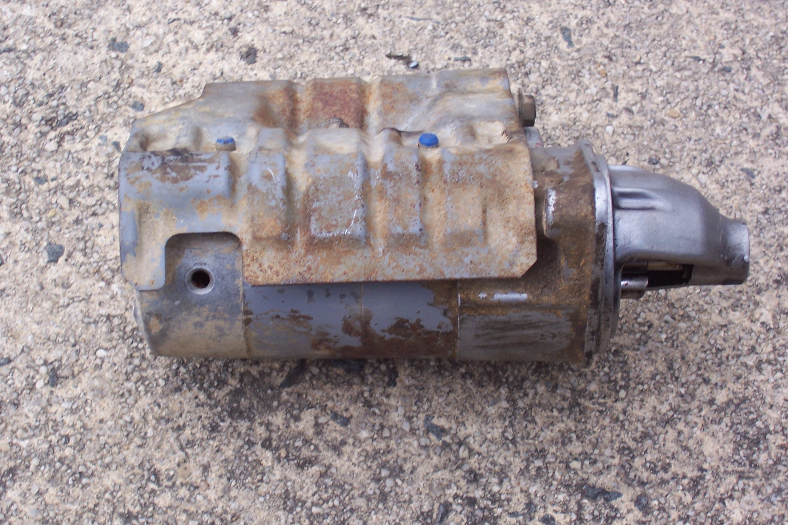

Hi, bought myself a 5k gear reduction starter today and was wondering what goes in this hole or what it is for.
Sure that is a reduction gear starter? Looks more like the standard planetary type starter to me.. (More pics to confirm?)
There is usually a plastic drain plug that goes in that hole, don't freak out about it not being there..

Also as stated that starter of yours doesn't look like a reduction type. All 5K I have seen wreckers bough had standard types so some where along lines have been changed from gear reduction.

Got the starter motor in today much smaller and lighter than the old one. It works just fine, spins the engine over much faster. Just have to rub the key and away she goes, no more clicking or winding over. :'(
