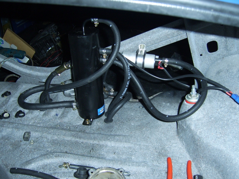

We mounted Teddy's surge tank and pumps in his boot, Eventually we will make a cover for them..

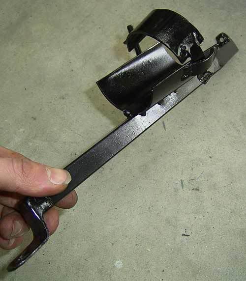

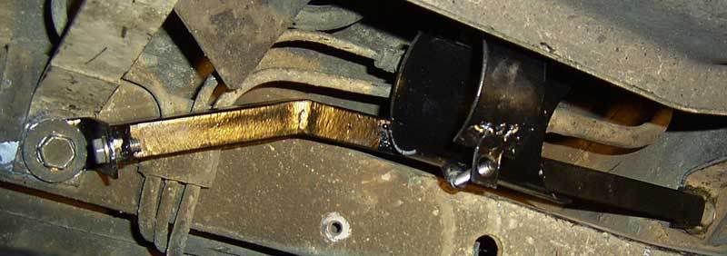

I made a 2 piece cro-mo bracket for mine, a bit obsessive I must admit.
picy:
I have heard of above one of the axle tubes of the diff under the floor, on the bottom of the car or cable tied next to the tank
edit: oh and I made it two pieces so the fuel tank doesnt hit me in the head when I install it. Have a look where it bolts up to see it.
Edited by Sam_Q
S#!t, that's heaps fancy sam! Nice work, looks like it'd do the job nicely! Unfortunately i don't have the patience to slap something like that together :hmm:

Just for reference, this is what i was running prior to a couple of weekends ago:
Was never comfortbale having all that in the boot, and the noise of the pickup was annoying :hmm:
Teddy's Setup..
looks good - the inboot installs are good for the race look, but i was over it in a couple of weeks, plus the noises.
