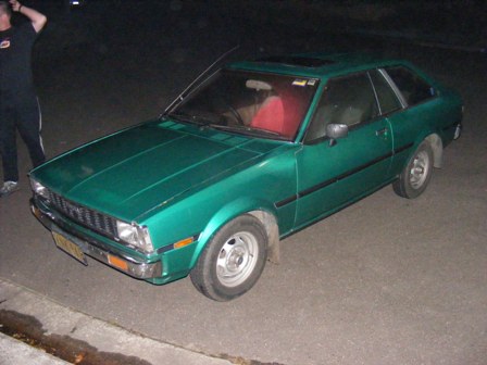

BTW the bloke that came to diagnose my car now drives a overrated T-18 (no rust, interior perfect full instrument dash, it is f#$king awesome) and he said when he is ready to sell it that i will be first on the list to buy
I took some photos of it and will post them in due course
Edited by KE ping it real
Check this beast out - hopefully it will be a second project down the track
Tell me what you think
