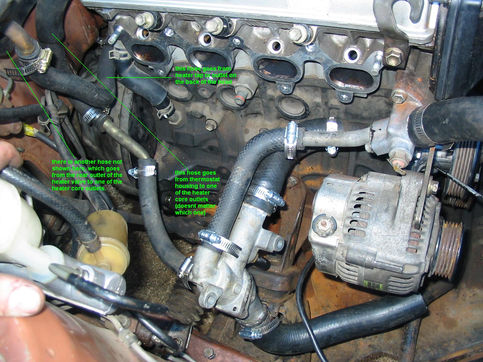

TRD_AE86_GTS Posted October 20, 2008 Report Posted October 20, 2008 My Remote Termostat Installation: i buy this part from 4A but i don't know the year of the engine and the model Termostat Housing I think this is fine, if I'm wrong please tell me

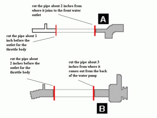

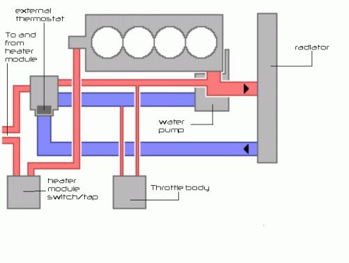

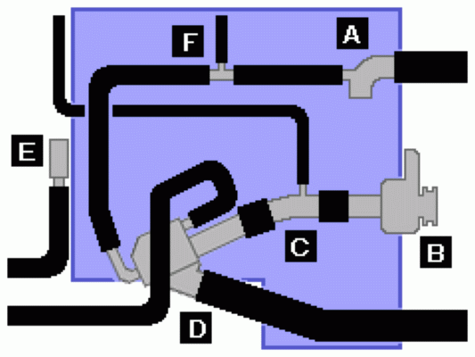

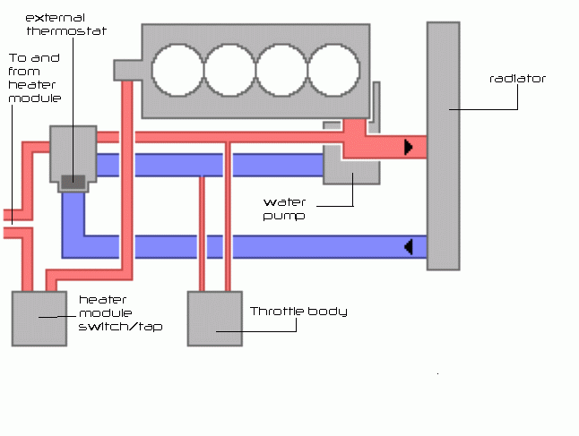

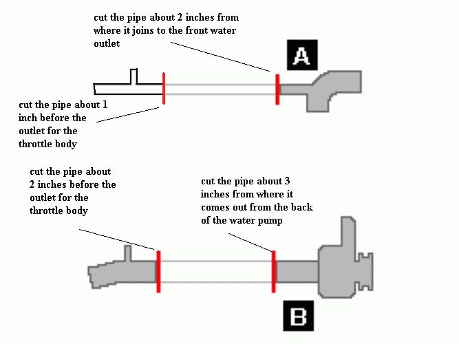

kiahn Posted June 14, 2009 Report Posted June 14, 2009 (edited) the witzl made this for me because i didnt know how to allow for the heater module it really helped me so i hope it serves well to others the setup most people have shown are suitable for 100kw motors, i have done a bluetop(86kw) motor and have come out with these: the pics are the ones from the FAQ only in english. NOT a direct translation but this is how i have done it and it works overrated this is one view of how it is setup and how it should all flow and this is how i cut the pipes to make it fit (NOTE: you will need some 90degree bends to make it clear different parts of the motor) enjoy Edited July 29, 2009 by kiahn
