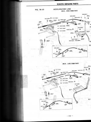

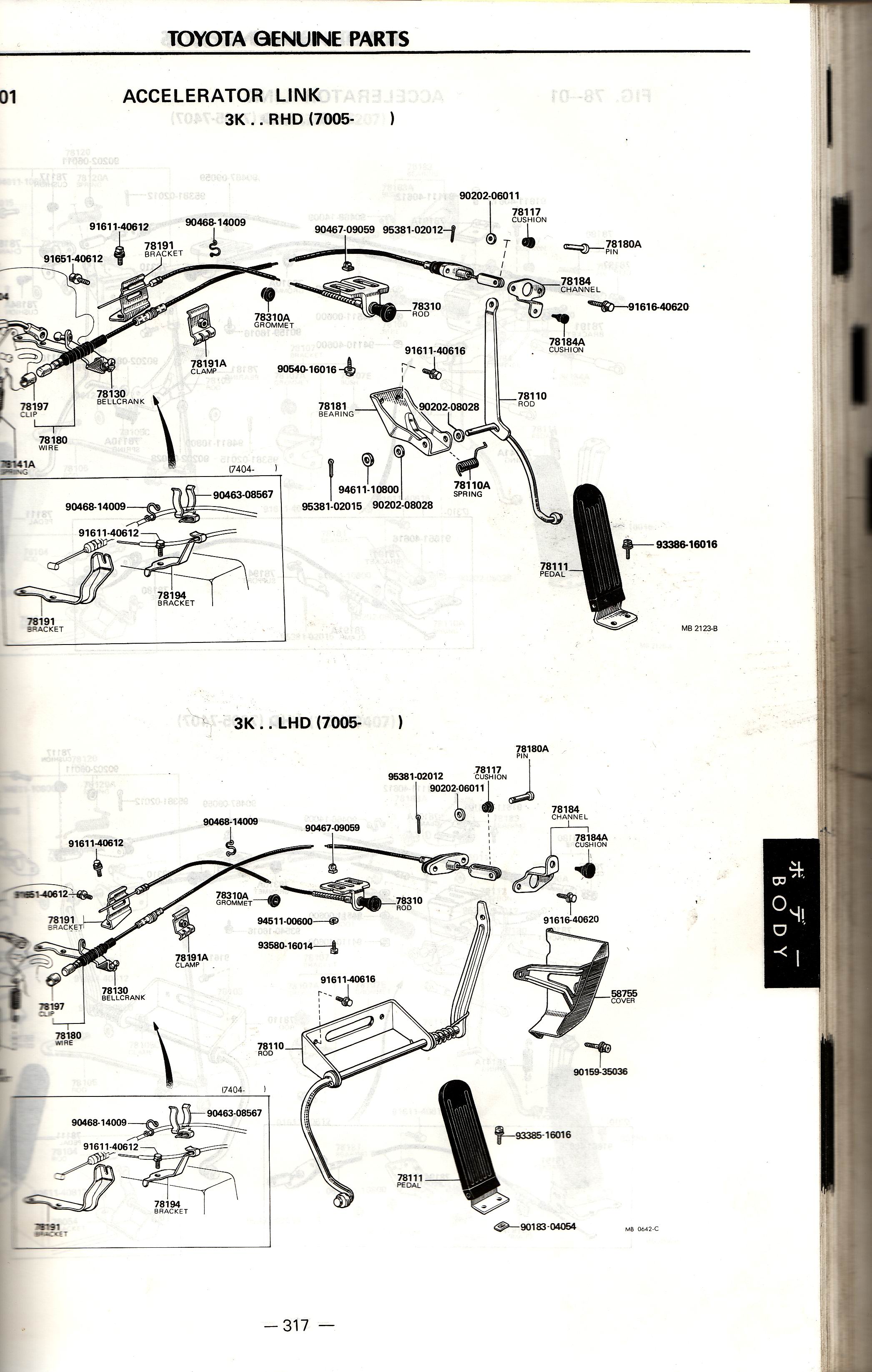

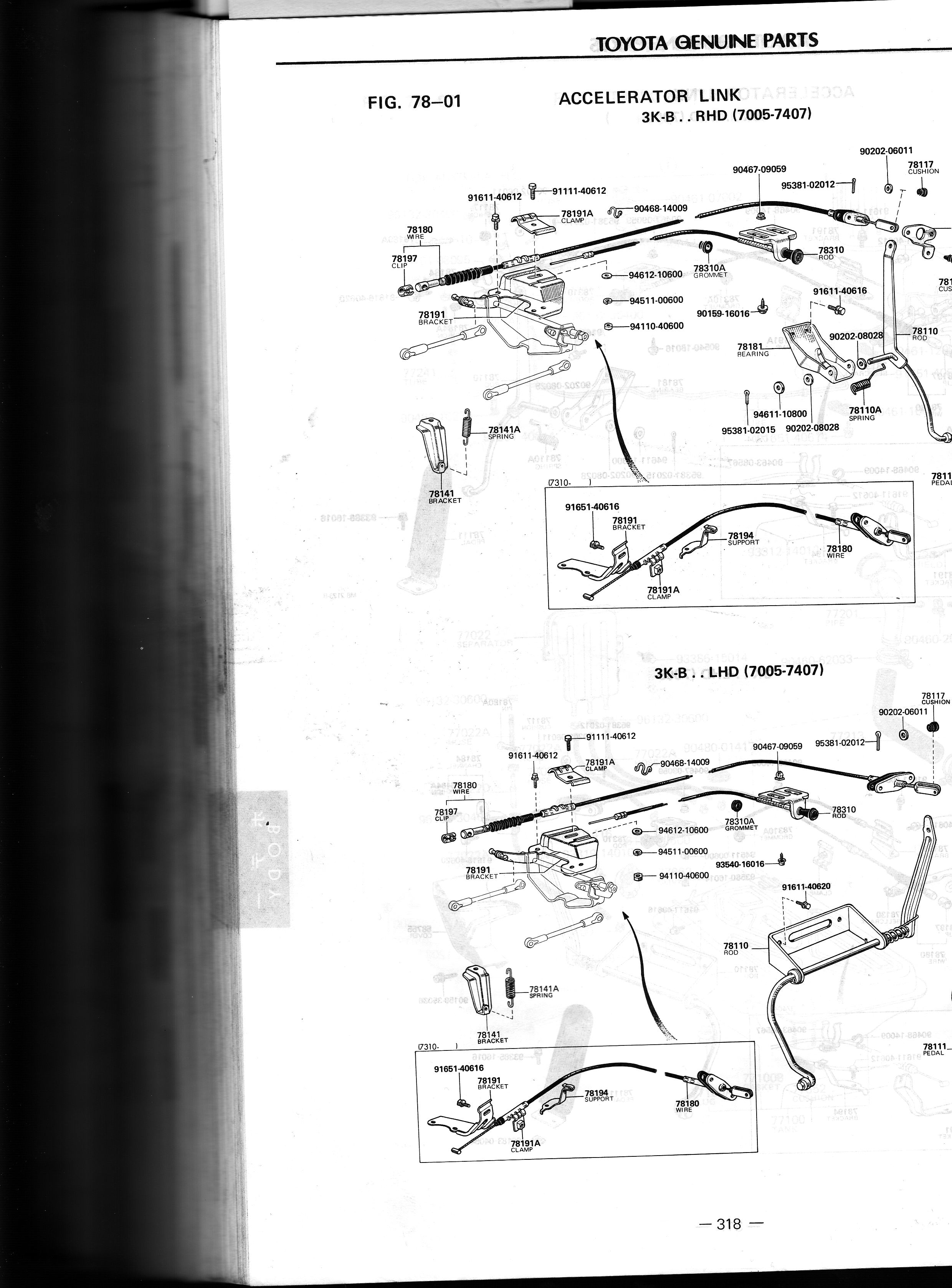

Part No. 78180
Seams like the cable is used for both the single and twin carby
The parts catalogue i've got is for the e20, e30 and te47 series
Hope that helps a bit

As far as I can make out it would be:
78180 - 12060
this is for "KE20, 20B,25B..RHD..MTM..4F..SL"
Also listed is
78180 - 12040 which is for KE2#...RHD.. -SL
One of my books gives specs for different models and the SL version features a 3K-B engine.
