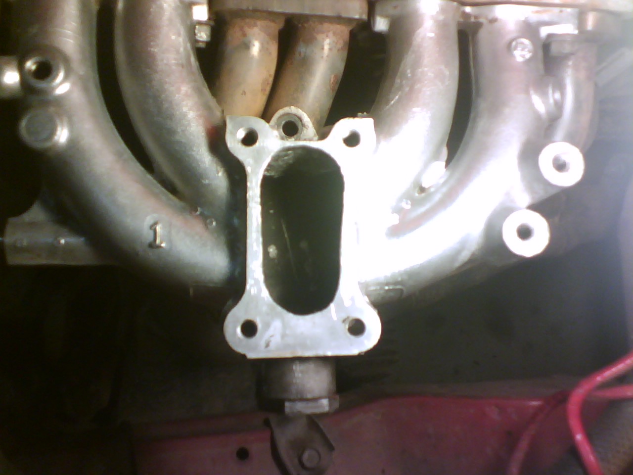

dunno about a k motor, but on my old gemini manifold it has the 2 holes... i got the bit in the middle taken out so the 2 holes are now one oval shape one.
Dunno if it made much difference, cause i got the manifolded ported to match head, and got some headwork done.. but i guess it could help a slight bit
yeah i have done this, not alot performance wise well noticeable, just the induction noise seemed louder so...... do it haha

no wasnt very noticable. lol have fun with the files.... i went and brought alluminium blades for the jigsaw and cut out the middle bit then brought some "special" alluminium tips for the end of the drill/die grinder and ground out the rest then got sand paper to make it nice and smooooth that alone took me 2 hours all up!

Would take care of that sort of thing in no time and gives you a bit of control over where/how much to remove.
Once you have the "meat" taken out of it, then hit it with a semi-round file, rat tail file for the corners you cannot get to, then some sand paper to knock any sharp points that are left.
Same principle that applies to match porting manifolds applies here.
