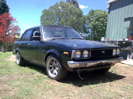

AEMoz Posted April 2, 2009 Report Share Posted April 2, 2009 i sprayed my wagon with cans of aussie export. Silver and matte black. Its no pro job but its half decent and has held up ok. Sand paper and paint all up would have been like $30. Matte colours work better long term. Gloss just tends to fade. Check out some of the pics on my profile. And see what u think Quote Link to comment Share on other sites More sharing options...

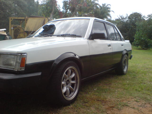

SLW42 Posted April 2, 2009 Report Share Posted April 2, 2009 i painted my rolla two tone using $7 supercheap auto enamel cans and it came up like a proper paint job but not as shiney Quote Link to comment Share on other sites More sharing options...
