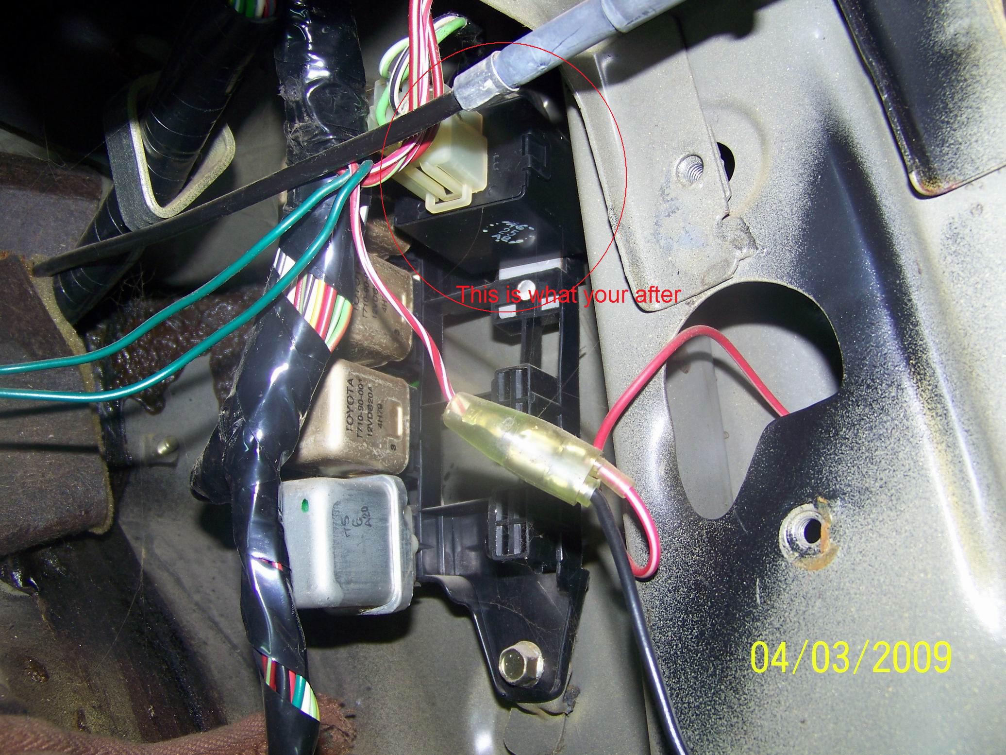

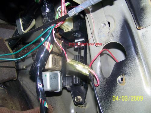

April 3, 200917 yr Author comment_333828 ok sussed it all out, found the flasher can for the hazards unplug it and the hazards stop, also found the one for indicators, now i am unsure as how to see weather it is this silly plastic thing that is the issue! this is the flasher can for the indicators yes? similar to the hazard one except the hazard one had all hella and toyota crap written on it. Report
April 3, 200917 yr comment_333864 If your hazards work it wont be the flasher can. could be the contact that is internal in the stalk broken or dislodged would take 2 minutes to swap it out and test with another if anyone willing to donate. just need a spare and no need to remove yours just unplug it and the two screws that hold it to the column. Hope this helps. Report
April 3, 200917 yr comment_333869 That should be the flasher can. They only have three wires hanging off it at the most. Located in the drivers kick panel. But anywho, what he said ^^^ And that relay... is an aftermarket job. If what your saying is that the blinkers stopped blinking after you disconnected it, it's more then likely the car once upon time had a tow hitch fitted and these relays were fitted to take the increased load off the flasher can Report
April 4, 200917 yr Author comment_334010 i replaced that circled flasher can, still nothing guess i am down to waiting to see if anyone is willing to lend me their combo switch to see if thats the issue as i don't need to waste more money on things that it isnt, stupid flasher can was like $26 =[ Report
